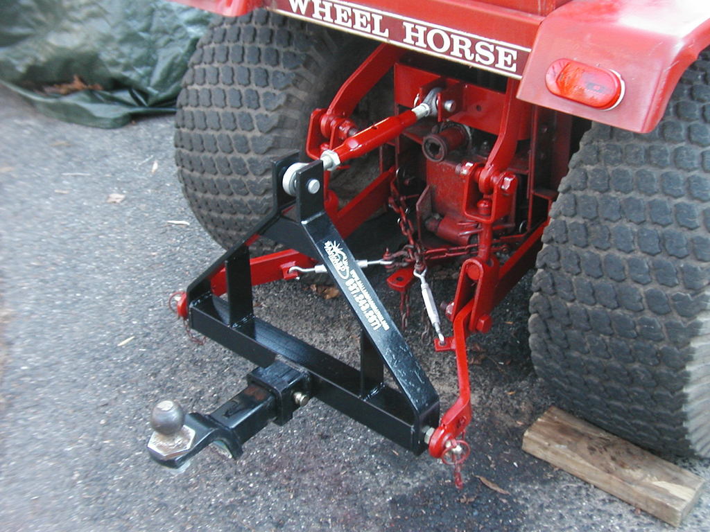

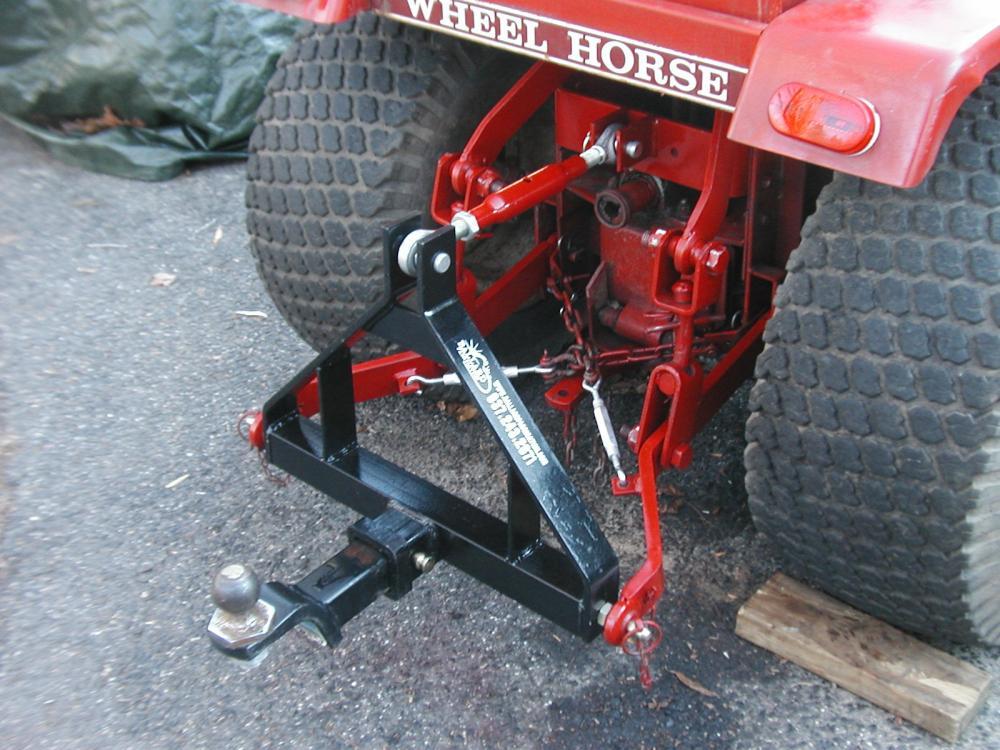

JackC 618 #17 Posted January 10, 2017 Here is pic of the three point hitch on the back of my D-160. The three points are pretty obvious. The adjustable unit at the top point is referred to as the top link. There is a hydraulic piston under the seat that moves the upper arms up or down by a lever on the dash panel. Wheel Horse used a category 0 three point hitch which refers to the size of the arms and pins. There is also category 1, 2, and 3 which are larger. Most small compact tractors have category 1. If you add attachments they need to be the same size category of the unit you have. Three point hitches were available on the larger tractors including the D Series, the C-195 and the GT14. Did I miss any? Some have cleverly installed them on others. The weight of the D-160 along with the set up in the pic makes for a very handy tow vehicle. Share this post Link to post Share on other sites
T-Mo-(Moderator) 4,753 #18 Posted January 10, 2017 9 hours ago, Ed Kennell said: Yes, if the large lift arm is not there, they should have a hyd lift. The hyd lift handle, that just operates the cylinder control valve, is smaller and usually on the same side as the lift arm. It may be on the side or back of the steering support tower or on the console, but it is usually positioned to be operated with the left hand. Just to add to Ed's post, there are some electric lift models that won't have the long lift arm on the left side. The 417-8 comes to mind, and there were others. These will probably have a toggle switch on the dash to operate the lift system. 9 hours ago, JackC said: Here is pic of the three point hitch on the back of my D-160. The three points are pretty obvious. The adjustable unit at the top point is referred to as the top link. There is a hydraulic piston under the seat that moves the upper arms up or down by a lever on the dash panel. Wheel Horse used a category 0 three point hitch which refers to the size of the arms and pins. There is also category 1, 2, and 3 which are larger. Most small compact tractors have category 1. If you add attachments they need to be the same size category of the unit you have. Three point hitches were available on the larger tractors including the D Series, the C-195 and the GT14. Did I miss any? Some have cleverly installed them on others. The weight of the D-160 along with the set up in the pic makes for a very handy tow vehicle. Thanks, Jack. There are some limited category 1 hitches now. John Deere has them on their X700 series and it's predecessors, the X4XX and X5X5 series from about 12 years ago. A category 0 is the most common for garden tractors and uses 5/8 inch diameter pins and has around 20 inches between the lower lift arms. A catergory 1 uses 3/4 inch diameter pins and has around 27 inches between the lower arms. There is an ISO (International Standard) for hitches. Here is the one for lawn and garden tractors. BTW, there is an ISO for sleeve hitches also. Also below is that one. ISO_Three_Point_Hitch.pdf ISO_One_Point_Tubular_Sleeve_Hitch.pdf 1 Share this post Link to post Share on other sites
