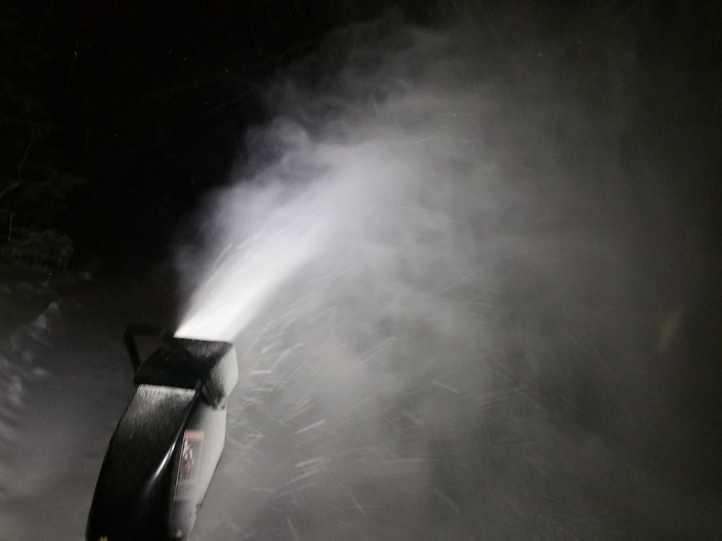

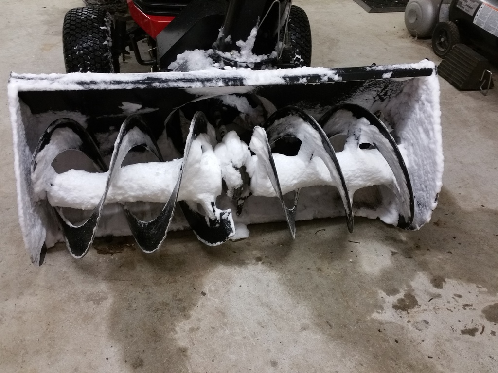

JERSEYHAWG / Glenn 4,589 #1 Posted January 8, 2017 (edited) Ok, I made a post this morning when I went out with my son Mike on his C-175. We had about 5 inches of snow, cold , fluffy. I wanted to try my xi and cab for a bit, the cab was great, the 2 stage was fine. I didn't run it long, coated it with snowblower jet beforehand. Ok, fast forward to this evening, another 5 inches or so, still bitter cold, snow wasn't heavy, engage snowthrower and head up the driveway. Oh, coated it with WD 40. Anyway ,the snowthrower performance was way low, didn't even meet the days performance level. When I got up to the county road, the snow was heavy from the salt and brine, maybe 8 ,, 9 ,, inches or better. When pushing through it, the tractor went to stall ,, the snow would barely piddle out the chute. Even creeping slower and going for half or one third the auger width. I was shocked, stunned, dumbfounded. My 520 with single stage, my 416-8 with single stage would go through that stuff at twice the depth and shoot it 15 feet or better. I was devastated, the xi 2 stage I searched for years ,, my big 522xi running like a top. Engine flat out screaming .. WTH .. What can be Wrong? I was ready to get my 416 out of storage and drag it home . But not yet. You guys might be able to give me a clue on this, I am stumped, sad, to say the least on this set up. Anyway, ideas on what to check are appreciated. I had higher hopes than what I was shown tonight on this piddly storm. Belt tension fine, chain greased, zerks greased. I mean there are no hours on this thing. Help and ideas sought. Winter just started. Thanks fellas, Glenn Edited January 8, 2017 by JERSEYHAWG / Glenn Share this post Link to post Share on other sites

Sarge 3,473 #6 Posted January 8, 2017 It's either the sun heating the snow and making it wetter than it appears , which happens quite often - or something in the drive system is not running that blower at full rpm as it should be .... It's really tough to diagnose a slipping clutch or belt since they will only slip under a hard load - I've had someone else in the past run the tractor while I walk along side of it to watch shafts/belts/clutch disk and such ..it helps. Sarge 2 Share this post Link to post Share on other sites

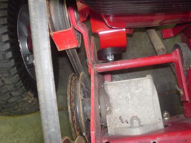

JERSEYHAWG / Glenn 4,589 #8 Posted January 8, 2017 (edited) .Jeff, yes, after intal set up the auger gearbox was checked, it was fine. That other gearbox isnt on this model. there is a pulley box underneath. Sarge / Jim, re wet / heavy. yes a bit I would say. But this machine should have eaten it up like my other single stage units. And it was evening fallen snow. Dave, adjustment seems fine. This is a low hour unit, always babied, 268 hours as we speak. Belt seems good as does chain and tensions on everything. ( electric clutch ) Thank you all for the replies, as I search further will let you know. Edit: nightshot of snow plume...also, when finished. noticed snow packed in chute sticking,,yes, but all my units do this. ??????. Glenn Edited January 8, 2017 by JERSEYHAWG / Glenn Share this post Link to post Share on other sites
doc724 927 #9 Posted January 8, 2017 Glenn, I only have a single stage on my 520xi, but I can offer the following observations: My blower has the solid baffle on the lower past of the chute while yours has the "W" wire if I read the pix correctly. The solid baffle will allow the snow to shoot further but it can also plug solid. Based on your descriptions, the second "outing" may have had snow with a higher water content which may have blocked the outlet. My other observation is that on two stage machines, the impeller is responsible for discharging the snow and the auger just gets it to the impeller. Unlike a single stage where the high rpm auger does both. Places I would check are: Is belt the correct length (there is likely no clutch slippage as it is electric and not adjustable as far as I know)? Is the impeller moving as it should? i can imagine how disappointed you are, but I think the root cause is likely simple. I think the weather will warm up mid week which should allow for trouble shooting 1 Share this post Link to post Share on other sites

Kurt-NEPA 756 #11 Posted January 8, 2017 Sorry to hear about your problems Glenn. That blower should be a beast. Have you checked your belt tension. If I recall, the path of that belt is torturous, it changes direction twice. If that belt started slipping it would cause your problem. Just my 2 cents worth. 2 Share this post Link to post Share on other sites

1995 520H+96+97 939 #20 Posted January 9, 2017 (edited) Looks like the left(when seated) auger is not turning in the second picture. Edited January 9, 2017 by 1995 520H+96+97 spell 1 Share this post Link to post Share on other sites

WNYPCRepair 1,924 #23 Posted February 28, 2017 I can't really help much, as I haven't had enough snow the last 2 years to really use my 2 stage. The one day I did get to use it, the belt broke. I do remember there is a rod that fits in a keyhole slot on the right side of the frame to keep the pulley box in place. If that isn't in place it would probably let the pulley box move and lower belt tension Other than that I don't really have any ideas Share this post Link to post Share on other sites
