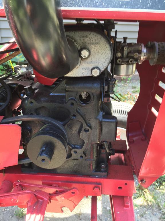

Jjf02914 3 #1 Posted January 8, 2017 (edited) I cant figure out what this plug on the side of my engine is called so i can get one,it almost looks like it could be a freeze plug and running it withput it the engine spits oil outa this hole wich is about 7/8 round ill see if i have a picture in phone,any help is appreciated the engine is on my 63 wheelhorse thank you its a model k141t kohler Edited January 8, 2017 by Jjf02914 More info 1 Share this post Link to post Share on other sites
gwest_ca-(File Mod) 12,145 #3 Posted January 8, 2017 Can't find a parts list for the K141. Here is a plug from the K161 and appears to be about 1-1/8" OD. https://www.partstree.com/parts/kohler-engines/parts/x-230-11-s/ Garry 2 Share this post Link to post Share on other sites
Shynon 7,545 #4 Posted January 8, 2017 12 minutes ago, ol550 said: Welch plug 1 Share this post Link to post Share on other sites
Jjf02914 3 #5 Posted January 8, 2017 Thankyou welch plug ok happy new year 2 Share this post Link to post Share on other sites
