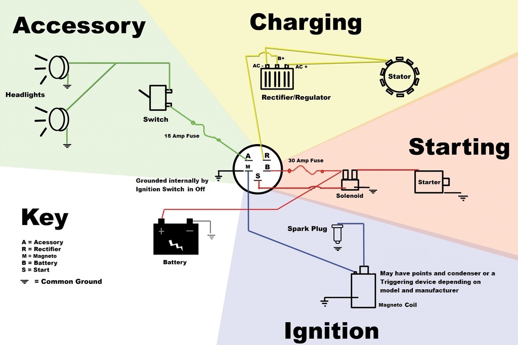

Jesse1980 1 #1 Posted January 7, 2017 Hi everyone. I recently put a 16hp motor in one of my old girls, a 79. The motor runs great but only when the switch is in the off position. Any suggestions would be greatly appreciated! Share this post Link to post Share on other sites
KC9KAS 4,746 #2 Posted January 7, 2017 TO We will need additional information...What tractor, what engine was in it originally? Probably the wrong ignition switch due to the engine swap. Share this post Link to post Share on other sites
Achto 32,262 #3 Posted January 7, 2017 46 minutes ago, Jesse1980 said: I have a tractor that only runs when key is on off position, any suggestions? It sounds to me like you may either have the wrong ignition switch or that your switch is wired wrong. My first question would be, do you have a magneto ignition or an automotive style coil with points. Share this post Link to post Share on other sites
953 nut 68,179 #4 Posted January 8, 2017 Presuming you have a Magneto ignition system your ignition switch may not be grounded and the seat or PTO safety switches are not right. Was this a battery ignition prior to the switch over and now a Mag; or visa-versa. Take a look at these basic ignition diagrams and see what may not be correct. 3 Share this post Link to post Share on other sites

Jesse1980 1 #8 Posted January 8, 2017 Thanks for the diagram, after viewing it looks like I do have the wrong switch. Thank you so much for your help! 1 Share this post Link to post Share on other sites
