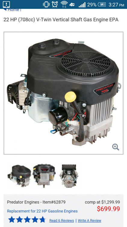

WVHillbilly520H 10,378 #4 Posted January 6, 2017 Just a thought the Predator 22 hp V-twin now comes in a vertical shaft version(actually more CC's) as well as the horizontal,Jeff. 1 Share this post Link to post Share on other sites
Docwheelhorse 2,929 #5 Posted January 6, 2017 1 hour ago, WVHillbilly520H said: Just a thought the Predator 22 hp V-twin now comes in a vertical shaft version(actually more CC's) as well as the horizontal,Jeff. Saw this motor ... cool idea, decent price but too much $$$ for this particular tractor. $750 after tax puts the GT5000 in the totaled category. Im trying to figure out if a 12--18 hp single would just bolt up if the crank dimensions where right. Those motors can be had in the $150+ range running. Tony Share this post Link to post Share on other sites

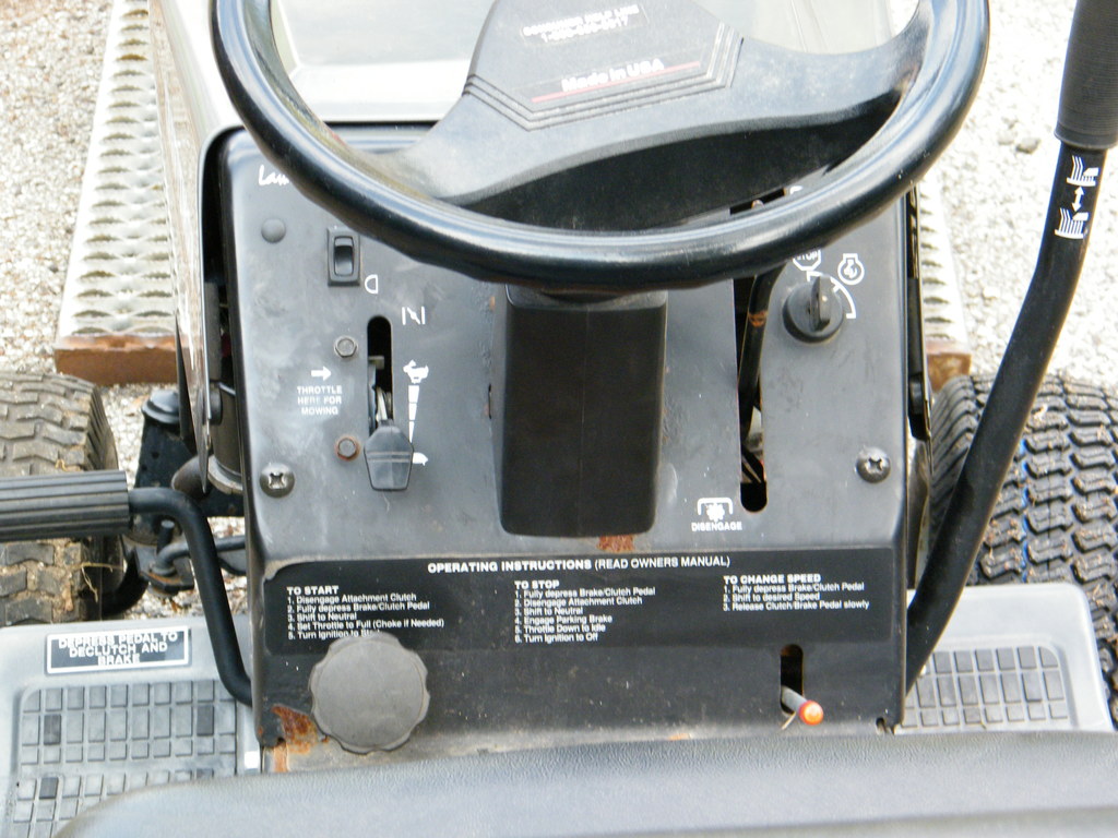

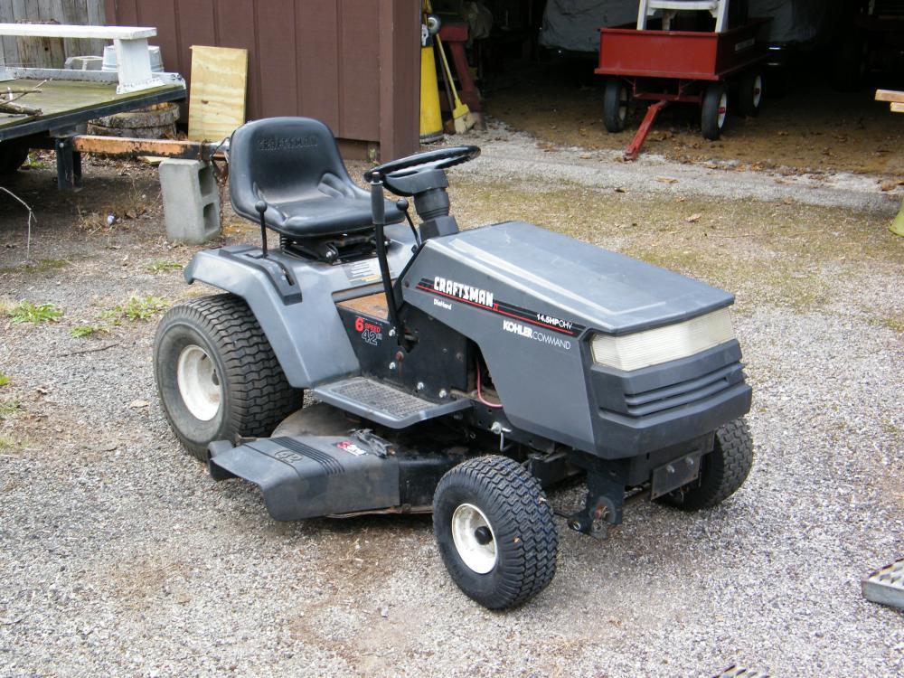

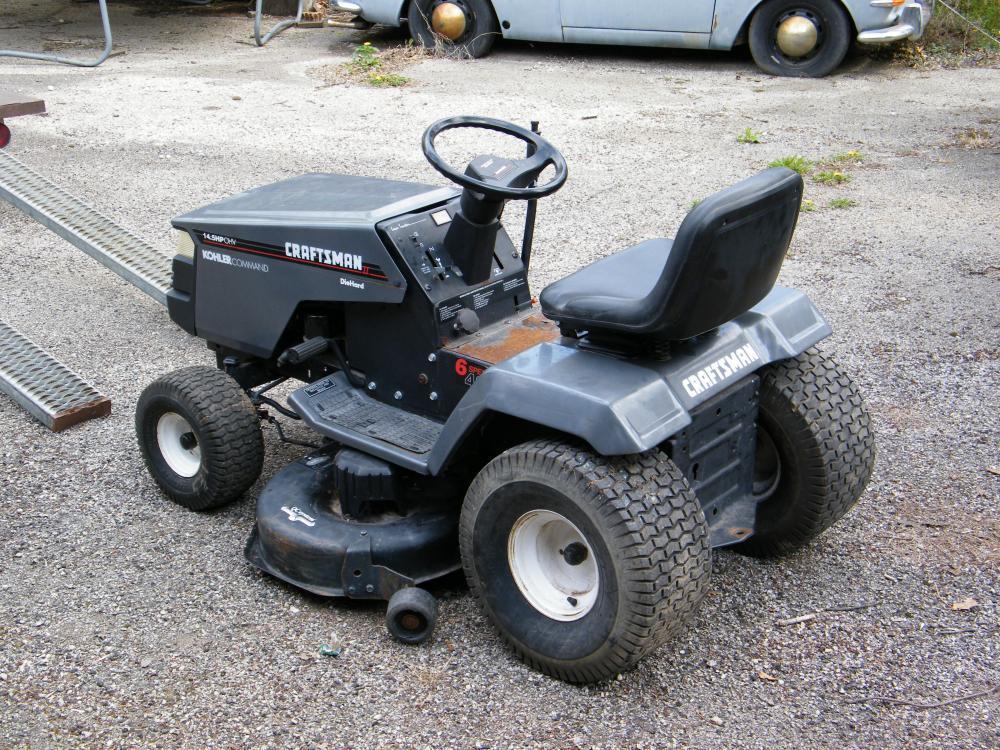

stevasaurus 23,689 #8 Posted January 10, 2017 (edited) Tony, I happen to have this if you like. The transmission, a Pearless 6 sp has a broken casting. This is a 1995 Craftsman model #917.252540. it has a 14.5 hp Kohler...vertical shaft. This has been sitting about 3 years, but I had it running then and it ran good. It was a friend of mine's and he has just passed away this last year. Edited January 10, 2017 by stevasaurus Share this post Link to post Share on other sites
