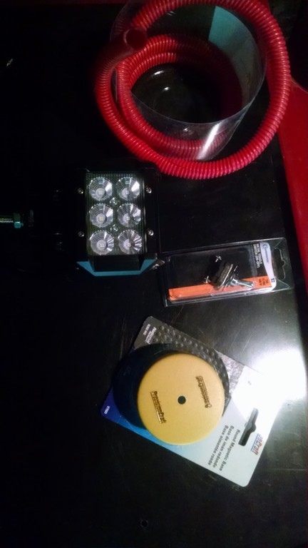

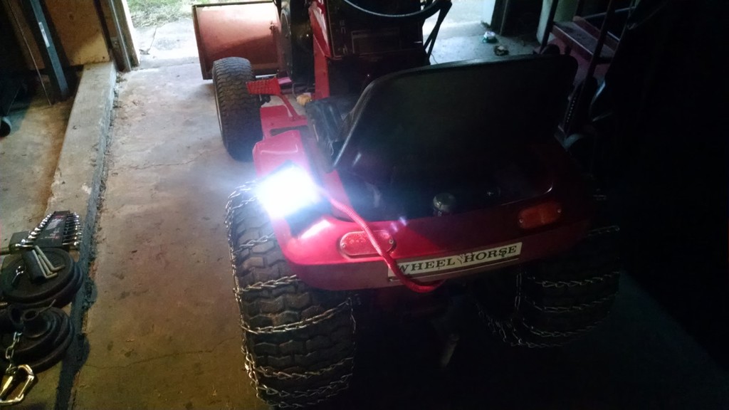

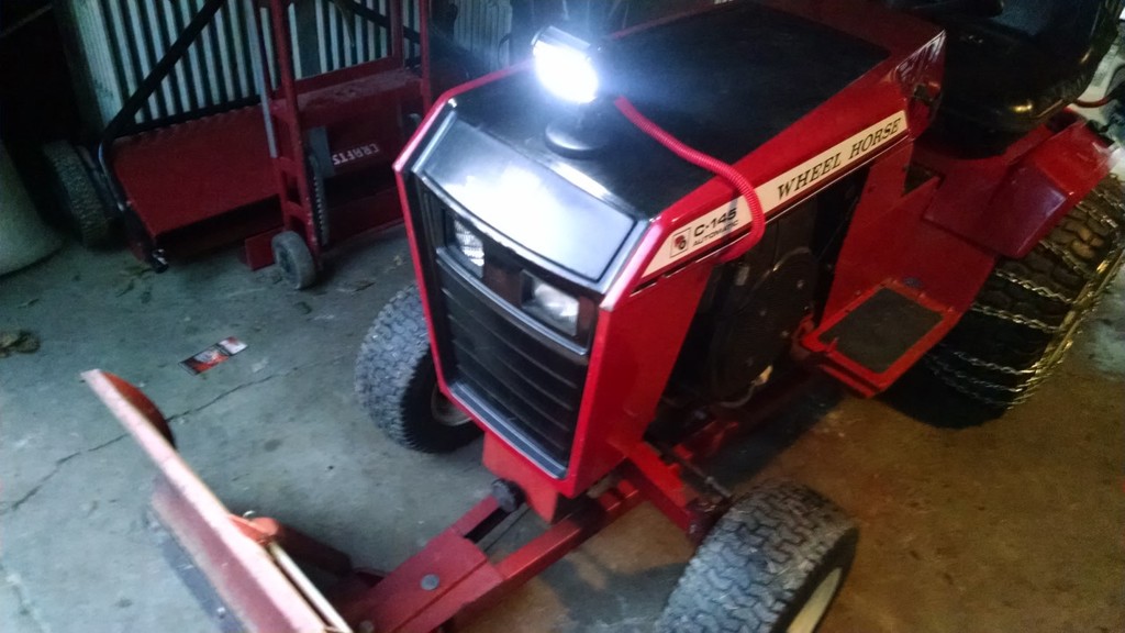

plumb-r 34 #1 Posted January 4, 2017 I just finished adding some LED lights. I installed one front, one rear. I got the pair of lights off E-bay for $15. I mounted them with large magnets from TSC and wired them with connectors so they can easily be removed in the summer.I think the single light on the hood puts out more light than the stock head lamps. 15 Share this post Link to post Share on other sites

JoeM 10,318 #3 Posted January 4, 2017 Tip. use a piece of cloth between the magnet and paint. keeps the scratches down. I mounted a winch switch on a magnet and it still sticks pretty well. I like the light idea. Just might copy. 5 Share this post Link to post Share on other sites
