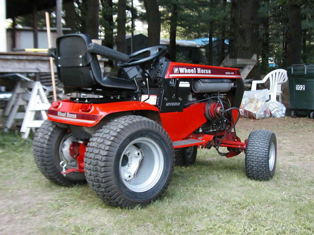

JackC 619 #17 Posted January 4, 2017 (edited) It is a 1989 520HC painted grey with new decals. It is an 89 due to the round knob on the shift lever. 88 had a different knob. I have both years. Wheel Horse did have grey tractors such as the 1848 with the Briggs Twin and some really liked that color. The HC was the commercial model and absolutely the fastest 520 made at about 7.5 mph. It first came out in 1988 and was the first and the Grandfather of the 520 Series. They went with Onan power plants instead of Kohler due to more torque at lower RPM to spin the 60 inch decks that fit under the swept front axle. Pardon me but a regular 520 is a dog by comparison. Disclosure: I am biased and I love my 520HCs. Here is how it is supposed to look: Edited January 4, 2017 by JackC 1 Share this post Link to post Share on other sites
