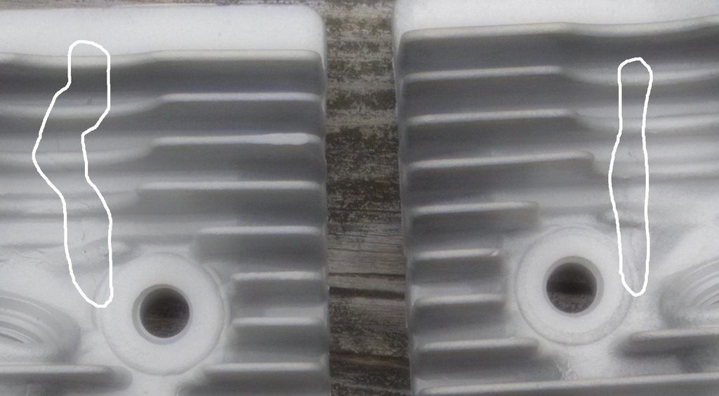

Razkid 69 #1 Posted January 2, 2017 After removing and cleaning the heads I've noticed what looks like either casting flash or cracks in both heads. Trying to be optimistic, I say they are flash but a friend thinks they are cracks. There is no sign of them on the other side of the heads so if they are cracks, they don't go all the way through. Has anyone else seen these on an Onan 20HP head? DSCN1145[1].MOV Share this post Link to post Share on other sites
boomers_influence 106 #2 Posted January 2, 2017 raz if you list a 170-xxxx cast # i will look at some of mine. thank you. boomer 1 Share this post Link to post Share on other sites
Razkid 69 #3 Posted January 2, 2017 Thanks Boomer. They are 4097E and 4098E Share this post Link to post Share on other sites
MalMac 1,336 #4 Posted January 3, 2017 (edited) Not a expert here, but they look some what like flow lines when the heads were poured from molten aluminum. Edited January 3, 2017 by MalMac 1 Share this post Link to post Share on other sites
Ed Kennell 46,207 #5 Posted January 3, 2017 Any machine shop should be able to do a dye check for a couple$. 2 Share this post Link to post Share on other sites
Razkid 69 #6 Posted January 5, 2017 On 1/2/2017 at 7:08 PM, MalMac said: Not a expert here, but they look some what like flow lines when the heads were poured from molten aluminum. That's what I am hoping! I don't have a machine shop nearby so I hope Boomer finds the marks on some of the heads he is going to check. Share this post Link to post Share on other sites
MalMac 1,336 #7 Posted January 5, 2017 In case the worst and you have to replace them, they do show up on eBay from time to time. Share this post Link to post Share on other sites
boomers_influence 106 #8 Posted January 5, 2017 raz i only have 1 pair of the E heads. no hair lines shown. i have many other A B C etc and some do show the lines. i WOULD not worry about it. thank you. boomer 2 Share this post Link to post Share on other sites
Razkid 69 #9 Posted January 6, 2017 Thanks for your time and effort Boomer! 22 hours ago, MalMac said: In case the worst and you have to replace them, they do show up on eBay from time to time. I had found several pairs for sale on Ebay and A-Z Tractors also has some. Thanks. Share this post Link to post Share on other sites
