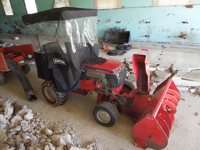

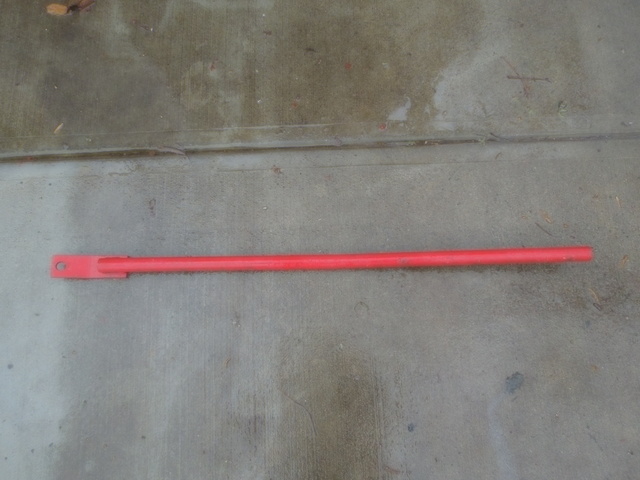

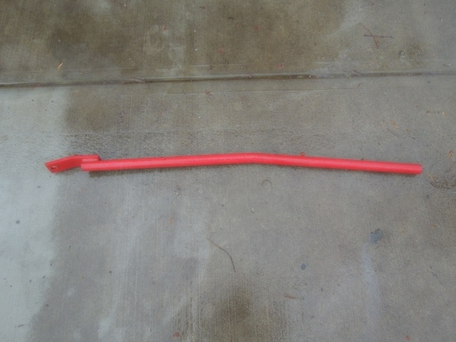

Razkid 69 #1 Posted December 29, 2016 This was dropped off to me by the 520-H's previous owners friend. I asked him to go through the shed and garage to see if there were any other things painted red that might go with the tractor. It's about 4' long and heavy. Is this something Wheel Horse? He also found the missing pulley cover that goes on the mower deck and one tiller blade. Never hurts to ask! 3 Share this post Link to post Share on other sites
rjg854 13,422 #2 Posted December 29, 2016 It's the bar that raises a snowthrower 7 Share this post Link to post Share on other sites
roadapples 6,987 #3 Posted December 29, 2016 5 minutes ago, Ranger13148 said: It's the bar that raises a snowthrower Yup, that`s it..... 1 Share this post Link to post Share on other sites
Razkid 69 #4 Posted December 29, 2016 (edited) Do you mean to manually lift the snowthrower? I don't see anything like it in the 06-44SC01 parts list. Does it go onto some other model of snowthrower? Edited December 29, 2016 by Razkid 1 Share this post Link to post Share on other sites
roadapples 6,987 #5 Posted December 29, 2016 Yes.. 1 Share this post Link to post Share on other sites
GlenPettit 1,719 #6 Posted December 29, 2016 (edited) Yes (and no), there's a big mechanical advantage ––– you're using the large lever on the left plus a strong 'helper spring' (and a 'flag') underneath, so just your left arm while sitting can raise the snowblower easily. Ask him to keep searching and keep a big eye open –– it's those little small parts that are often left behind that have become so valuable and hard to find, and even harder to reproduce, like the small 'flag' and 'Spring', etc. Edited December 29, 2016 by GlenPettit 4 Share this post Link to post Share on other sites
roadapples 6,987 #7 Posted December 29, 2016 Can`t see it in that picture, it`s underneath the tractor.. 1 Share this post Link to post Share on other sites

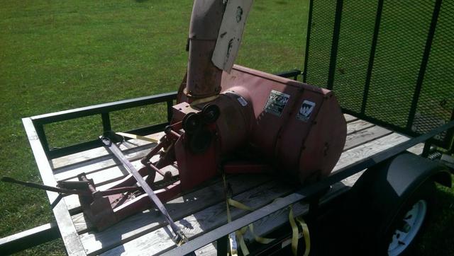

WVHillbilly520H 10,379 #8 Posted December 29, 2016 NO , not for the 2stage but for a single stage, as you can tell there's a cradle/frame and scissors type lift linkage with a smaller lift arm on the 2stage, on the single it's frame latches into the front attac-a-matic then that big pole attaches to the bottom of the auger housing/frame then under the tractor to the rock shaft,Jeff. 6 Share this post Link to post Share on other sites
Razkid 69 #9 Posted December 29, 2016 Thanks to all for the replies and to Jeff for clarifying it to me! I'll have to ask if another tractor that the previous owner owned had a single stage on it. It might go on the tractor that the person who brought it to me now owns! 5 Share this post Link to post Share on other sites
