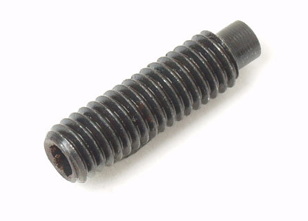

Marv 996 #1 Posted December 29, 2016 I need a gear shifter set screw for a C series. I am referring to the one that holds the shifter to the transmission. Anybody have one they don't need? Thanks Marvin Share this post Link to post Share on other sites
Irv 115 #2 Posted December 29, 2016 (edited) It's called the "dog point" set screw-part #1239. You can grind down a regular screw to make one if you can't fine one. Jack"s small engines has them or maybe your local toro dealer. Edited December 29, 2016 by Irv correction 2 Share this post Link to post Share on other sites
bowtieguy 334 #3 Posted December 29, 2016 Or go to McMaster-Carr and buy a box of 25.....I like the design better than the Toro product. Share this post Link to post Share on other sites
Racinbob 13,054 #4 Posted December 29, 2016 Marvin, PM your address to me, 4 Share this post Link to post Share on other sites
gwest_ca-(File Mod) 12,385 #5 Posted December 29, 2016 Somewhere in the parts lists the 1239 screw is listed as a 1/4-20 x 3/4" dog-point setscrew Garry 3 Share this post Link to post Share on other sites
