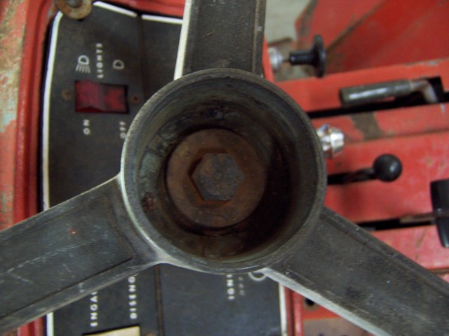

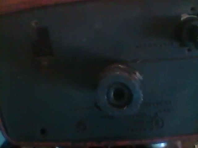

mikehusky455 16 #1 Posted December 25, 2016 first off merry xmas everyone. on my 69 wh gt14,need to know if the steering wheel is splined 36teeth.with a roll pin.when I got tractor only the collar of the steering wheel was on there ,all beat up and rusted so I need to cut it off and get one ,but just need to know if its splined thanks.it does also have a spot where wheel would be bolted down .pic is with my laptop so may not show up good.the little tabs sticking out are not the pin its part of steering wheel 1 Share this post Link to post Share on other sites

refracman 167 #4 Posted December 25, 2016 The GT14 steering is not splined. It has a standard 3/4 round with a key. The only Wh's with a splined shaft have a Ross steering assembly which are the early 953 and d 160,180 and 200 2 Share this post Link to post Share on other sites
mikehusky455 16 #5 Posted December 25, 2016 i cant tell yet if its splined but it def.has a pin through it and had bolt on top,no keyway. I did just check the parts list and shows it should be a keyway style,so someone must of changed it at sometime.,cause it deff. has a pin through it. Share this post Link to post Share on other sites

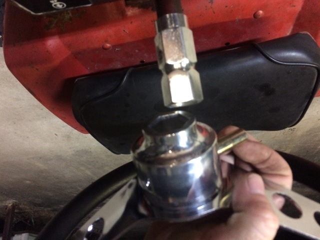

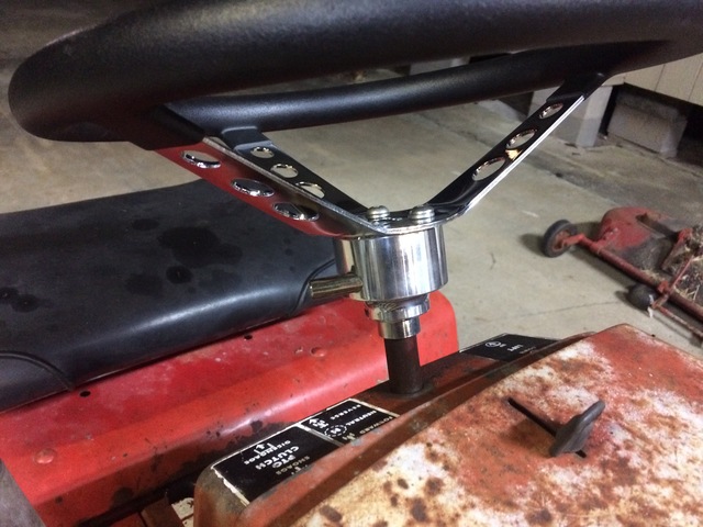

Hacksawhero123 351 #13 Posted December 28, 2016 I've got about $60 in my wheel setup. A steering quick connect for a dune buggy and a grant GT wheel. Both from Amazon. Only modification wash drilling a hole for the pin. Mark. 3 Share this post Link to post Share on other sites
mikehusky455 16 #14 Posted December 28, 2016 how much smaller diameter is your new wheel compared to original.,i have a lot of reg.riding mower wheels but they seem like it would steer that great,and are smaller.,nice set up though Share this post Link to post Share on other sites
Hacksawhero123 351 #15 Posted January 1, 2017 Mike, I haven't checked diameters. I have the old wheel in the scrap pile. I'll dig it out shortly and let you know. I will say that my C160 steers easily for a heavier machine. Mark. Share this post Link to post Share on other sites
