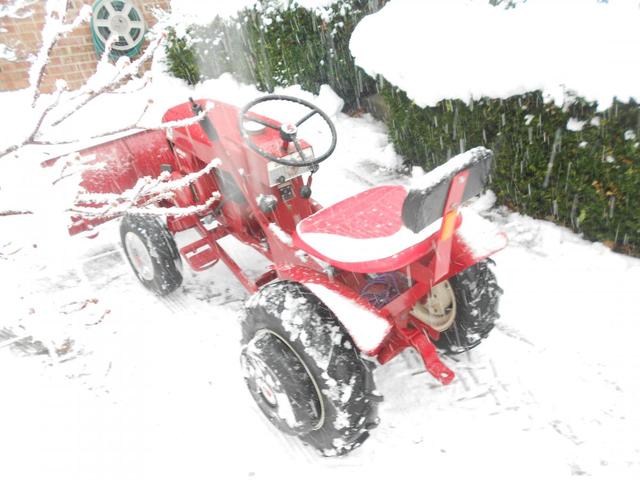

Lane Ranger 12,151 #3 Posted December 25, 2016 (edited) Right up the sidewalk and left and right in front of the garage door ! I keep my door open when plowing just in case the operator hits a foul ball ! I ususally use my B-80 but this was a couple winters ago with my brotehrs 633 and a 1962 snowplow. Here is a You Tube posted video from 2014 using this tractor and plow: Edited December 25, 2016 by Lane Ranger 7 Share this post Link to post Share on other sites
