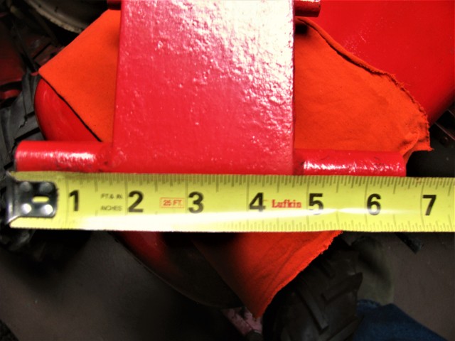

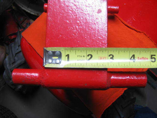

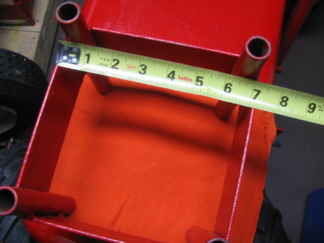

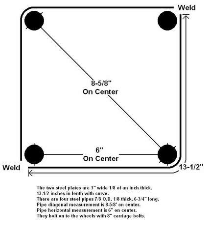

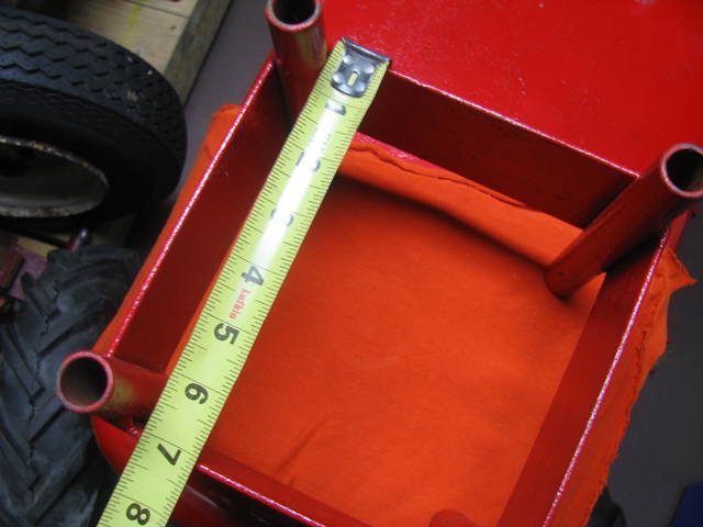

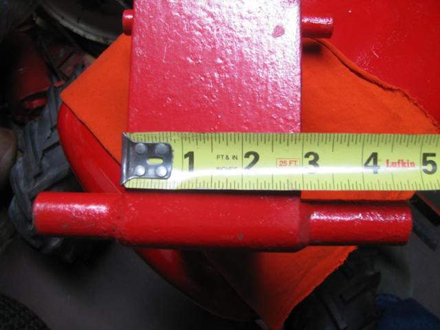

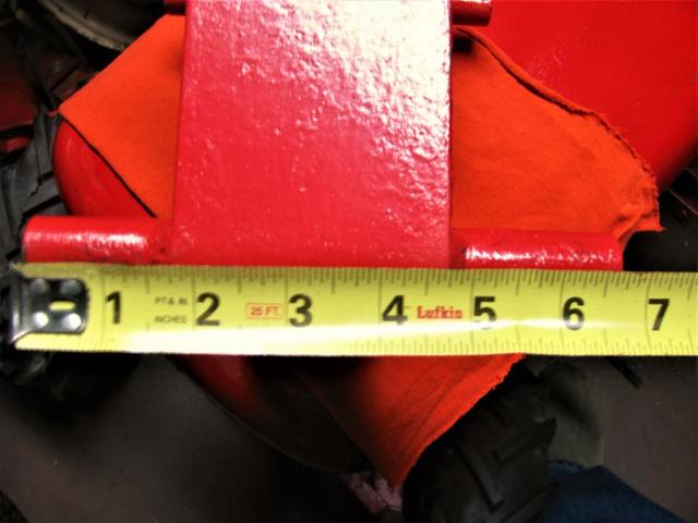

Rp.wh 1,103 #1 Posted December 23, 2016 Looking for some dimensions of wheel spacer for a 401 I am looking to build my own. Thanks Share this post Link to post Share on other sites
AMC RULES 37,220 #2 Posted December 24, 2016 For reference... a set of factory original 6-12 spacers here. 3 Share this post Link to post Share on other sites
Shynon 7,484 #4 Posted December 24, 2016 1 hour ago, Rp.wh said: Looking for some dimensions of wheel spacer for a 401 I am looking to build my own. Thanks I think @WHX9could help with this, he has a set on Cindy's 702 1 Share this post Link to post Share on other sites
WHX?? 52,033 #5 Posted December 24, 2016 (edited) Already asked me Tom....he's at work and SUPPOSED to be WORKING but is bored...... and it's too dang cold to go out and measure! Now you guys are adding to his delinquency ! BTW AMC......looks like quite the mumbo jumbo of tires ya got there!?!?! Edited December 24, 2016 by WHX9 Add Share this post Link to post Share on other sites
Rp.wh 1,103 #6 Posted December 24, 2016 Ohhh come on now.. we have everything done that needs to be, time for a work xmas present thanks for the pictures one dual wheel set coming up but first have to see if I have the right material! 1 Share this post Link to post Share on other sites

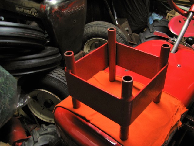

Rp.wh 1,103 #11 Posted December 24, 2016 Yeah Yeah Yeah definitely screwed the suburban name up I was in a hurry and on my phone. But I got them all made in about a hour and a half all cleaned up ready for paint now. Will post some pictures tomorrow pretty simple design. 1 Share this post Link to post Share on other sites
