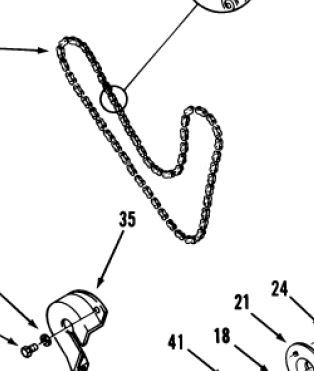

dirtnap 39 #1 Posted December 23, 2016 I got my 42" 79362 snowblower second hand. I noticed that the idler sprockets were bad so I replaced both of those and figured that I'd do the chain at the same time. Bought a length of #40 chain, counted the links and cut myself a new one. The new one was about one link's length shorter that what was on there. Perfect, that should take care of the slapping I had with the original. So I put the new one on but still have chain slap and the chain rubs at the top opening of the housing where it comes out. I have the operators manual but it doesn't show the proper chain routing. I'm thinking I have it on wrong but it appears there's only one way it goes on one way. Can anyone shed any light on this issue? Perhaps a routing diagram or proper chain length for this blower? Something doesn't look right and I think the previous owner may have had it on wrong. Thanks a lot. Share this post Link to post Share on other sites
pfrederi 21,056 #2 Posted December 23, 2016 from the rive sprocket down under the auger sprocket then up to the top idler straight dowN and around the lower idler and back to the drive sprocket. The lower idler is in a slot and can be moved if you loosen the 3/4" nut to tighten the chain 3 Share this post Link to post Share on other sites

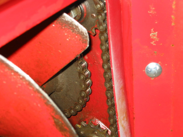

WHX?? 57,811 #3 Posted December 23, 2016 I had the same problem Dirt... I think I even had to take an extra link out if I remember right. Check the drive sprocket as my was hooked real bad .. got a replacement from Motion. Should look like this when on. I also had mine on wrong too so check that before taking any more links out. 2 Share this post Link to post Share on other sites
