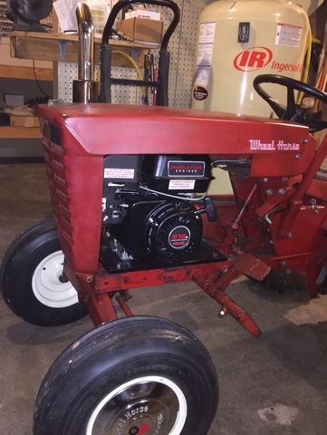

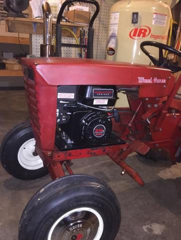

Team70R 157 #12 Posted December 25, 2016 I just finished a predator 6.5hp swap on my 606 and couldn't be happier!! Puts the poor old tecumseh to shame! Share this post Link to post Share on other sites
cschannuth 3,819 #13 Posted December 25, 2016 I have a 606 roller and did the same. It runs strong. Plus I upsized the engine pulley by an inch and it runs a little over 8 mph at w.o.t. Rolling along at 1/2 to 2/3 throttle it's running 6 mph. Made it a great tow/chore tractor. I would never replace a good Kohler or Briggs with the Predator but if you need a cheap engine it seems to be a good choice. 3 Share this post Link to post Share on other sites
