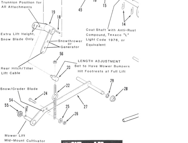

953 nut 64,172 #7 Posted December 20, 2016 The Rocker Shaft has several holes in it, move the chain or link that lifts the plow out to the furthest hole, lift it a little at a time to be sure it isn't going to bind on the front axle. See page 5 of this manual. 2 Share this post Link to post Share on other sites

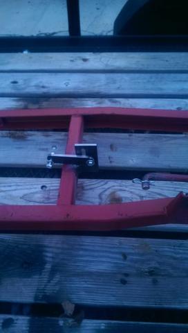

520hC-120 136 #10 Posted December 21, 2016 Thanks Here are some pics for you all to see 1 Share this post Link to post Share on other sites
gwest_ca-(File Mod) 12,007 #11 Posted December 21, 2016 I think you are lifting by the wrong arm on the rock shaft. Garry 3 Share this post Link to post Share on other sites
953 nut 64,172 #12 Posted December 21, 2016 The chain should be going straight up, not at an angle. 2 Share this post Link to post Share on other sites
1995 520H+96+97 939 #13 Posted December 21, 2016 Not supposed to be lifting from two(2) points. 1 Share this post Link to post Share on other sites
