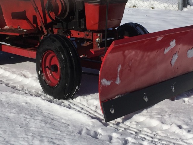

GlenPettit 1,719 #10 Posted December 16, 2016 (edited) After last year and four-time already this year (3 hours each time), only minor wear (5%) on the one edge of this nylon blade ($20): (I'm sold on this for an asphalt drive, quite, very easy to drill, very little wear –– have not used on gravel directly, edge was run high). (at this rate, the two edges may last 10 years: in the pix you see a 20# lead bar temporally hanging on the mule mount, both the front and rear tires have Rim-Guard fluid inside, the weight and tri-rib tires greatly help control steering, blade has 2 upright corner markers, Silicone on blade face). Edited December 16, 2016 by GlenPettit 4 Share this post Link to post Share on other sites
