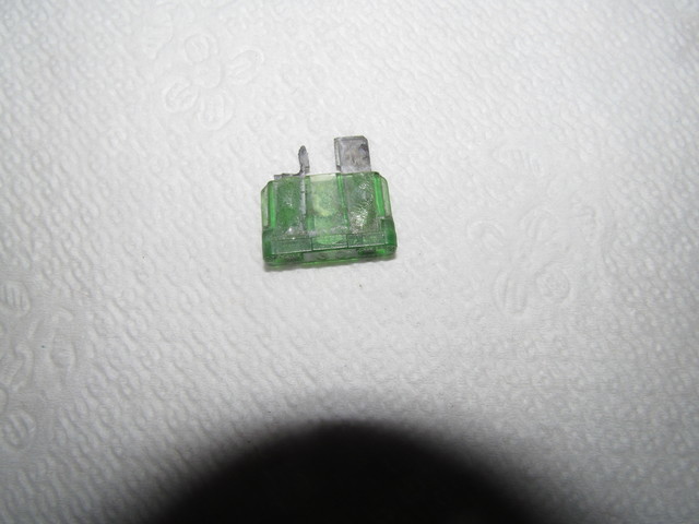

Ed Kennell 46,477 #14 Posted December 27, 2016 Here is why my 520 quit charging. 30A fuse at front of engine. 1 Share this post Link to post Share on other sites
Dball 12 #15 Posted December 28, 2016 Tryed replacing fuses nothing changed so far way it reads is on a cont test it shouldnt ring out which it didnt so the rectifier was replaced im un sure of what it could be their was a few niks in the copper windings but none of them was cut in half Share this post Link to post Share on other sites

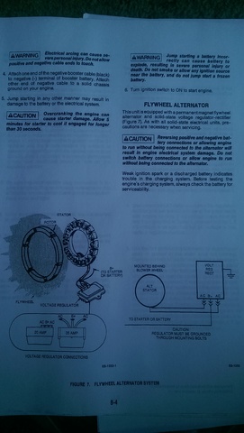

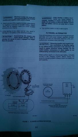

gwest_ca-(File Mod) 12,325 #19 Posted January 3, 2017 Here is the 1988-89 wiring diagram showing the fuses. The charging system on these models have a 20 amp rating and the fuse used between the regulator and the battery is 30 amp. Garry Share this post Link to post Share on other sites
