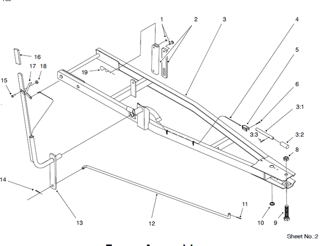

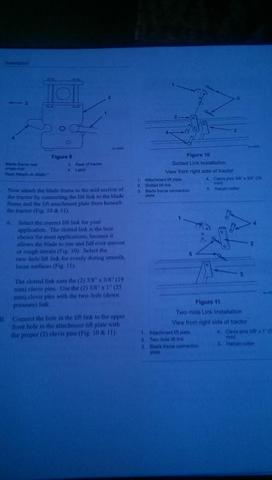

bmsgaffer 2,069 #1 Posted December 14, 2016 There are two part numbers listed for the XI lift link. One is about $40 from toro and the other is about $60 and has a two week backorder. One is solid and one is floating, anyone have any idea which is which? Both are listed for item 2. 94–7793–03 1 Link–Lift 94–7987–03 1 Link–Lift Thanks everyone! Share this post Link to post Share on other sites

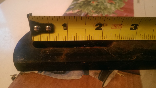

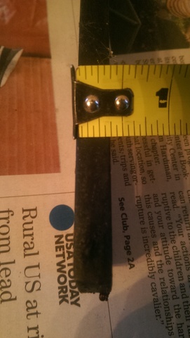

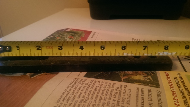

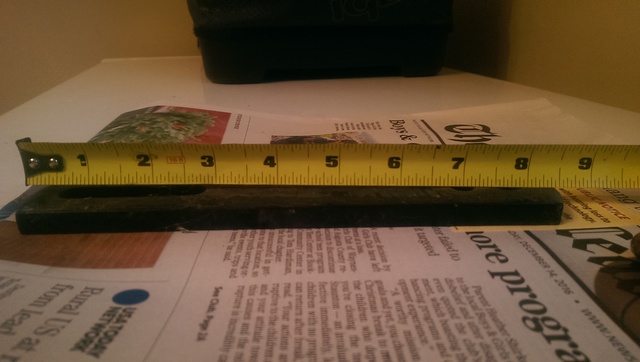

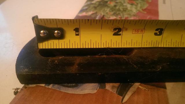

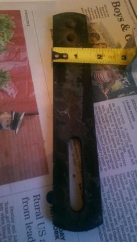

WVHillbilly520H 10,378 #4 Posted December 14, 2016 @bmsgaffer,Here maybe this will help make you one a lil cheaper...3/8" thick flat bar by 1.5" wide by 8.5" long...7" from slot end to pin hole end...7/16" wide slot by 2.5" ...pin holes are slip fit 3/8" diameter...near end slot to first pin hole 4"...pin holes 3/4" on center...good luck Jeff. 1 Share this post Link to post Share on other sites
shallowwatersailor 3,220 #5 Posted December 15, 2016 The 94–7987–03 is the solid link and more expensive. It is a formed piece (as in the drawing) which is why the cost is higher. The floating link is more useful. 2 Share this post Link to post Share on other sites
bmsgaffer 2,069 #6 Posted January 19, 2017 (edited) I realized that I never got to thank you all for your help. Also, Jeff: That second (lower) hole in the lift link was not factory but I think it was added to get a bit extra lift on the blade and it is a worthy addition! @wheelhorseman1000 Lowell now carries the floating link with the stock upper hole, but I have tagged him here to consider adding the second hole for more lift. Edited January 19, 2017 by bmsgaffer 1 Share this post Link to post Share on other sites
