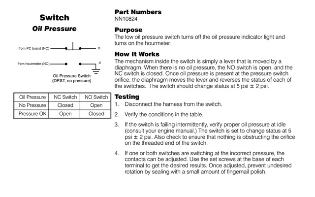

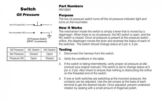

gwest_ca-(File Mod) 12,489 #4 Posted December 13, 2016 This is for the NN10824 oil pressure switch used on some of the Onan engines. 5 Share this post Link to post Share on other sites
