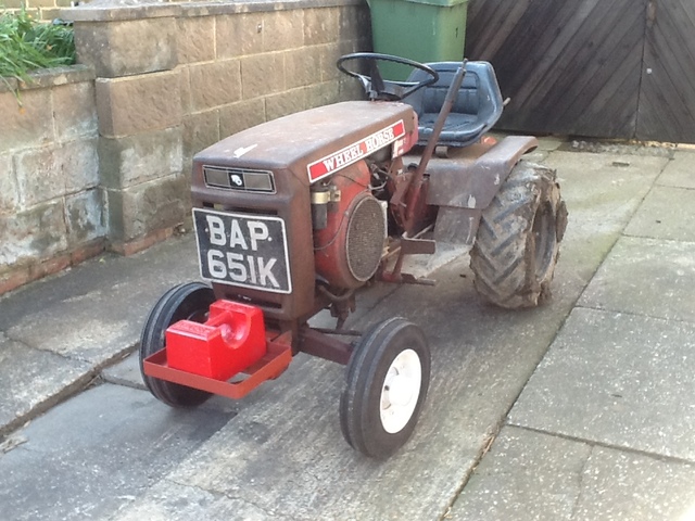

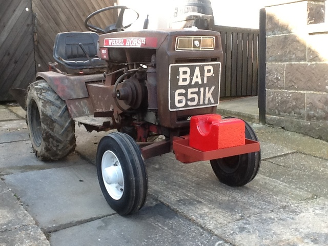

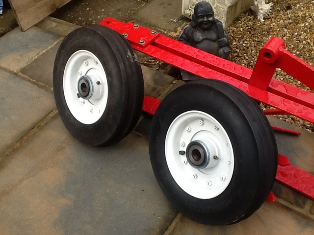

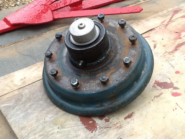

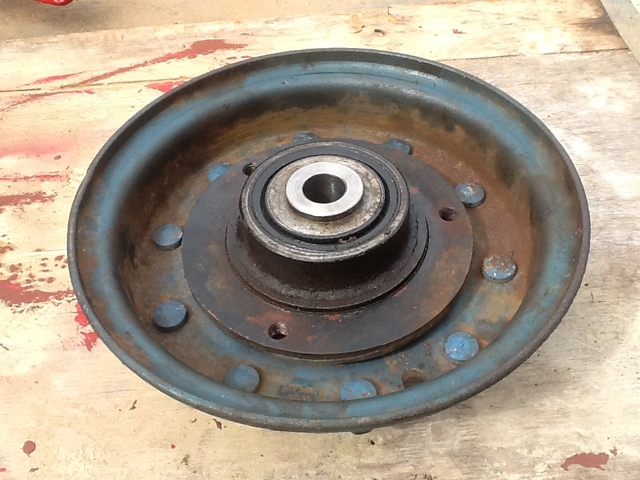

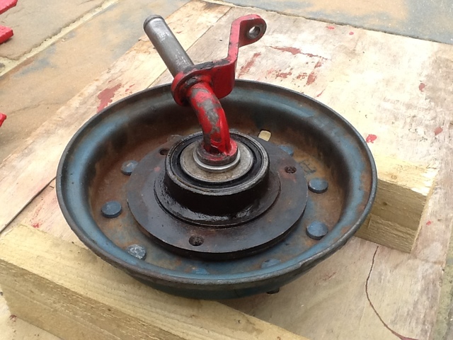

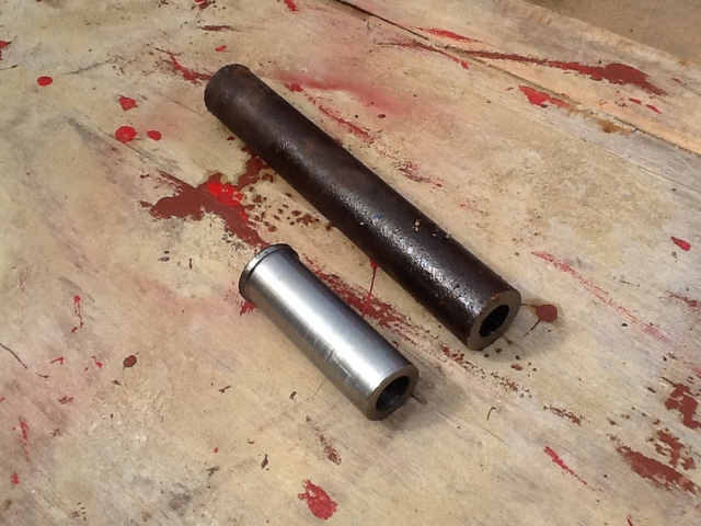

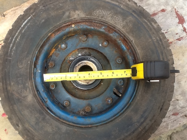

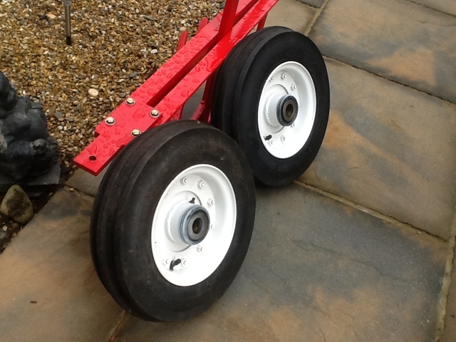

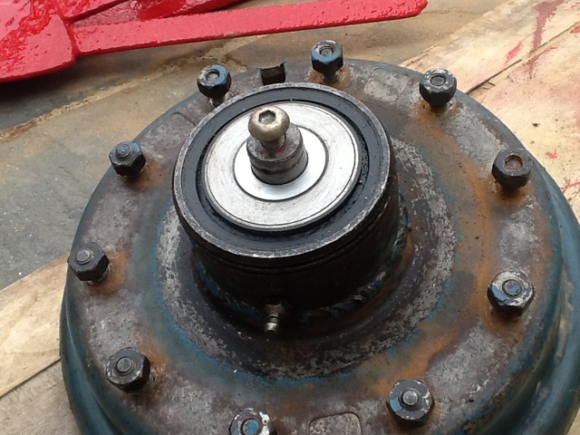

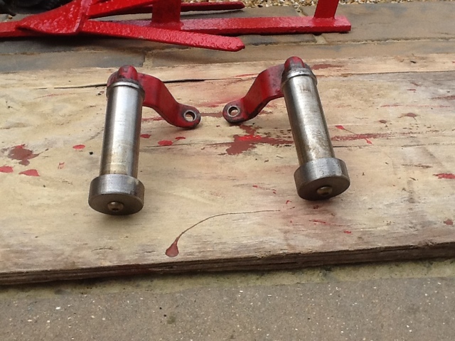

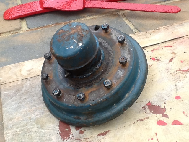

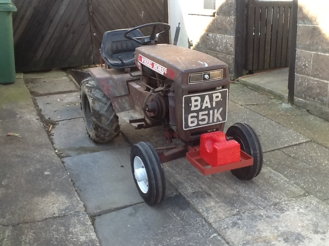

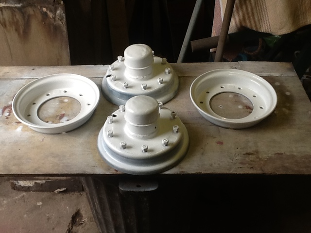

chris sutton 610 #1 Posted December 13, 2016 I converted my front wheels and hubs on my Raider 12. found a couple of wheels of an old trolley used a length of solid bar, bored a 3/4 hole through it and turned it down to fit the bearings. slid it over the Wheelhorse stubs and made a cup washer to hold it on. easy job, just a bit of labour. 17 Share this post Link to post Share on other sites
Hacksawhero123 351 #2 Posted December 13, 2016 I have got to get a lathe.... and learn how to use it. Very nice work, Chris. Mark 2 Share this post Link to post Share on other sites
Stormin 9,987 #3 Posted December 13, 2016 Should help with the ploughing, Chris. Nice job. 1 Share this post Link to post Share on other sites

elcamino/wheelhorse 9,363 #5 Posted December 13, 2016 @chris sutton You are quite and engineer. I really like looking at your reports on your work. 1 Share this post Link to post Share on other sites
