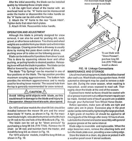

jeff w 4 #1 Posted December 12, 2016 Does anyone have a photo of the Trunion & where the downforce bar on my plow attaches? I have the extra bar (12") for down force, but not finding success. Appears to be binding on lower end w/lift bar. Blade not dropping fully. Thanks. Share this post Link to post Share on other sites
pfrederi 17,147 #2 Posted December 13, 2016 Does this help? 1 Share this post Link to post Share on other sites
jeff w 4 #3 Posted December 13, 2016 PFrederi, thank you kindly for your response! I had found this visual diagram last night. Last year when I mounted I left the lift bar on and I had no issues. This year blade would not drop fully, (+) severe binding w/lift rod & one ft down pressure bar. I tried flipping 12" bar 180° etc but not any success. Have decided to raise lift rod and anchor out of range of down pressure bar if I can? Will try to anchor bar in farthest end of bellcrank (?). I'm in snowbelt area and this blade has saved me an enormous amount of hard labor w/my 26" steel snowscoop. Lastly, is it best to fasten lift rod up out of way, or remove it? Removal looked complex, but maybe it isnt? Share this post Link to post Share on other sites

pfrederi 17,147 #6 Posted December 13, 2016 43 minutes ago, jeff w said: PFrederi, thank you kindly for your response! I had found this visual diagram last night. Last year when I mounted I left the lift bar on and I had no issues. This year blade would not drop fully, (+) severe binding w/lift rod & one ft down pressure bar. I tried flipping 12" bar 180° etc but not any success. Have decided to raise lift rod and anchor out of range of down pressure bar if I can? Will try to anchor bar in farthest end of bellcrank (?). I'm in snowbelt area and this blade has saved me an enormous amount of hard labor w/my 26" steel snowscoop. Lastly, is it best to fasten lift rod up out of way, or remove it? Removal looked complex, but maybe it isnt? I would wire it up out of the way. There are if I recall correctly a couple of E clips to contend with and bushings that you have to get out and save if you remove it. To cold to lie on the floor and do that now. Share this post Link to post Share on other sites
