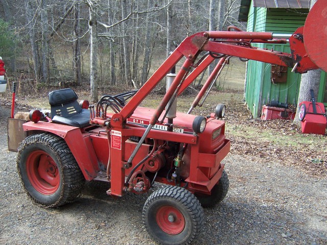

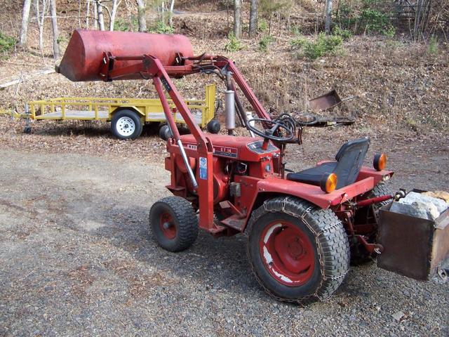

953 nut 69,827 #3 Posted December 12, 2016 My GT-14 has a Johnson Workhorse loader on it, was there when I bought it. If you need photos or measurements on the sub-frame I could do that in a couple of days; I'm booked up till Thursday. Only picture I have now is from behind. 2 Share this post Link to post Share on other sites

Thor27 892 #5 Posted December 13, 2016 Richard, that is a beauty! Share this post Link to post Share on other sites

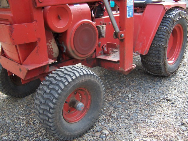

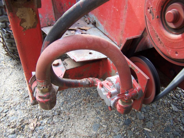

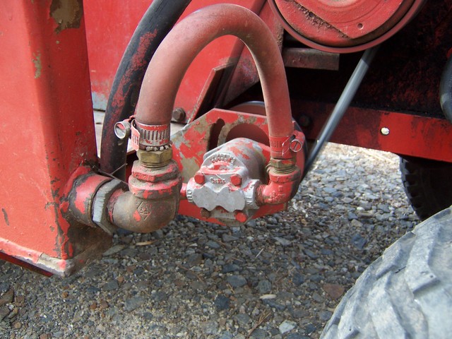

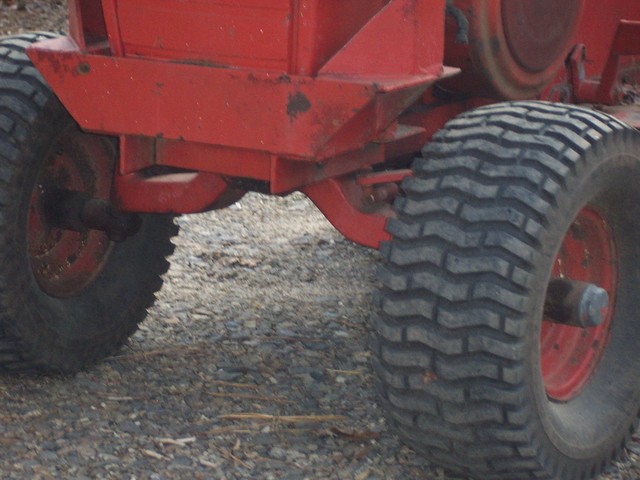

953 nut 69,827 #10 Posted December 16, 2016 Grabbed a few pictures of the mounting of my Johnson FEL, It has a two piece sub-frame and the pump mount is built into the rear cross-member. 2 Share this post Link to post Share on other sites
