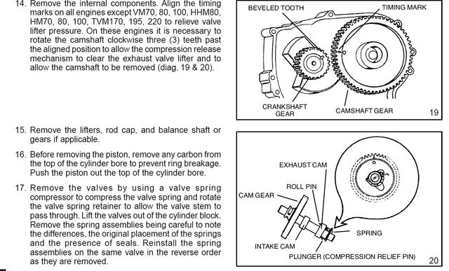

That will also allow you to check your ACR (automatic compression realease0  The exhaust valve should open slightly during the compression stoke as you turn the engine over.

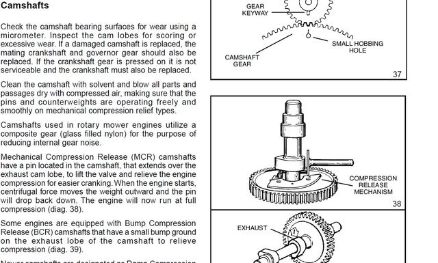

.020 clearance is a bit high for the exhaust valve and is likely part of the problem. The other possible issue is the pin on the camshaft mechanism that actually contacts the valve tappet and releases the compression. These will get worn over the years and will require either replacement or possibly a welding repair. The only problem is that you have to break the engine down to get to the cam. Try getting the valve specs back closer to correct and see if that doesn't work. Several different ways to accomplish this, although none are free. If the valve sealing surface is still thick enough, a machine shop can lightly grind the valve and seat which will close the stem clearance. A new valve may be necessary. A less recommended patch would be to have a good welder build up the valve stem with a hard filler and then grind it back to the proper clearance. Good luck. Those old Tecumseh engines are worth saving. When they are right, they have a lot of bite for their size and run very efficient.

You're right, .020 is correct specs for the exhaust. The compression release will not open the valve very far. Probably only a few thousandths. Most likely the operating pin on the cam is worn. If the lift is less than the valve clearance, it won't open and the compression stalls the starter. That's why putting a feeler gauge in the gap makes it work again. You could try lowering the clearance to .015 and see how that works, but its not simply an adjustment. You're looking at one of the methods I described above. I have a 16hp ohv Tecumseh that has some of the same issues at times. Mine calls for .010 ex valve clearance, but I keep it a tiny bit closer to help the compression release work properly.
