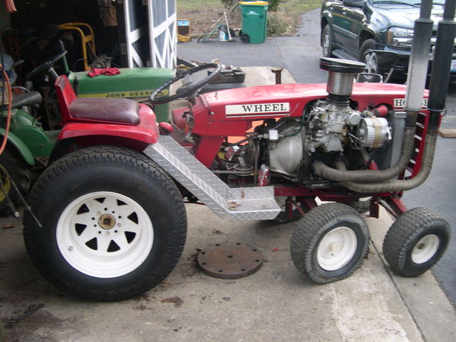

WHX?? 58,046 #8 Posted December 10, 2016 On the rear Mike?? like to see pics of that! @Ny Horse ...why are you "looking" and not "hauling"!! 2 Share this post Link to post Share on other sites

82Caddy 851 #10 Posted December 10, 2016 5 hours ago, Sarge said: Hmm , anyone ever done duals on D series ?? I've seen folks do them on almost every other model except those....? Sarge 3 hours ago, prondzy said: Seen them on a d200 with a loader on it. the loader was installed on the rear of the tractor so the weight was on a larger footprint. Here's your proof Was on craigslist for awhile, not sure what happened to it. ] 3 Share this post Link to post Share on other sites

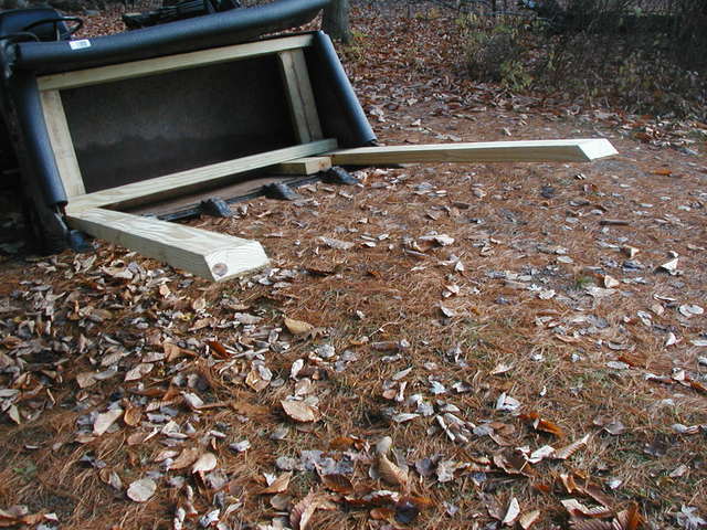

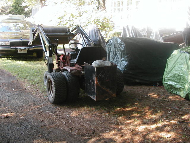

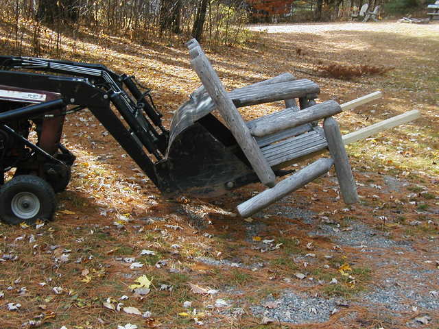

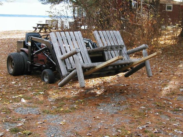

JackC 619 #14 Posted December 10, 2016 (edited) Here is some duals eye candy: This is my C-81 with a loader and dual wheels. That is correct a little C-81 with a loader. In my opinion, the C-81 is really too small of a platform for some serious loader work and the loader will be going onto a 1997 520H when I get around to it. I made some forks out of 2 x 4s which work real well for moving things around including lawn furniture and my heavy 60 inch decks. I also have a D-200 with a loader and the big D is a much better platform for a loader. When the loader is up in the air the dual wheels can save the tractor from tipping over on an incline. Best to keep the loader and bucket low when in motion. Don't ask me how I know. ((I came close to tipping over the D-200 which does not have the dual wheels.)) Edited December 10, 2016 by JackC 6 Share this post Link to post Share on other sites

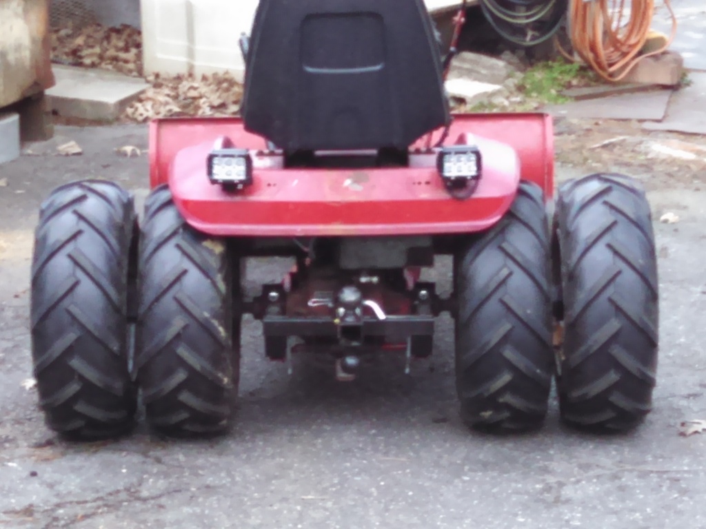

wheelhorsebo 20 #17 Posted March 17, 2017 This is what i got on e bay they are home made but it was worth it 5 Share this post Link to post Share on other sites
AMC RULES 37,259 #18 Posted March 17, 2017 Now you're ready for this. Share this post Link to post Share on other sites
