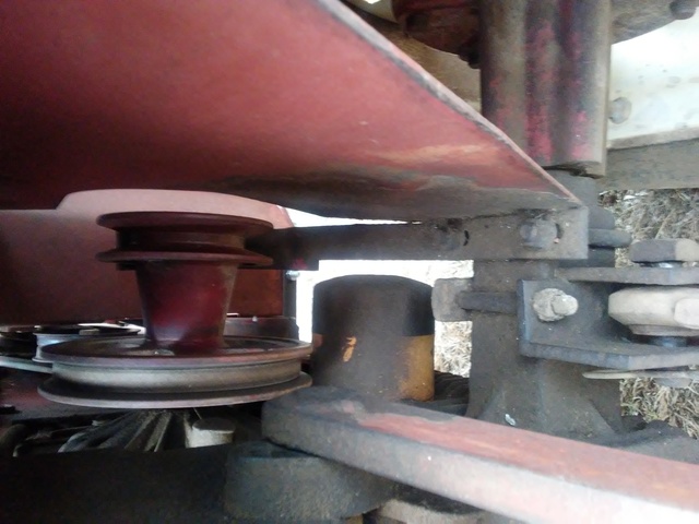

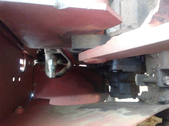

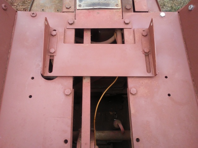

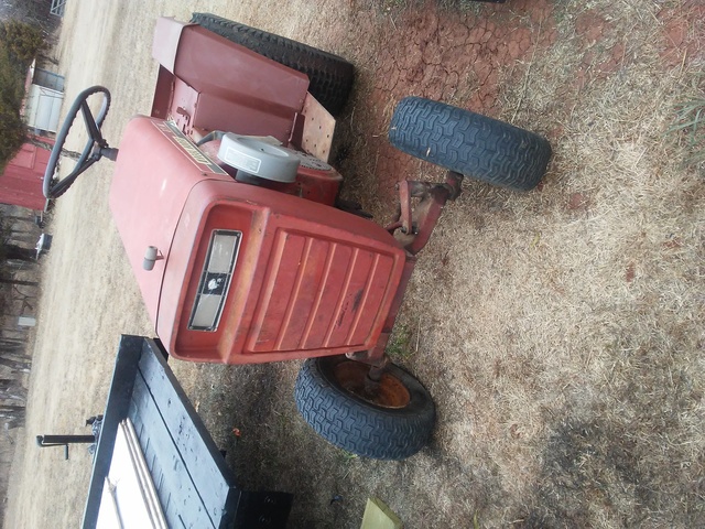

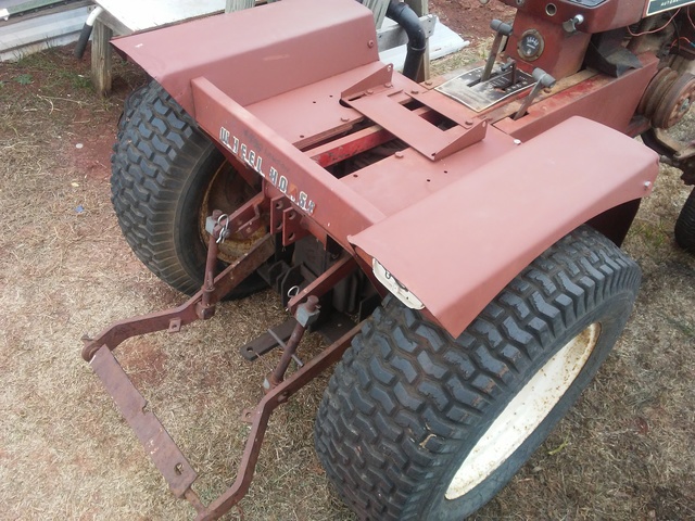

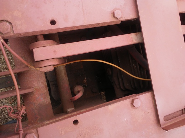

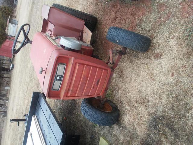

Bubba KC jr 9 #27 Posted December 10, 2016 My tractor has the battery under the hood and under the seat is just transmission and a bunch if hydraulic lines if I reach up under fender on left side I can feel what seems to be a part of transmitted that sticks out like a finger with what seems to feel like a flat headed screw with a straight screwdriver slot in it.I do know you can push it now its not easy but it can be pushed in what ever position the valve is in currently.after it warms up outside I will go out and use all this great information all of you have given me and also find the serial # and mod.# tag and get back with you all thank you all. I uploaded pics.don't know if you can tell anything from them but I can't find serial # and mod # tag but its to cold.I will have to wait until it warms up.I don't have a garage to put it in.thanks. Share this post Link to post Share on other sites
ztnoo 2,302 #28 Posted December 10, 2016 OK. Now we know a little more about your GT 14. The pics help a lot to understand what your are fighting. It has a 3-point hitch which necessitates that bar running thru the frame which operates the lift arms on the hitch. That does clog things up a bit more. Try loosening and sliding the seat mount bracket as far forward as you can. You might even try removing it. That may gain you some needed operating room. My GT 14 doesn't have a 3 point hitch, so I don't have anything in the way thru the middle of the frame like you do. Try operating the hitch if the tractor will run and see if you can gain more clearance and work room in either and up or down position. There a few guys on here with 3-point hitches on their GT 14s. My guess is they'll chip in here shortly. Glad you finally got the pic thing sorted out. p.s. I see you have one of those super valuable double pulleys on the right side which can run a tiller. Got a tiller that came with the tractor? Share this post Link to post Share on other sites

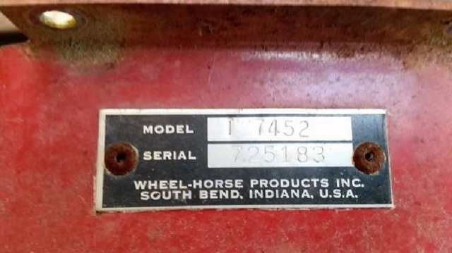

ztnoo 2,302 #31 Posted December 10, 2016 Bubba, I talked about "VIN" tag earlier. What I was referring to then was the tag on the Sundstrand tranny, which is turned sideways, when you look at it from the rear of the machine. Review my pics. There is a second "VIN" tag which Wheel Horse attached to every tractor they ever made. The Wheel Horse VIN tag, when you know the model codes, tells you everything about what it is and when it was made. Your GT 14 appears to have a solid cast front "grill". If so, it is likely a first year model (1969), which is 1-1441, on the VIN tag. I have 'a '69 model. My VIN tag is on the right side, as you sit in the operator's seat, under the 'dashboard', riveted to the hood stand. There are VIN tag location variations from model to model, but if you have a '69 solid cast grill GT 14, I can almost guarantee that's where your tag is. It should take less than a minute to find, even with a flashlight in the dark. Here's an example of at GT 14 Wheel Horse "VIN" tag: This tag indicates this is a 1970 model GT 14: 1-7452 See the listing below of model years and model numbers of GT 14s, to be able to identify yours. Look at the VIN tag on the hood stand under the dash....generally the right side.GT 14 Model #'s and year: 1-7441 1969 ____________ 1-7451 1970 1-7452 1970 1-7453 1970 ____________ 1-0500 1971 1-0501 1971 ____________ 1-0502 1972 1-0503 1972 ____________ 1-0502 1973 Once you see where the W.H. VIN tag is, we'll know what you have. You will too! Take a pic to celebrate!!! I hope this is helpful to you. Regards, Steve p.s. I guarantee you its a lot colder here in Indiana, than in OKC. http://forecast.weather.gov/MapClick.php?CityName=Gas+City&state=IN&site=IWX&lat=40.4892&lon=-85.6077#.WEyHpn001P_ 1 Share this post Link to post Share on other sites

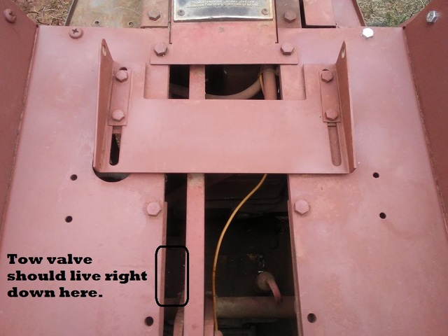

ztnoo 2,302 #33 Posted December 11, 2016 Richard, Not meaning to be purposely argumentative or condescending, but the tow valve is actually a bit forward of your rectangle. It's not inline in any close left/right lineal proximity to the filler tube. It's forward of that position. Share this post Link to post Share on other sites

ztnoo 2,302 #39 Posted December 11, 2016 (edited) Look at davoman1966 pic again! It shows exactly what the tow valve looks like. Edited December 11, 2016 by ztnoo Share this post Link to post Share on other sites

ztnoo 2,302 #41 Posted December 11, 2016 We still need to know the Model # on the tranny VIN tag to know what you have.......... Share this post Link to post Share on other sites

Sarge 3,473 #46 Posted December 12, 2016 You need to find that tag - it's in there somewhere . I'd highly suggest downloading the Sundstrand manual and start reading , most likely the pump is pretty weak and the acceleration valve for reverse is plugged or stuck . They can be cleaned but you'll need that manual for it . The direction control linkage is a wear item and can cause the same issue if it's not moving that valve like it should - that valve doesn't move very far in reverse so it's critical it works correctly . Sarge Share this post Link to post Share on other sites
ztnoo 2,302 #47 Posted December 12, 2016 11 minutes ago, Sarge said: You need to find that tag - it's in there somewhere Thank you reinforcing what I stated long ago in this thread. Until we know the model for sure, we're all kind of grasping at straws here..... Share this post Link to post Share on other sites

ztnoo 2,302 #49 Posted December 12, 2016 (edited) I have a '69, 1-7441, and my tow valve is exactly as pictured in the photo from and in the manual. Edited December 12, 2016 by ztnoo Share this post Link to post Share on other sites
