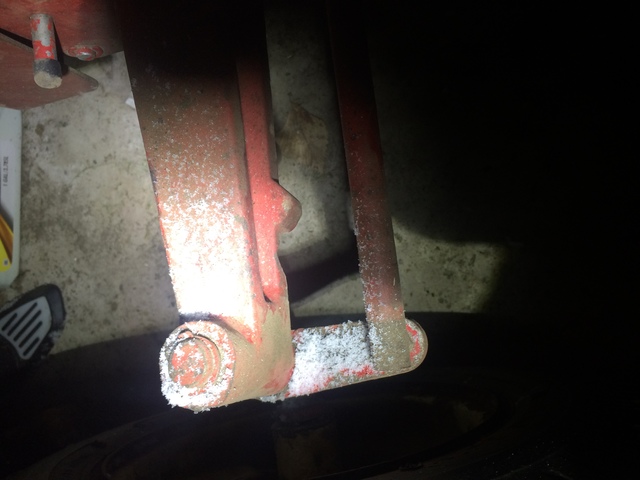

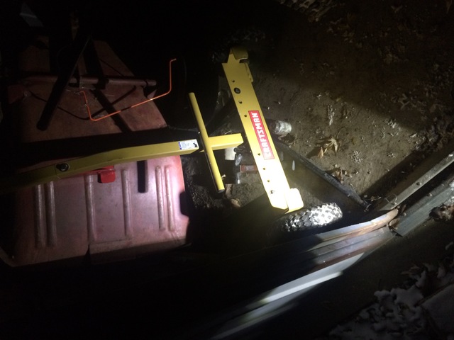

jellyghost 378 #1 Posted December 8, 2016 I bought a Craftsman jack, and I couldn't get it to work. The jack has a C-shaped piece of metal that is supposed to cup the front wheel arms. Unfortunately, there is a little triangle of metal keeping the cup from moving around the wheel arm as the tractor rises. I dropped the WH a few times while figuring this out! Does anyone have a way to make this jack work? Do you have a different jack suggestion? Share this post Link to post Share on other sites
Ed Kennell 47,733 #2 Posted December 8, 2016 I had the same problem with one of these lifts. They were designed to lift the tractors with the front tubular bumpers. The WH front axles are too wide to securely stay in the small Cs on the lift. I considered welding on larger Cs, but I sold mine and just use my floor jack. 4 Share this post Link to post Share on other sites

Sarge 3,473 #9 Posted December 9, 2016 On some jacks it's not hard to remove the swivel plate and figure out what size tubing fits tightly - build a spreader bar with either fixed or sliding saddles out of square tubing . I need to make a new one as soon as I either fix this stupid , junk Chinese/Craftsman aluminum jack's cylinder valves or replace it - probably with a Hein-Warner instead if I can find a used US made one - seems now they are built in China and still carry the name - like everything else . Here's a spreader bar for ideas - https://www.amazon.com/Cross-Floor-Adapter-holds-Extends/dp/B002LGLXM0 Sarge 1 Share this post Link to post Share on other sites
