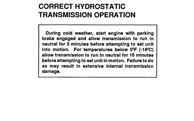

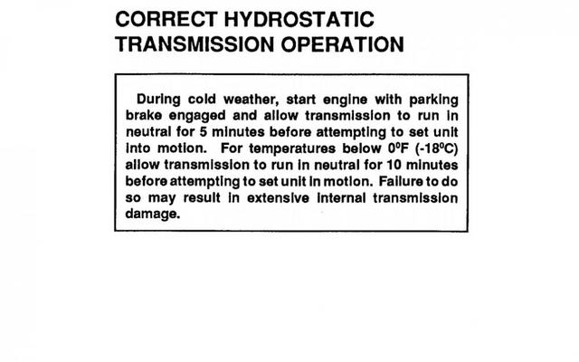

gwest_ca-(File Mod) 12,483 #4 Posted December 8, 2016 From the 1991 520-H operator manual Garry 2 Share this post Link to post Share on other sites
Ed Kennell 47,237 #5 Posted December 8, 2016 GARRY the MAGNIFICANT has the answer again. 1 Share this post Link to post Share on other sites
