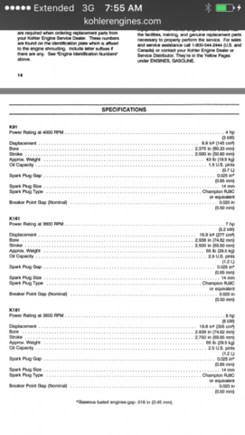

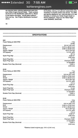

Hacksawhero123 351 #11 Posted December 15, 2016 I just went through this with a k161 on my old tiller. Had no problems with oil leakage from the breather until I changed the oil. Everything with the breather assembly was correct. Turns out that I had overfilled it with oil. I discovered this after looking up the oil capacity in the Kohler manual, then draining and measuring how much I had added. My engine does not have a dipstick, just a fill plug. Apparently if you fill to the bottom of the fill plug, its overfilled. I forget the amount of oil the manual calls for, but after measuring that amount and adding it to the crankcase, the leak went away. Good luck. Mark. 3 Share this post Link to post Share on other sites
Hacksawhero123 351 #12 Posted December 15, 2016 Double check this. The Kohler manual says 2.5 pints (1.2 liters) of oil. I suggest draining and measuring how much is in there. It's probably overfilled. If I remember correctly, the full oil level is not above the oil pan gasket. Someone please correct me if I'm wrong. Thanks. Mark. Share this post Link to post Share on other sites
