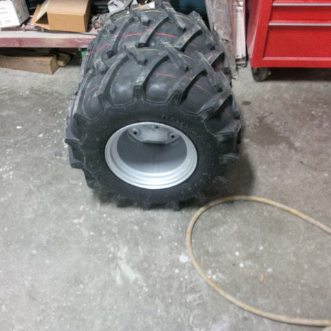

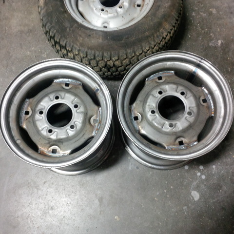

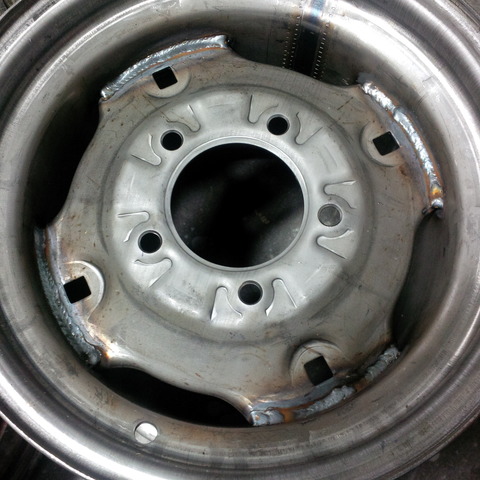

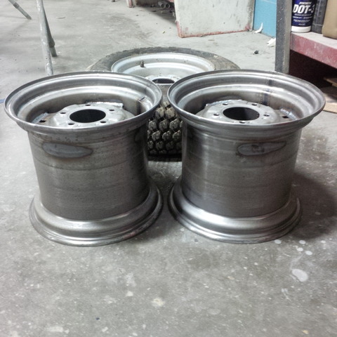

Notfishin 64 #10 Posted December 23, 2016 i have allready got two center plates from miller tire and installed them in some 8 1/2 wheels and im going to order two sets of the 10 1/2 inch . wheels and some centers to install , we tryed using the uncut Ag tires . and they just dig down too far and fast . best luck we had are with half wore out ag tires and cutting them . You did a good job on those wheels ! and those tires look great ! Share this post Link to post Share on other sites
fast88pu 3,402 #11 Posted December 23, 2016 Thank you. I hope they pull well this up coming season Share this post Link to post Share on other sites
Notfishin 64 #12 Posted December 23, 2016 My biggest. Problem was getting the center in the correct place before I tacked it in place . Did you make a jig or just measure and wild .like it did .mine turned out fine .but I was worried. Share this post Link to post Share on other sites
fast88pu 3,402 #13 Posted December 24, 2016 My centers fit snug so I put a straight edge across and measured while tapping them into place Share this post Link to post Share on other sites
