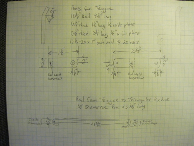

Walt 339 #2 Posted December 6, 2016 This is a drawing I made for T-MO when he needed help with the lever to articulate his plow not sure if this part is the same on the 48" and 42" but there are some more photos and references to this part in that thread it's on 6th page of implements and attachment section. 2 Share this post Link to post Share on other sites
Ed Kennell 47,619 #3 Posted December 6, 2016 (edited) That wire on the 48" plow on my 312 hydro measures 27 1/4". I do have 3 holes where I can adjust the height of the trigger for fine adjustment, but these holes are only 1/2 " apart. Edited December 6, 2016 by Ed Kennell 1 Share this post Link to post Share on other sites
