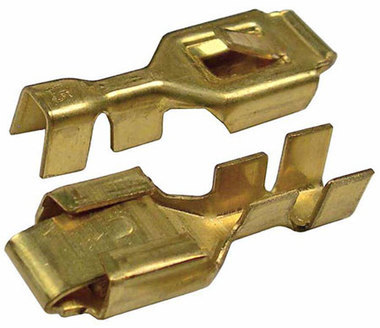

cod 129 #1 Posted December 5, 2016 Have any of you had any luck finding a replacement electrical connector for Toro part 102651? Apparently they are no longer carried by Toro and perhaps hen teeth are easier to find. I suspect I might be able to take the connector to a local auto parts store and root through the connectors and see if one fits but any info would be greatly appreciated. Thanks - Cod Share this post Link to post Share on other sites
gwest_ca-(File Mod) 12,324 #2 Posted December 5, 2016 It is possible the 102651 has been replaced by 218-534. https://www.partstree.com/parts/search/parts/?searchTerm=102651 Is this the female terminal that plugs onto the ignition switch spade terminals? Tang on the back that locks into the plastic holder? That was used by GM for years so they have to be available. Packard 56 was the name. https://www.google.ca/webhp?sourceid=chrome-instant&ion=1&espv=2&ie=UTF-8#q=packard+56+terminals&tbm=shop Garry This one? 2 Share this post Link to post Share on other sites

doc724 927 #4 Posted December 6, 2016 I think I bought them from Del City. Do an online search for Packard Electric Series 56 or PED series 56. You will find multiple vendors for both the terminals and the connectors. I always keep several terminals on hand as well as a couple of the more common plastic connectors (ignition switches, ammeter, seat switches etc). Garry said pretty much the same thing and he gave the URL's Share this post Link to post Share on other sites

cod 129 #8 Posted December 20, 2016 Just a quick follow up as the connectors from Del City were a perfect fit. I went out last weekend and started removing the existing plugs from the plastic plug that holds them to the ignition switch. I had initially thought that the existing connectors were trashed as they kept sliding off of the ignition switch and that I'd have to install the new connectors. It turned out that what had really happened was that the small locking tab that holds the connector in the plug had flattened out on a couple of them so they could wiggle off over time. I also found that the crimps that hold the wire to the connector was in great shape so I decided to re bend the locking tabs and replaced the plastic plug with a new one from Jack's Small Engines. So far everything is working great and if any of find that your "beast" seems to have starting problems that cause you to jump across the solenoid, it might just be that the locking tab is no longer working as it should. So much for the "quick" part... Cod Share this post Link to post Share on other sites
