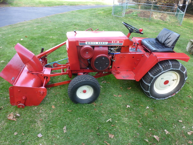

Rob R 989 #3 Posted December 5, 2016 Yes you can use Sears or International Harvester (IH) weights and they will work just fine.... Note had to drill the rims to make them work on the GT14 1 Share this post Link to post Share on other sites
