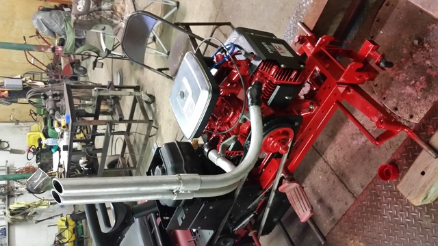

Notfishin 64 #1 Posted December 5, 2016 Guys i see the motors Painted on you Tractors , are you using same paint on motor and tractor , or is there a heat Engine paint that matches the Paint your using Share this post Link to post Share on other sites

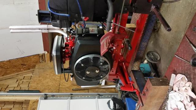

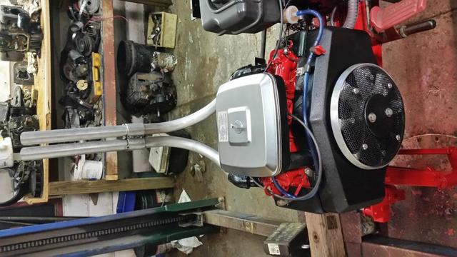

Notfishin 64 #7 Posted December 17, 2016 Well I got it done .used same paint as I used on the fram .hope she holds up. Thanks guys for the advice 4 Share this post Link to post Share on other sites
19richie66 17,932 #8 Posted December 19, 2016 Very nice looking. 1 Share this post Link to post Share on other sites
