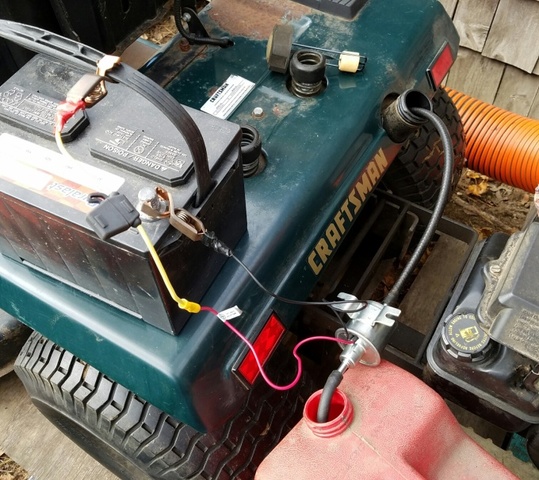

midpack 1,103 #1 Posted December 5, 2016 not sure where to put this, but I'm thinking some of you guys might like it. I like to drain the fuel, and run the carb out of gas on machines that will not be used for several months just to avoid problems. I've used a lot of different siphon methods and most of them aren't very good... I came up with a handy dandy device made from one of those cheepo ($12 delivered off ebay) electric fuel pumps I love so much! now, don't judge the machine... it's done some valuable service over the years and is now dedicated to yard cleanup with an Agri Fab leaf collector wagon attached. this is my initial test run to make sure it works, I plan to install an on/off toggle switch, inline fuel filter, longer fuel lines, and much longer wire to have the battery a little further away... lol the setup really kicks butt!! wish i had thought of this years ago 9 Share this post Link to post Share on other sites

Terry M-(Moderator) 2,287 #4 Posted December 5, 2016 Good idea!! Just make sure your careful about clamping onto the battery near open fuel containers... 9 Share this post Link to post Share on other sites
midpack 1,103 #5 Posted December 5, 2016 7 minutes ago, T1257 RETIRED WRENCHER. said: midpack May I ask why do fell the need to drain the tank. I can see the carb. I think a good fuel stable would work. Any way if works for you and you have good luck with it go for it. How is everything in Southwick? 2 reasons... 1, i have a bunch of thirsty machines... lol 2, if this machine sits for 5 to 6 months, or longer, the fuel will be getting kind of stale... 2 minutes ago, Terry M said: Good idea!! Just make sure your careful about clamping onto the battery near open fuel containers... yup. hence the plan for a toggle switch and longer wires 1 Share this post Link to post Share on other sites

Docwheelhorse 2,847 #17 Posted January 6, 2017 Did something similar for similar reasons... couple suggestions. 1) mount pump on an 18" piece of 2x8 2) go to harbor freight and buy cheap siphone kit with squeeze ball. Put said squeeze ball on input side so you can "squeeze to prime". Cut most of output side hose off and re-attach to output side . 3) wire pump with cig lighter plug and use your jump pack to power it (alot easier to carry than a car battery) Walla.... works great and you mouth can concentrate on processing a swig of beer not spitting out gas... lmao Tony Share this post Link to post Share on other sites

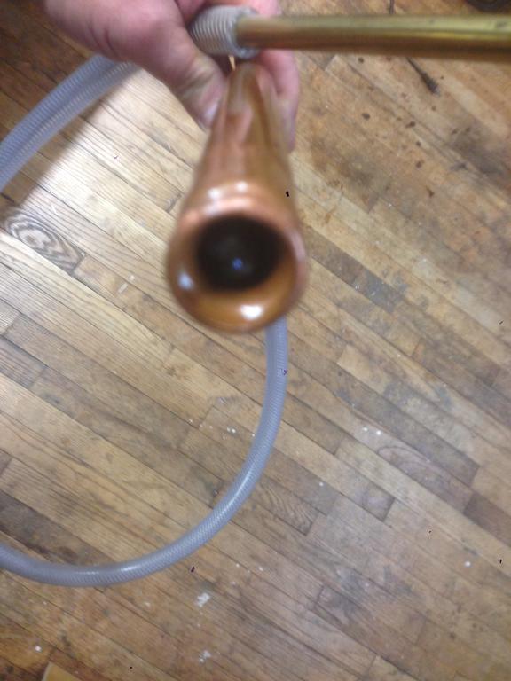

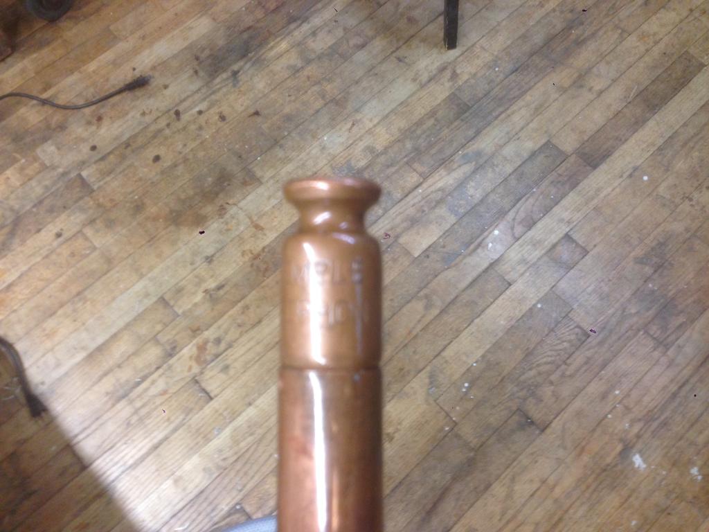

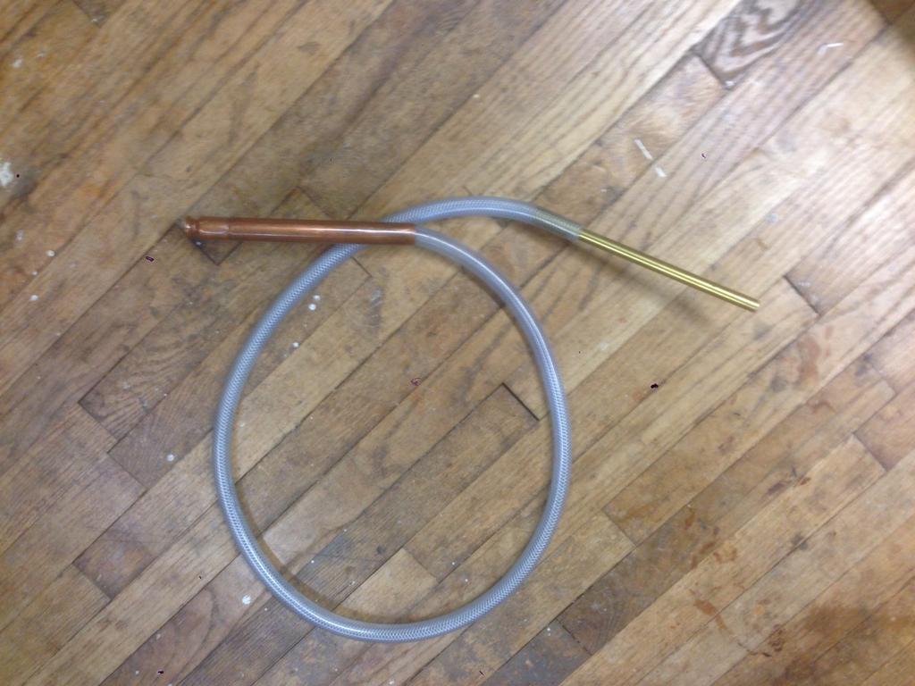

formariz 12,354 #21 Posted April 21, 2018 I use this little contraption called "simple siphon". You just shake it in the tank and it starts siphoning fluid. It works great. I just added a length of copper pipe to keep end of hose straight and rigid. I have two of them, one dedicated to gasoline, and the other one for kerosene. 2 Share this post Link to post Share on other sites
