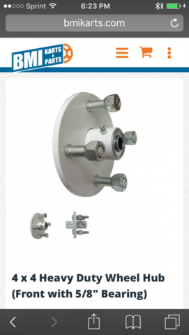

Hacksawhero123 351 #1 Posted December 5, 2016 Has anyone converted to 4 on 4" four bolt front hubs? I'm wanting to do this to run 18x8x8 front tires. This is the standard golf cart size tire and wheel. Factory wheels and tires can be had cheep as everyone around here is jacking their carts up and upgrading rims. I found these hubs that will accept the 1 3/8" OD Wheel Horse bearings. Also wheel spacers are available as I need to space the larger tires away from my drive mule. I'm just wondering if anyone has tried this and what results they had. Thanks! Mark. Share this post Link to post Share on other sites
953 nut 70,076 #2 Posted December 5, 2016 I used regular trailer hubs from H.F. with 1" bearings and bushed the front spindles up from 3/4" to 1". I didn't use the wide tires though. Are your spindles 5/8"? Share this post Link to post Share on other sites
Hacksawhero123 351 #3 Posted December 5, 2016 My spindles are 3/4" so I would have to swap in the Wheel Horse 1 3/8x 3/4" bearings. 953Nut, where did you find your 3/4x1" bushings"? Mark. Share this post Link to post Share on other sites

Thor27 892 #5 Posted December 5, 2016 (edited) Another option is to use a golf cart hub. You would have to run a 3/4-16 die on the spindle, grind the welds off the wheel back stop and weld on a 3/4 x 1-1/8 stand off bushing to meet the seal. Doesn't appear to be a seal on the ones you show? I did this, but chose not to use them as a 520 axle became available to me. The hubs don't appear very heavy duty but I've stood my old v twin old club car on the bumper many many times. Edited December 5, 2016 by Thor27 added second paragraph 1 Share this post Link to post Share on other sites
