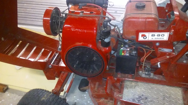

william kirk 11 #1 Posted December 4, 2016 Hey guys, im trying to figure out if i have an 8 hp or a 12 hp on my b-80, i seen pics of the 12 and it looks like mine, but i dont know for sure. A ny features or markings to tell the two apart..... thanks Share this post Link to post Share on other sites

N3PUY 1,031 #3 Posted December 4, 2016 the flywheel is much larger on a 12HP than on a 8HP. Share this post Link to post Share on other sites

Terry M-(Moderator) 2,304 #7 Posted December 4, 2016 Are you sure??? Looks like a 10 or 12 hp.... 1 Share this post Link to post Share on other sites

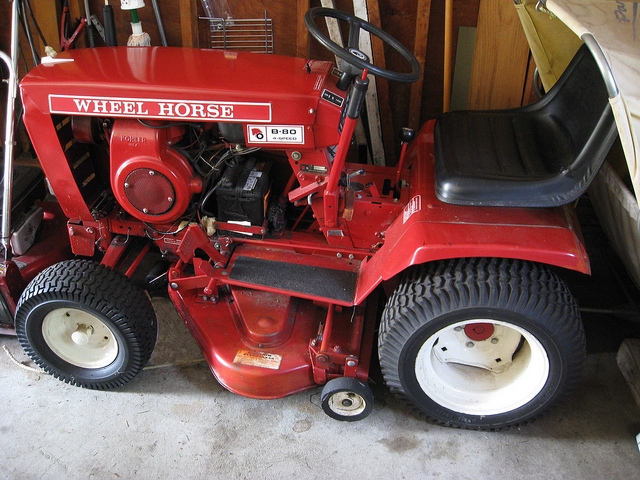

Racinbob 13,047 #8 Posted December 4, 2016 That's definitely not an 8 horse. Look at the difference in the size. 10- 16 hp's are basically the same size externally and much bigger than an 8 hp. The 8's also mounted on a riser plate. 3 Share this post Link to post Share on other sites
953 nut 67,522 #9 Posted December 4, 2016 Count your head bolts; an 8 will have seven and a 10, 12 or 14 will have nine. 2 Share this post Link to post Share on other sites
william kirk 11 #10 Posted December 4, 2016 8 bolts that i can see dang things huge! plate calls it an 8 , the guy i bought it from says 8, but i think its to big to be an 8....lmao Share this post Link to post Share on other sites
william kirk 11 #11 Posted December 4, 2016 racin you are right i believe, if yours is an 8 mine is deff not that. yours has about a 2 in raised ring around the screening, mine has about 1/2 in raised area around the screen cover.its got to be a 10 or 12. 2 Share this post Link to post Share on other sites

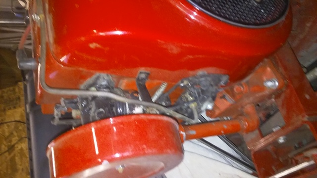

clueless 3,427 #12 Posted December 4, 2016 Need a pic of how the throttle cable connects to the engine. Share this post Link to post Share on other sites
Racinbob 13,047 #13 Posted December 5, 2016 1 hour ago, william kirk said: racin you are right i believe, if yours is an 8 mine is deff not that. yours has about a 2 in raised ring around the screening, mine has about 1/2 in raised area around the screen cover.its got to be a 10 or 12. That's not mine but I just wanted to show you the obvious difference between a big block and the small block 8. The other guys are letting you know the more subtle differences between the 10, 12, 14 & 16 horse motors. All good stuff. 1 Share this post Link to post Share on other sites
william kirk 11 #14 Posted December 5, 2016 looked at some pics....pretty sure its a 10 hp 2 Share this post Link to post Share on other sites
