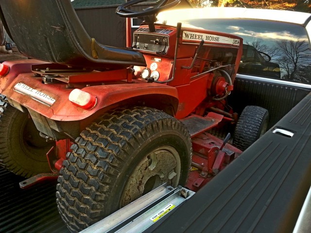

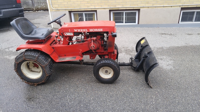

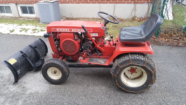

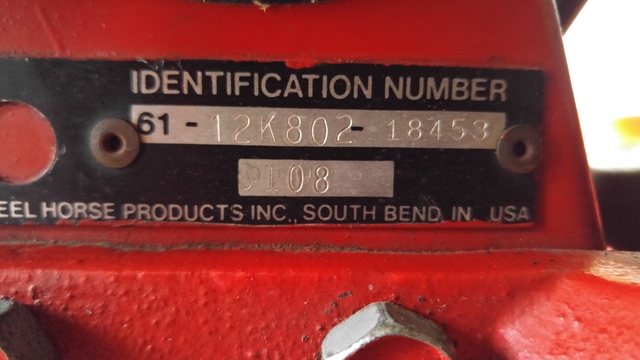

gt4 196 #7 Posted December 5, 2016 Well i ended up buying this c120 and it sounds great and feels real solid and strong. It's my first tractor with a high low range. Now if i can hunt a brinley plow down i can get to one of these meet and greet plow days! Could someone help tell me what year this is by the tag numbers. I posted a picture of it .Thanks 5 Share this post Link to post Share on other sites
Racinbob 12,233 #8 Posted December 5, 2016 That would be a 1976 1 Share this post Link to post Share on other sites

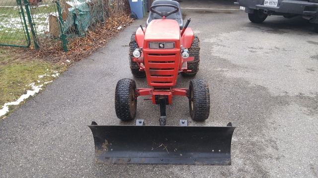

Ed Kennell 43,086 #10 Posted December 5, 2016 She looks good....nice straight tin. Is that original paint and decals? You may have to clean up the wiring and clean all terminals and connections. Is the plow frame connected to the transmission/ frame plate at the rear? Share this post Link to post Share on other sites
gt4 196 #11 Posted December 5, 2016 5 minutes ago, Ed Kennell said: She looks good....nice straight tin. Is that original paint and decals? You may have to clean up the wiring and clean all terminals and connections. Is the plow frame connected to the transmission/ frame plate at the rear? Ed, i see some faint paint runs so i would say someone touched up some spots, and yes it is connected to the transmission/frame plate. Is that not a good thing? 1 Share this post Link to post Share on other sites
Ed Kennell 43,086 #12 Posted December 5, 2016 (edited) No, that should be fine. The force on the plate from the plow is actually pushing the frame plate tighter to the tranny. If it were pulling and adding tension to the 4 3/8" bolts, then I would be concerned but this is not the case. I could see it wasn't connected to an axle bracket like a normal WH plow frame. I assumed it had a pin thru the two holes at the bottom of tranny/frame plate. I like that plow centering bracket on the front...using the frame of an old mule drive. I made a similar bracket for the front of my plow on my 312. Edited December 5, 2016 by Ed Kennell 2 Share this post Link to post Share on other sites

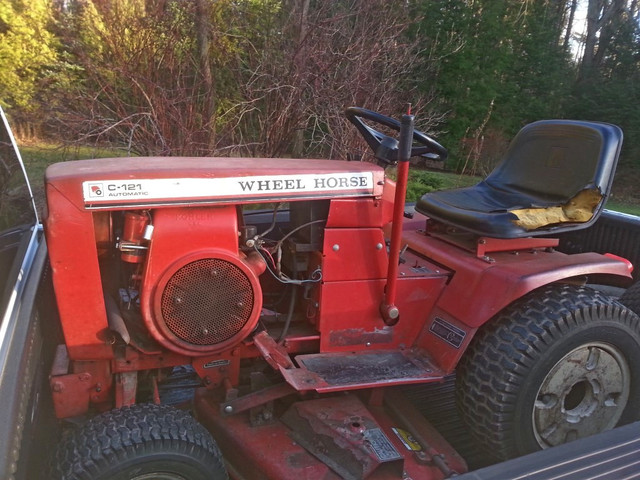

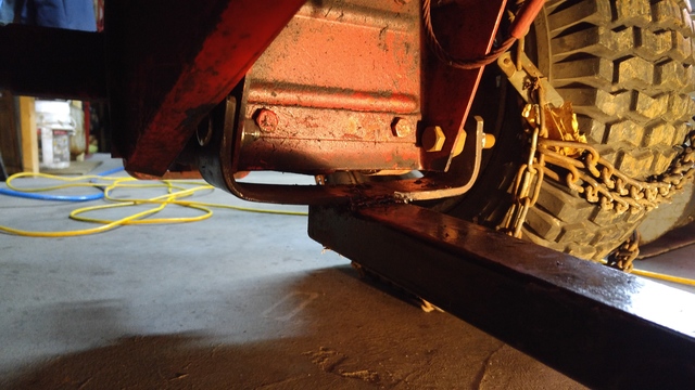

DennisThornton 4,771 #13 Posted December 5, 2016 That snow plow confuses me. Would loved to see more pics of how it attaches from the rear. Not to highjack this thread but as proof of my earlier post: And Gary, you really should charge for your services! 3 Share this post Link to post Share on other sites

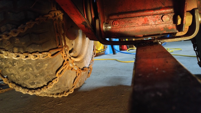

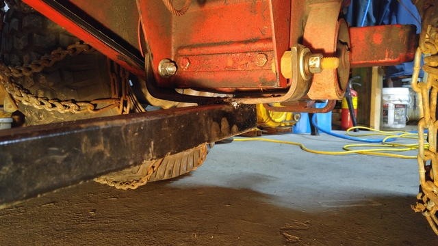

gt4 196 #22 Posted December 6, 2016 22 hours ago, gt4 said: Hey Dennis, is there much difference between the c120 and c121? Dennis here's how that snowplow hooks up under the tractor 4 Share this post Link to post Share on other sites
