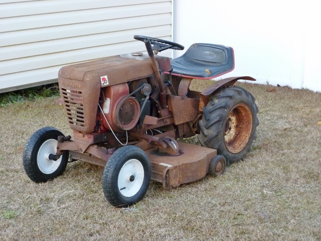

Dave's 854 75 #1 Posted November 18, 2016 The 854 was a barn find. I repaired the ignition and freed the stuck open exhaust valve and now it starts easy and runs good. A satisfying experience! 11 Share this post Link to post Share on other sites

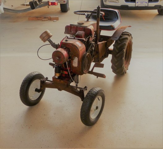

Dave's 854 75 #3 Posted November 23, 2016 I am cleaning up the fuel system and the wiring harness. Putting on new choke and throttle cables. Soon I will get the top on and make a video. This picture is today. 8 Share this post Link to post Share on other sites

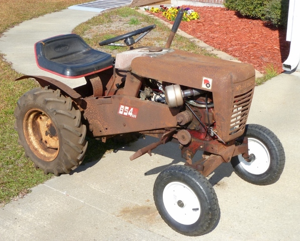

Dave's 854 75 #4 Posted November 26, 2016 The machine was balking a bit today. Good news- the tank does not leak. The sediment bowl leaks but that is easy to replace. The tractor started and ran good at first so I cut it off and installed the hood and setup the camera for a video. And the tractor would not start. Starter turning hard but the belt not moving. Pulled the spark plug, engine turns freely, install the plug starts right up. Put the hood on, start the camera- same problem. I go through this several times. I wonder if the carb is causing a flood when the engine is turned off. Or maybe my recent throttle cable and choke cable install is improperly rigged. Tomorrow is another day. 8 Share this post Link to post Share on other sites

Dave's 854 75 #13 Posted December 3, 2016 (edited) I ran the 854 a half hour at a high idle. I decided to install the mower deck which was not too painful. I found the lift rod broken at the beginning of the threads so the deck is now just hanging on a tie strap. The blades turn freely. Edited December 3, 2016 by Dave's 854 3 Share this post Link to post Share on other sites
