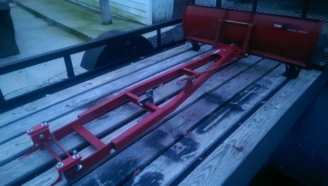

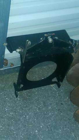

mikeeyre74 290 #1 Posted December 2, 2016 Anyone recognize what this is to? https://www.dropbox.com/s/tpw5ry3nw5nzu2b/plate.JPG?dl=0 Mike Share this post Link to post Share on other sites
Ed Kennell 47,026 #2 Posted December 3, 2016 My guess would be a lift lever for a tiller or snowblower. 2 Share this post Link to post Share on other sites
mikeeyre74 290 #3 Posted December 3, 2016 I don't recognize that attachment at all? Doesn't look like a classic wheel horse thing to me that I have ever seen.. is it for a different series? Share this post Link to post Share on other sites
WVHillbilly520H 10,379 #4 Posted December 3, 2016 That my friends is part of the lift linkage for the 260 series snow plow ,Jeff 3 Share this post Link to post Share on other sites
oldredrider 2,553 #5 Posted December 3, 2016 Jeff, you need to go on Jeopardy! 2 Share this post Link to post Share on other sites
mikeeyre74 290 #6 Posted December 3, 2016 Amazing! Thanks! Share this post Link to post Share on other sites
DennisThornton 4,773 #7 Posted December 3, 2016 Mike. You got the rest of it? Including the hitches? At least the rear? I don't fully understand the rest that is needed... Share this post Link to post Share on other sites

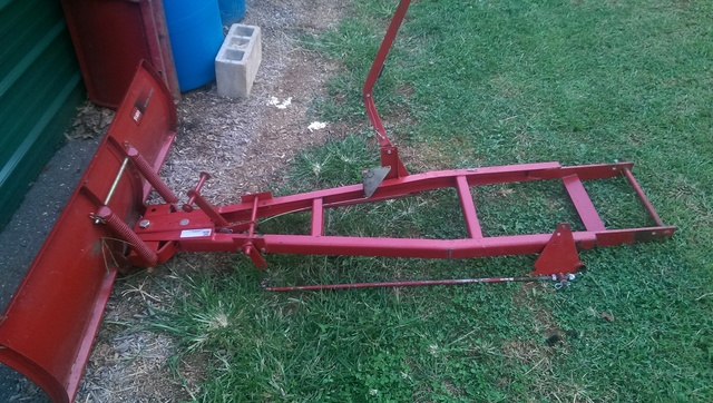

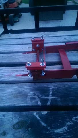

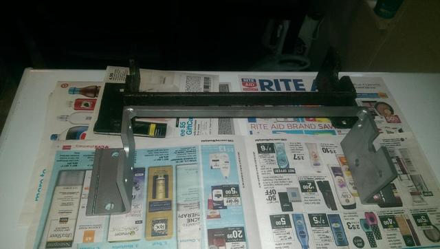

WVHillbilly520H 10,379 #8 Posted December 3, 2016 (edited) 53 minutes ago, oldredrider said: Jeff, you need to go on Jeopardy! I'd freeze up I'm front of lights cameras and audience ... 26 minutes ago, DennisThornton said: Mike. You got the rest of it? Including the hitches? At least the rear? I don't fully understand the rest that is needed... From what I was told when I acquired the blade ,that piece went on the mower lift linkage then the rod ran along/under the frame to front brackets that went into the front attach-a-matic and that is what actually raises and lowers the blade, because of the vertical shaft engine/belt drive it doesn't use the center lift link such as the classics and xi series then the rear hitch I have is actually a 2 piece part 1(the larger flat part with 10" hole) is bolted the bottom of the frame just for the blade then bolt on the second for the tiller and trailer/pin hitch, also I have all of the linkage and brackets left over from converting that plow to fit a classic,Jeff Edited December 3, 2016 by WVHillbilly520H 1 Share this post Link to post Share on other sites
mikeeyre74 290 #9 Posted December 3, 2016 Dennis, I don't have this thing at all. I'm trying to figure it out for an acquaintance of mine is all. He's trying to hook that blade to a Work horse series and wondering why it won't make sense.. hahaa! Now we know! Share this post Link to post Share on other sites
WVHillbilly520H 10,379 #10 Posted December 3, 2016 Mike if you need some help or ideas on the conversion PM me it was really straightforward and easy just study/ look at my pics and it helps if you have a classic style around for measuring,Jeff. Share this post Link to post Share on other sites
mikeeyre74 290 #11 Posted December 3, 2016 So you're saying the dimensions of the bald frame are fine.. and if he welds the tab there into the crossmember of the A frame, and gets himself an old style rear hitch, you can kinda knock the other stuff off the frame and hook it up? Share this post Link to post Share on other sites
WVHillbilly520H 10,379 #12 Posted December 3, 2016 2 hours ago, mikeeyre74 said: So you're saying the dimensions of the bald frame are fine.. and if he welds the tab there into the crossmember of the A frame, and gets himself an old style rear hitch, you can kinda knock the other stuff off the frame and hook it up? 100%...with the "tab" it has to be a little offset to the left or right about an inch from center can't remember right this moment and I/we used the 260 angle handle that will be on the "outside" of the foot rest instead of in board like the classics, and I made the axle hitch myself copied from my original,Jeff. 1 Share this post Link to post Share on other sites
