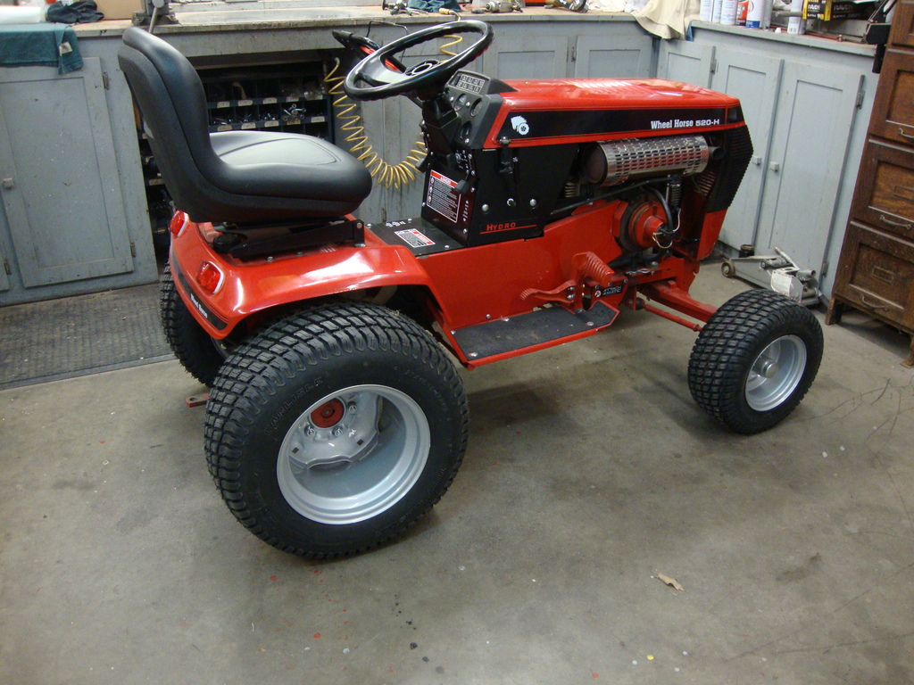

WHX?? 58,327 #51 Posted January 8, 2017 I told you if you weren't careful Denny you were going to end up with a nice tractor! Sorry MN boys...he's closer to WI....I'll come get it! 4 Share this post Link to post Share on other sites
Sarge 3,473 #52 Posted January 8, 2017 It should stay in Illinois , folks - it can come here if it wants to... Sarge 2 Share this post Link to post Share on other sites

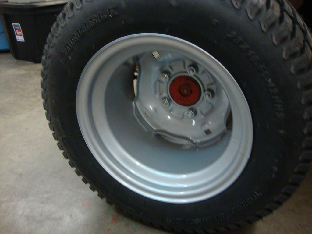

Fun Engineer 863 #53 Posted January 8, 2017 That turned out really nice Denny. Hope you get some snow to use it on. Are those Carlisle Turf Masters? I'm thinking of the same tire (23x10.5x12) for my GT 1848. What size are on the front? Mine currently has 16x6.5x8. 1 Share this post Link to post Share on other sites
AMC RULES 37,260 #54 Posted January 8, 2017 (edited) Argent looks really great Denny... no clear over mine here. Like that new seat too... share the link please? Edited January 8, 2017 by AMC RULES 1 Share this post Link to post Share on other sites
dclarke 4,274 #55 Posted January 9, 2017 1 hour ago, Fun Engineer said: That turned out really nice Denny. Hope you get some snow to use it on. Are those Carlisle Turf Masters? I'm thinking of the same tire (23x10.5x12) for my GT 1848. What size are on the front? Mine currently has 16x6.5x8. They are Turf Masters, Dave. 7.50's on the front, I put these tires on my C160 a while back and like them. 1 hour ago, AMC RULES said: Argent looks really great Denny... no clear over mine here. Like that new seat too... share the link please? Thanks, Craig.... The seat is a K&M 123 Unipro, I got it from Turfseats.com. I saw one on Bob Maynard's 416 and liked the way it looks on this series tractor, plus it has the correct bolt pattern to mount it. 2 Share this post Link to post Share on other sites

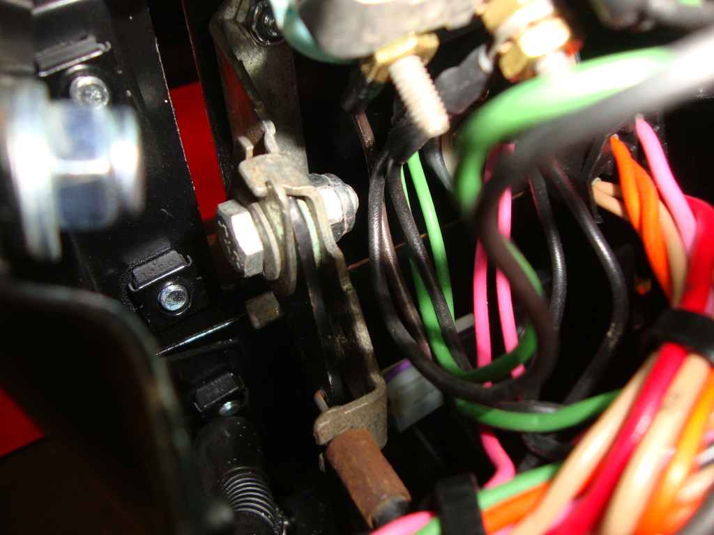

dclarke 4,274 #66 Posted January 12, 2017 I had forgotten that the throttle lever was loose and wouldn't hold the engine at a steady rpm so I replaced the rivet that holds it together with a fine threaded bolt and lock nut and have got that tightened down, now it holds at a steady rpm. I've also discovered that my volt meter is bad so I'm gonna need to find a replacement for that. I finished up putting the decals on and also decided to spray a clear coat over the Argent silver paint on the rims, what a difference that made. I used Rustoleum Crystal Clear and really like how the paint shines now. 17 Share this post Link to post Share on other sites

WHX?? 58,327 #68 Posted January 13, 2017 Age old problem with the throttle.. couple of spring washers in there doesn't hurt either. I never had any luck with the rattle can clear coat but I think I was impatient and not letting the base coat dry enough! Looking good tho 1 Share this post Link to post Share on other sites

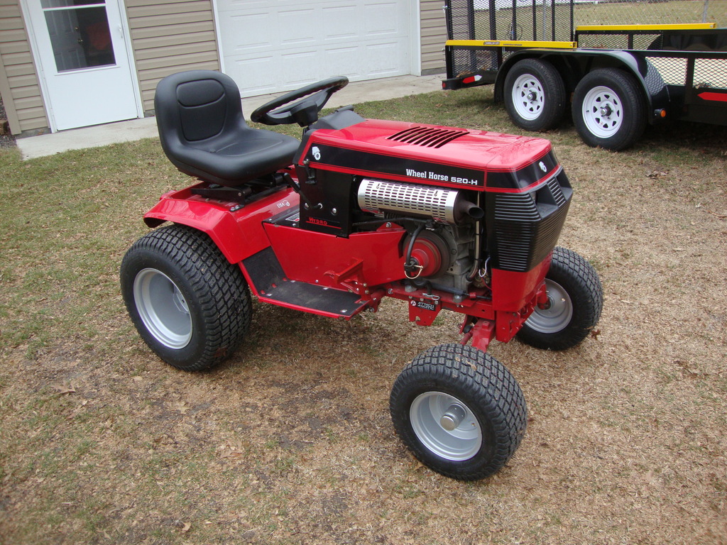

dclarke 4,274 #69 Posted January 26, 2017 With the warmer temps the past several days I've had a chance to warm the engine up a few times and today I checked the torque on the head bolts, I've also replaced the bad volt meter and got the foot pedal linkage adjusted properly, the more I drive this thing, the more I like it. I might have to stick a deck under it this spring so I can get some seat time. For now, this project is done. 14 1 Share this post Link to post Share on other sites
