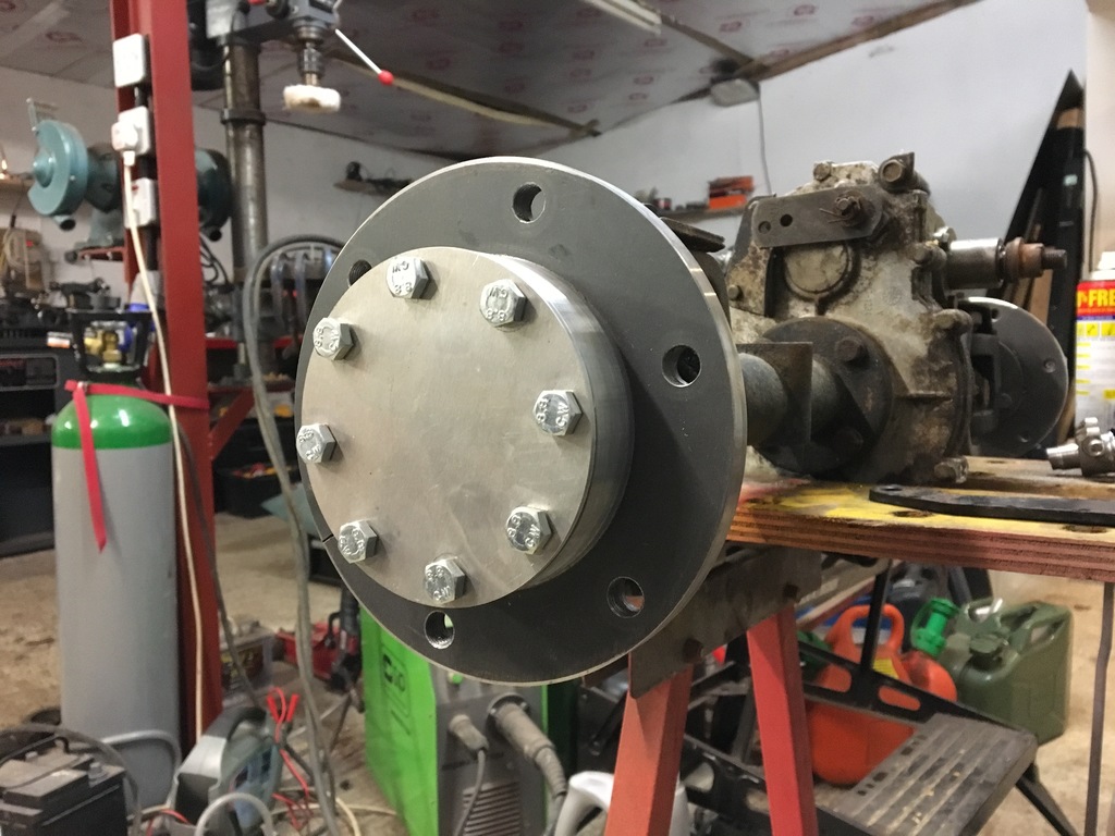

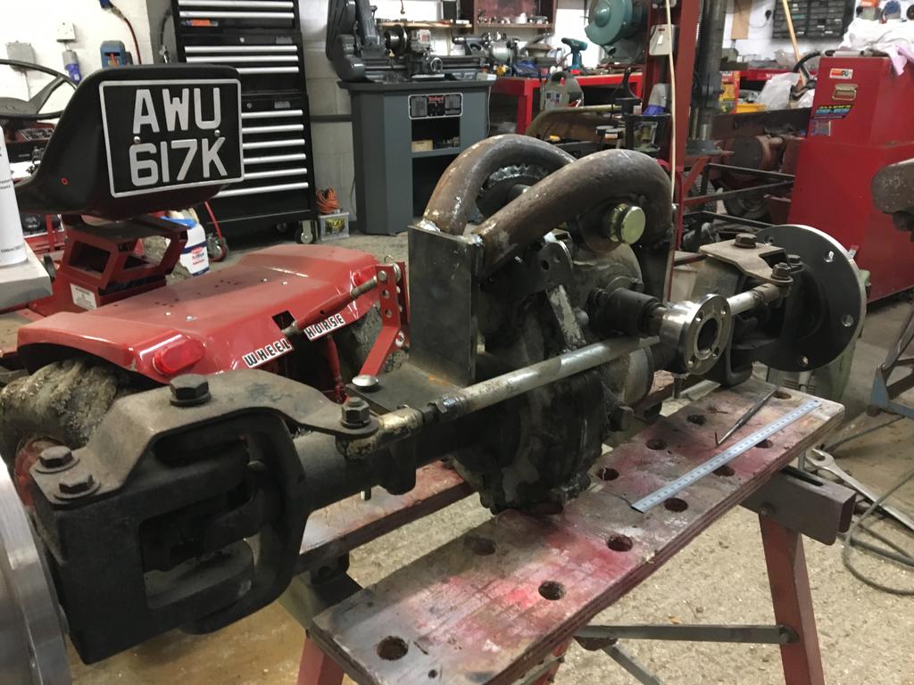

meadowfield 3,179 #26 Posted February 28, 2017 Tidied up the front hubs and made covers for the stub axles over the weekend 8 Share this post Link to post Share on other sites
19richie66 17,932 #27 Posted March 1, 2017 Nice work Mark, as always! 1 Share this post Link to post Share on other sites

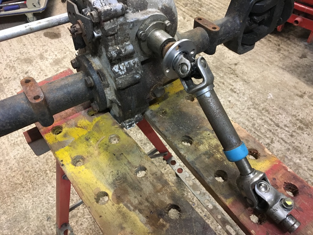

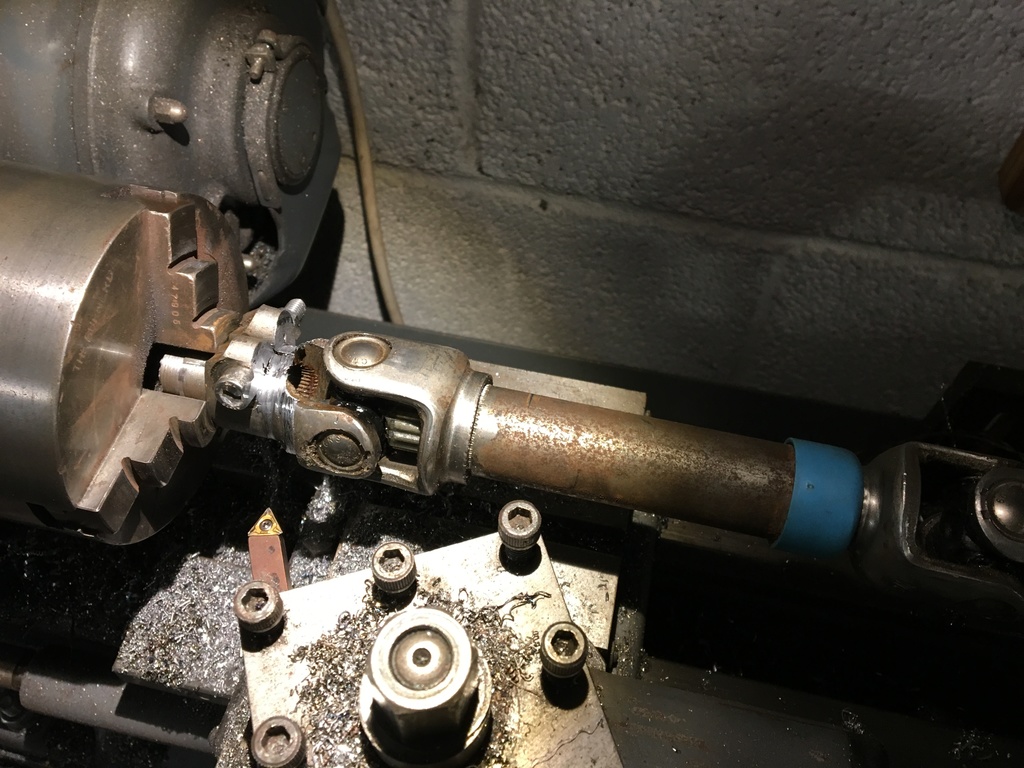

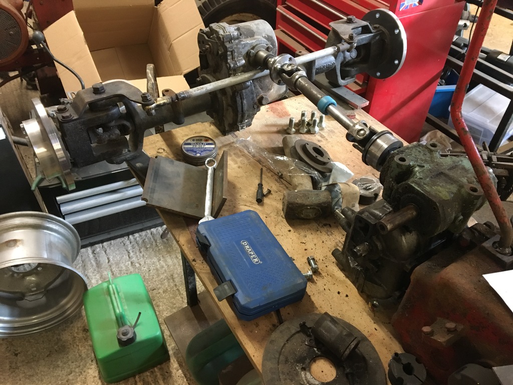

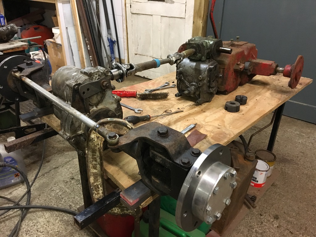

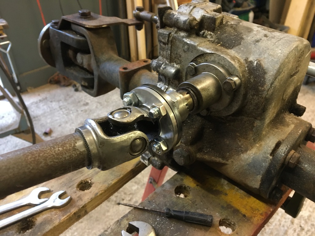

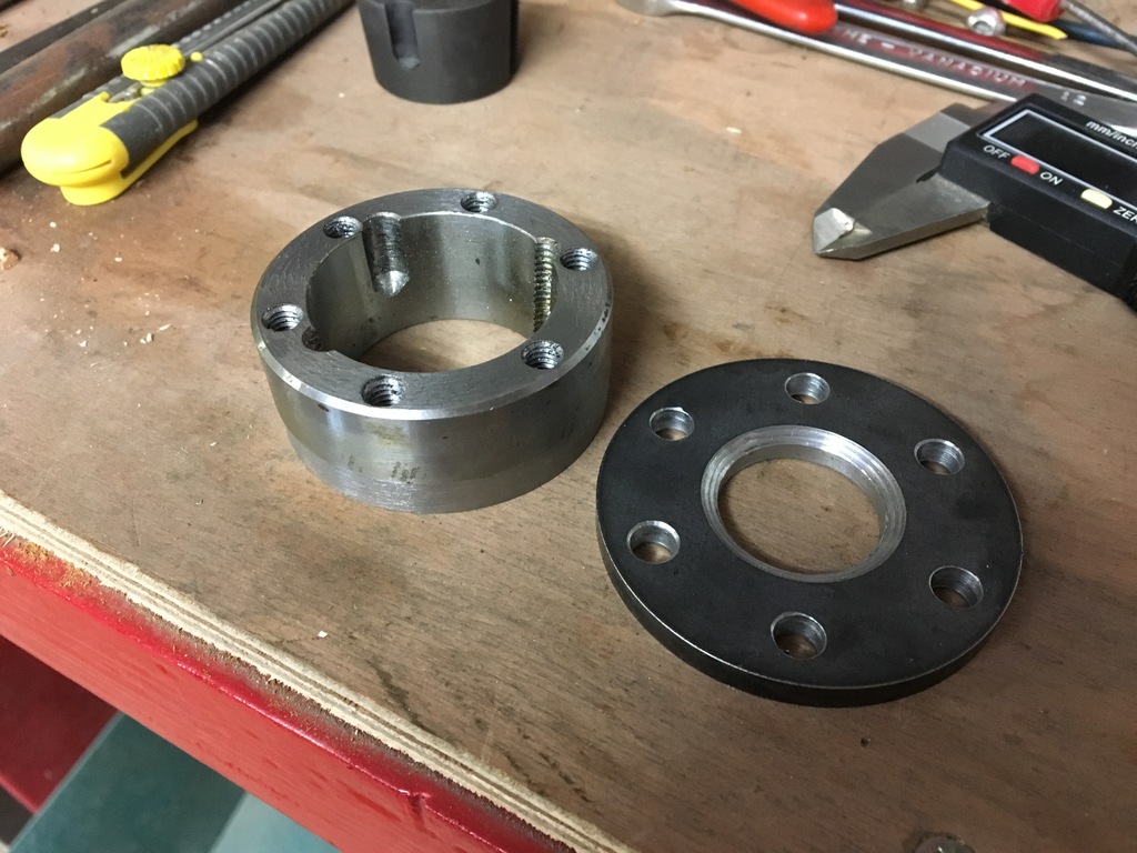

meadowfield 3,179 #28 Posted March 7, 2017 bit of work on the propshaft - a steering column shaft that's telescopic and just about the right scale (mower PTO shafts are rare here in the UK) I've turned the clamp off and added a flange. 9 Share this post Link to post Share on other sites

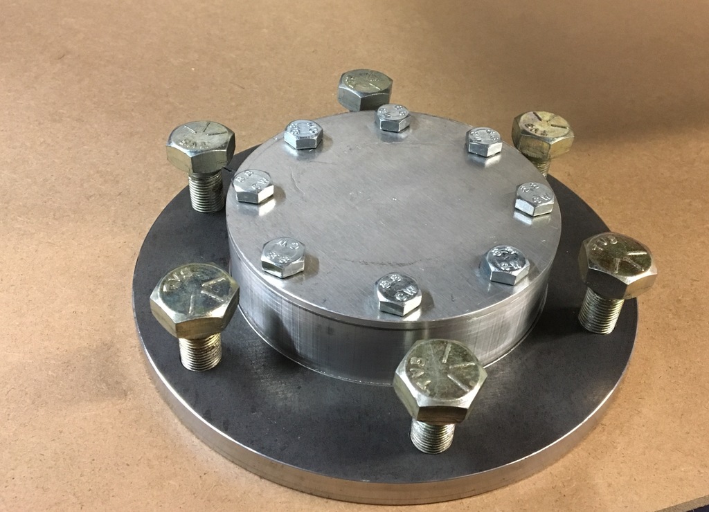

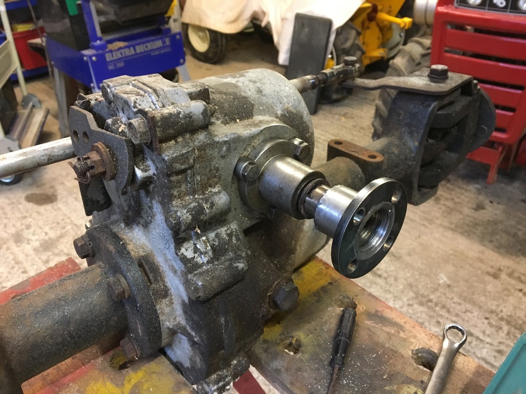

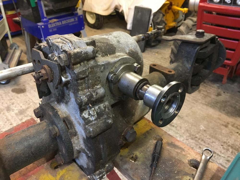

meadowfield 3,179 #33 Posted March 12, 2017 (edited) Finished the adapter and propshaft flanges today. Prop drive works well... Edited March 12, 2017 by meadowfield 4 Share this post Link to post Share on other sites

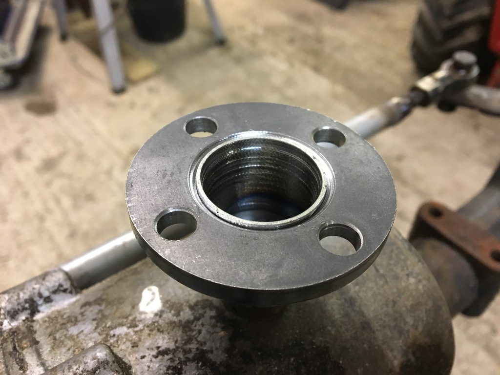

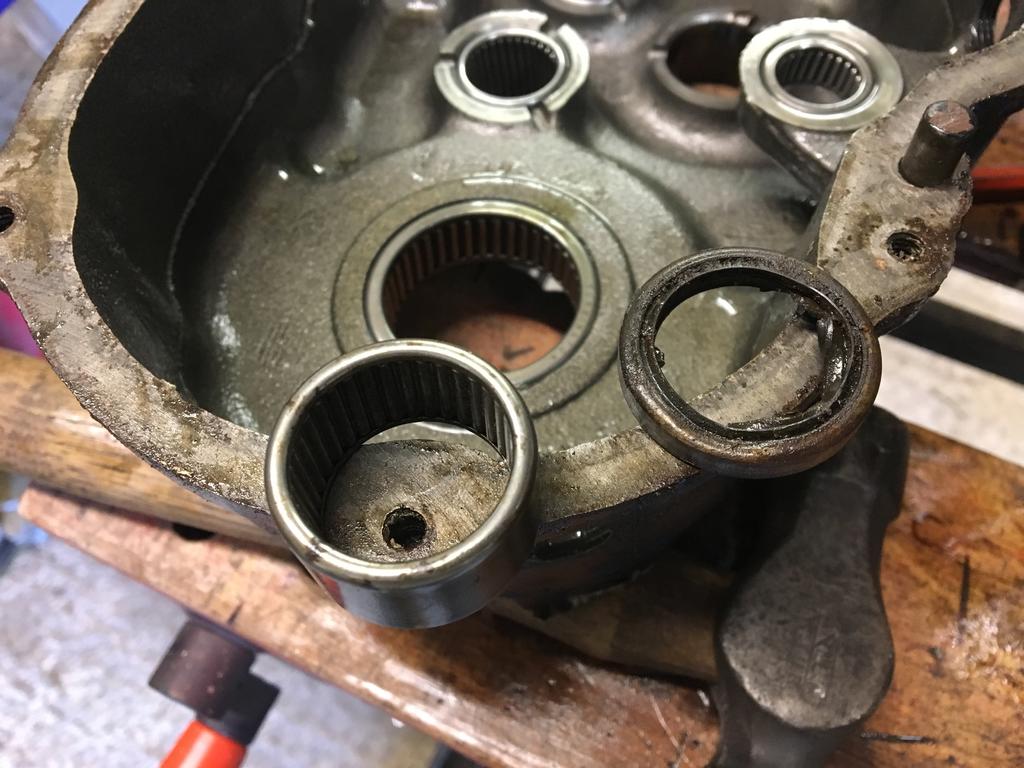

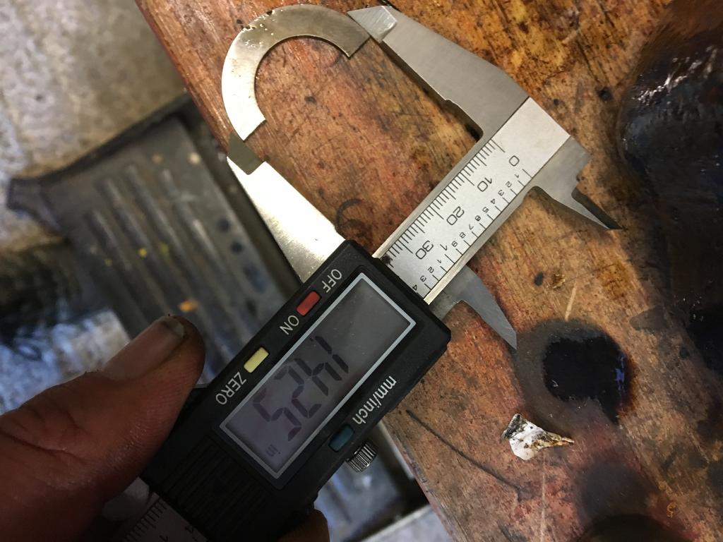

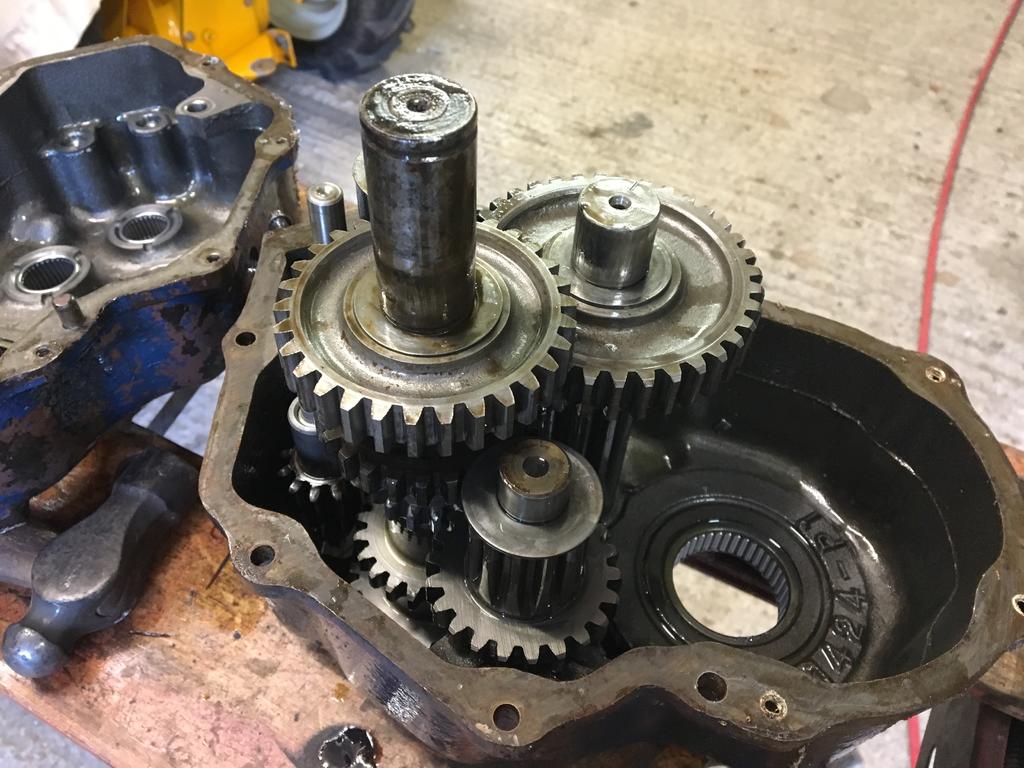

meadowfield 3,179 #37 Posted September 5, 2017 slow progress, due to Ewans RJ rebuild and other jobs. I acquired another peerless 2300 tranny which seemed ok, but split just in case... found lots of metal, a seized brake shaft bearing, two mangled seals and half a shim! I guess thats where all the metal came from - odd thing is, there wasn't a shim missing!!!! So a PO obviously had it rebuilt badly. In pulling the hubs off, I noticed JMC in the castings, so I can now conclude it rear end is from a Jacobsen. Just one more seal to replace, then it's on with the hub adapters and transfer box 3 Share this post Link to post Share on other sites

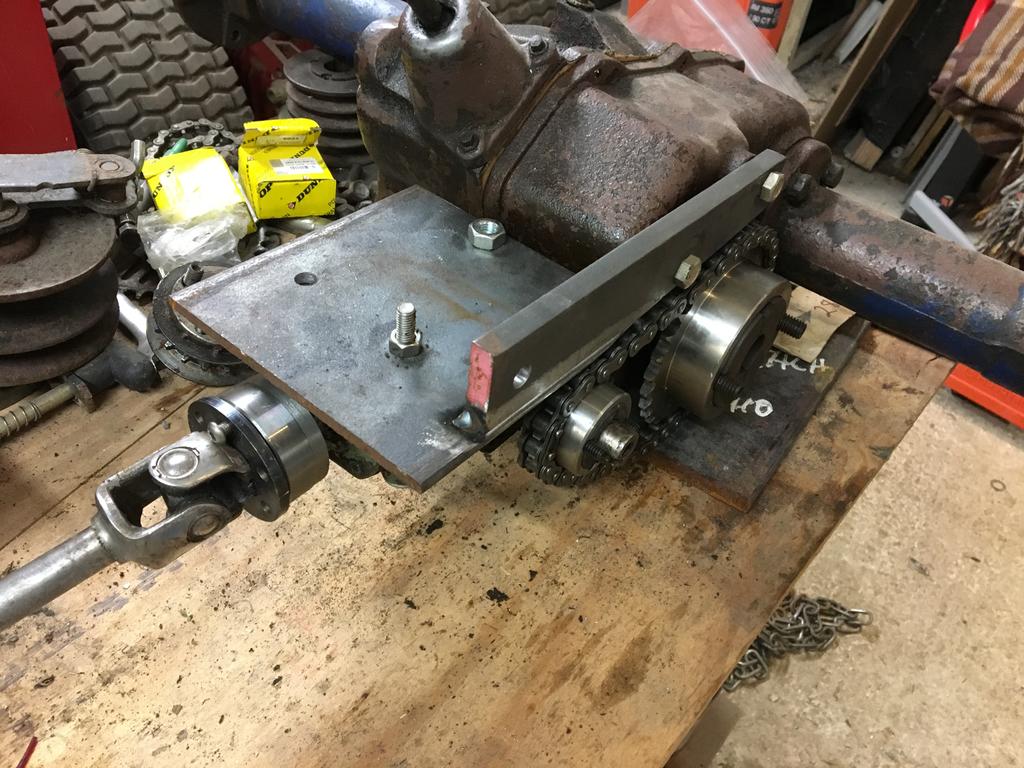

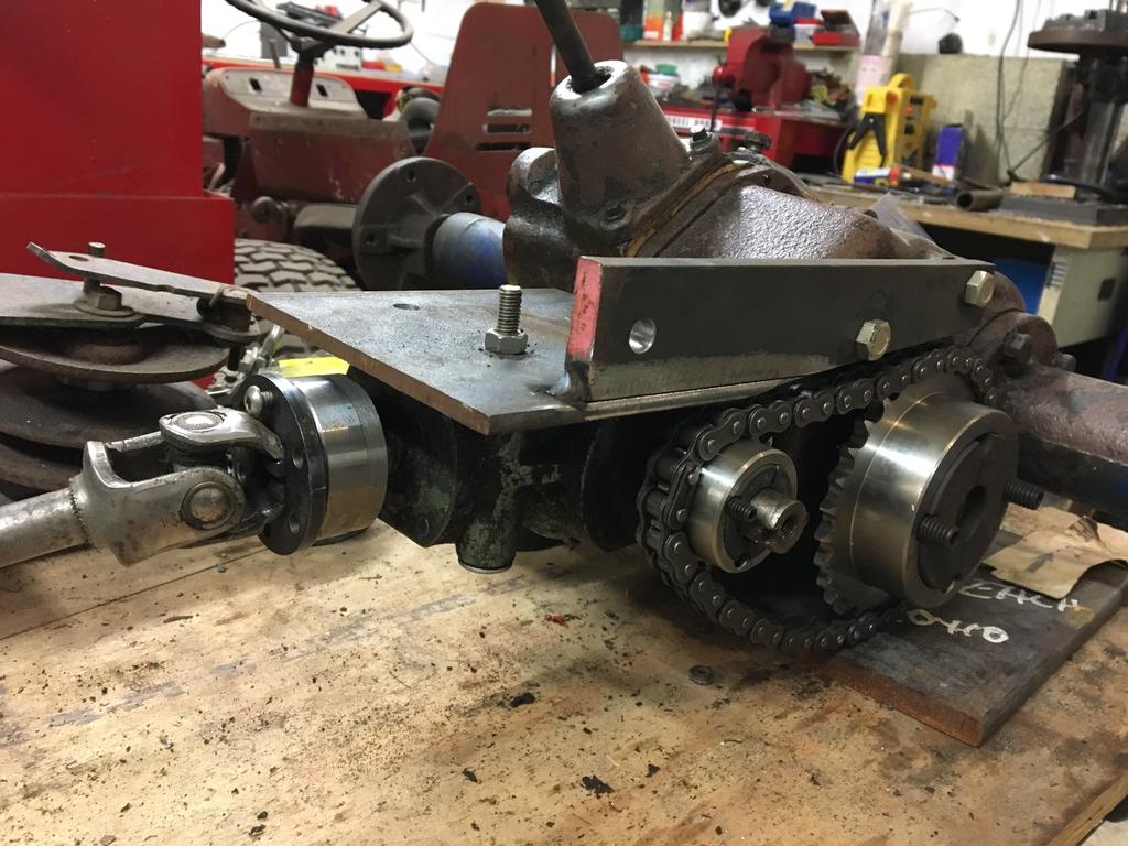

meadowfield 3,179 #38 Posted September 28, 2017 Short update, transfer box almost in situ - a bit of tidying up to do. 5 Share this post Link to post Share on other sites

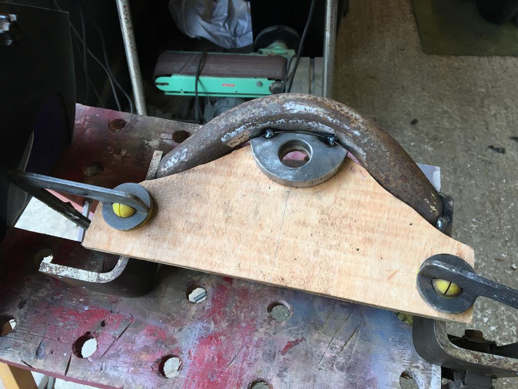

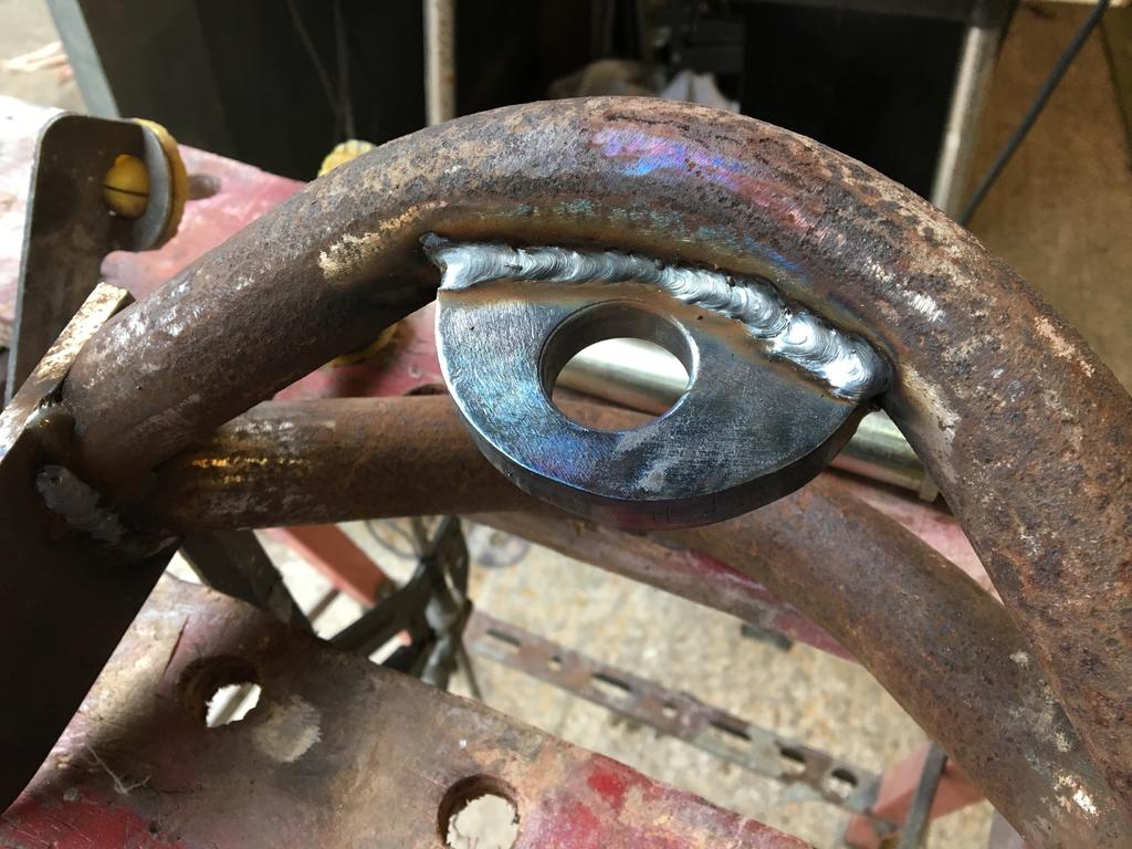

meadowfield 3,179 #39 Posted October 3, 2017 (edited) Back to the front axle, need to get a mount done before starting the chassis. a small piece of ply made the template and gave me a centre point for the pivot. Two pieces of steel tube were repurposed for the mount. a quick zap with the welder - that 1" hole was a pain to drill and how the cradle sites with a cat 3 pin for the pivot. Edited October 3, 2017 by meadowfield 5 Share this post Link to post Share on other sites
