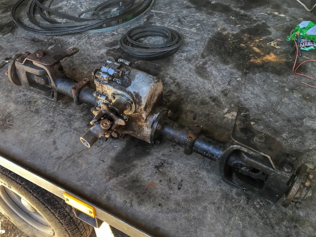

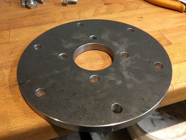

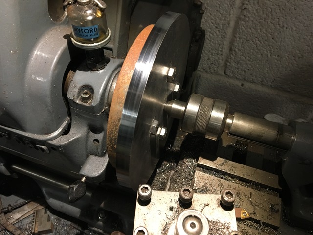

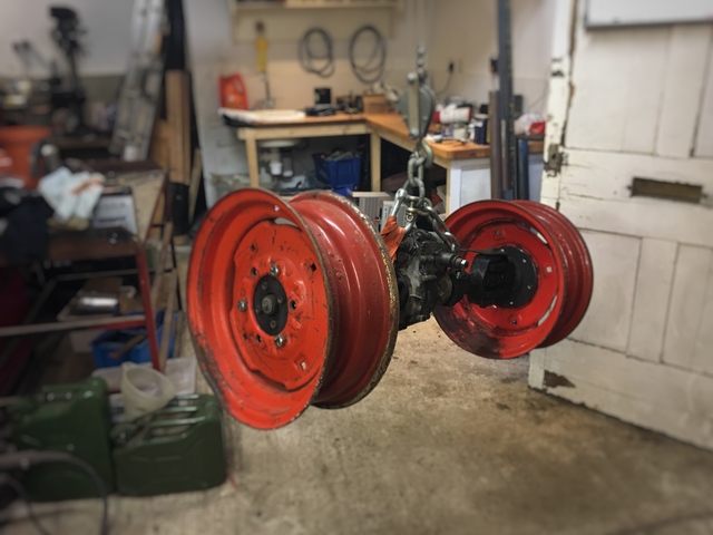

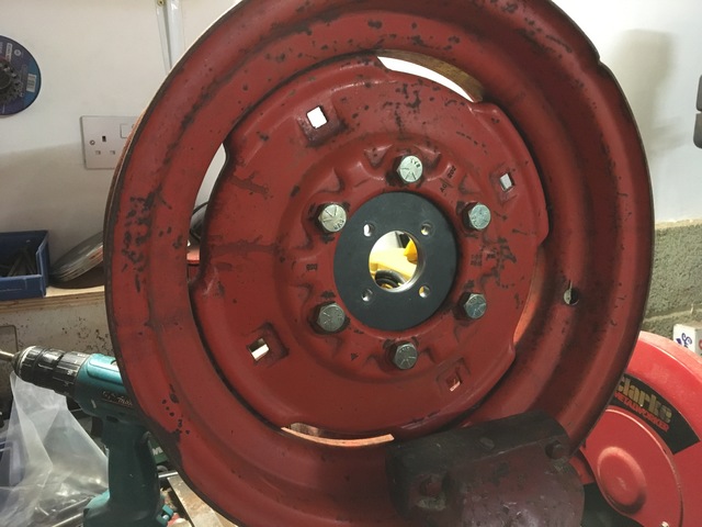

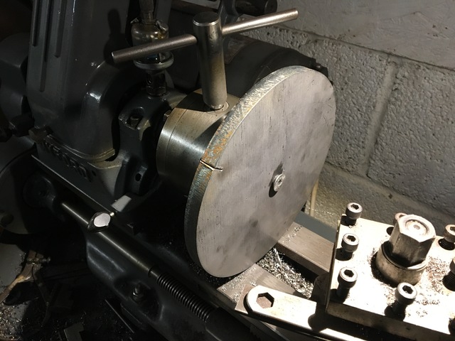

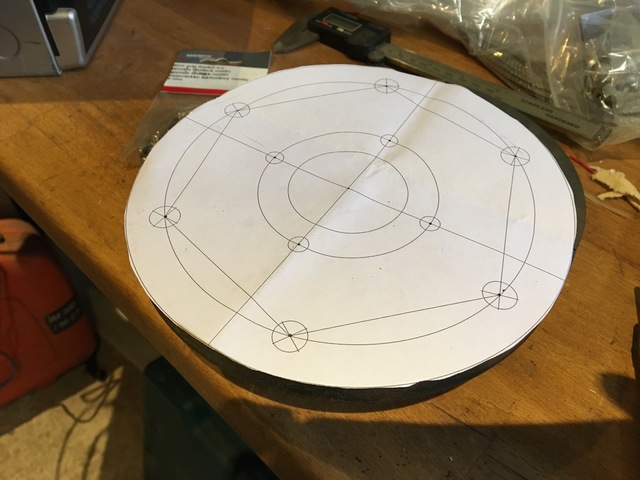

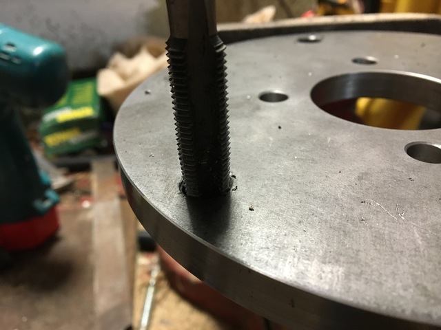

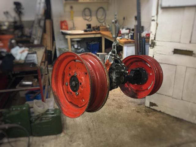

meadowfield 3,025 #1 Posted November 28, 2016 (edited) ...well I've thought about it! It's a about three years since I created C4 and two since Bendy was nearly finished. It's about time I did my third conversion, so here's the build thread. This one is going to be a slow burner, so don't get too excited Here's the main bit... there's quite a bit of work in order to get to a rolling chassis on this one, here's a few more pics 1/2 thick plate steel - laser cut and $10 each. Much easier than using a cutting disc and my template for a wheel adapter. a quick spin in the lathe including wheel! Got another three to make and it's slow work on the lathe Edited November 28, 2016 by meadowfield 16 Share this post Link to post Share on other sites

meadowfield 3,025 #6 Posted November 28, 2016 11 hours ago, C-101plowerpower said: im following, the title reminds me of a mark evans series They were good series! 8 hours ago, 953 nut said: I like the fact that you will be going BIG on the tires. Those rims are 16" 7 hours ago, JC 1965 said: Me too. Please keep the pics coming. Will do! Share this post Link to post Share on other sites
DennisThornton 4,773 #7 Posted November 28, 2016 What's that axle out of? And what's your first thoughts on driving it? 1 Share this post Link to post Share on other sites
Digger 66 3,528 #8 Posted November 28, 2016 1 minute ago, DennisThornton said: What's that axle out of? X-2 ^^^^^^ Those axles must be way pre plentiful across the pond . When I Google for that , I come up with a great big Goose-EGG ! Share this post Link to post Share on other sites
meadowfield 3,025 #9 Posted November 30, 2016 On 28/11/2016 at 11:11 PM, Digger 66 said: X-2 ^^^^^^ Those axles must be way pre plentiful across the pond . When I Google for that , I come up with a great big Goose-EGG ! same axle as Project C4, from an MTD all wheel steer. Taken three years to acquire another one, they are not plentiful. The last one Diggerjames took for his 6x6. Propshaft from the rear will be the preferred method, just waiting for the right bits to show up on that auction site... 2 Share this post Link to post Share on other sites
DennisThornton 4,773 #10 Posted December 1, 2016 This the axle? Rear for the front? And I suppose keep an eye out for Noma all wheel steers 1 Share this post Link to post Share on other sites
meadowfield 3,025 #11 Posted December 1, 2016 that's the one Share this post Link to post Share on other sites

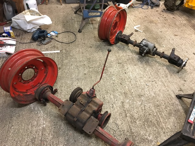

meadowfield 3,025 #12 Posted December 9, 2016 Both adapters done, it's gonna be a beast! best take a look at the rear axle... 11 Share this post Link to post Share on other sites

meadowfield 3,025 #15 Posted December 10, 2016 The axle ratio is 28:1, so incredibly low geared. Half shafts and uj's are up to the job, though the weakest point. Ive been running the same axle on C4 for three years now and that has had some serious abuse. It's the rear wh transmission that's groaning on that as the front drive is taken from the brakeshaft... all this said... I will be testing hard and if I break something I'll go large! I have been looking at small 4x4 axles for years but they are just a little large and dont scale well Share this post Link to post Share on other sites
C-101plowerpower 1,606 #16 Posted December 10, 2016 15 hours ago, meadowfield said: Both adapters done, it's gonna be a beast! best take a look at the rear axle... wait wait wait what? those are the fronts? this is gonna be one big tractor 1 Share this post Link to post Share on other sites

meadowfield 3,025 #19 Posted December 26, 2016 (edited) Dug out the rear axle, a 4 speed with independent drum brakes. I think it came from a Toro walk behind. I also think I might have to split it and take a look as there's no reverse it it matches the track of the front axle nicely Edited December 26, 2016 by meadowfield 4 Share this post Link to post Share on other sites

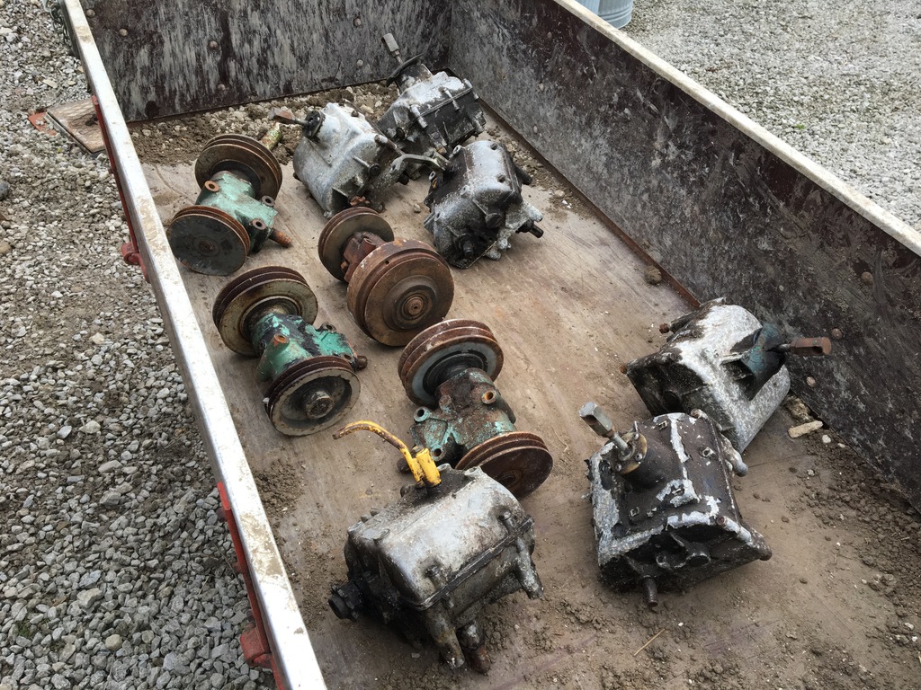

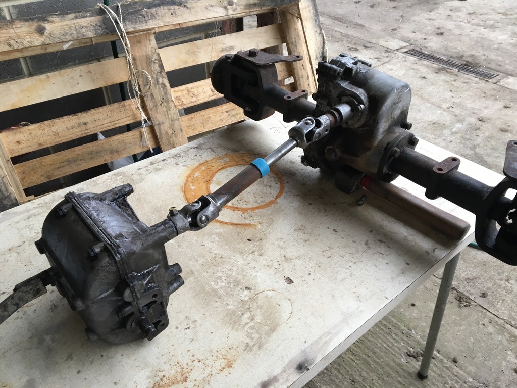

meadowfield 3,025 #24 Posted February 18, 2017 Like I said.... slow burner... a few bits turned up over the last month on that auction site. A few hundred quid later, 300 miles, a hotel stay, etc I came home with this lot! The idea being I need to design a drop box between the rear and front axle. Plan A was a right angle box, but then I thought I could go more compact and get the gearing in with a small peerless box. Heres a dry run of the current thoughts. I need to get a rear rear axle on the bench to look how things might join up and fit a little better.... 7 Share this post Link to post Share on other sites
