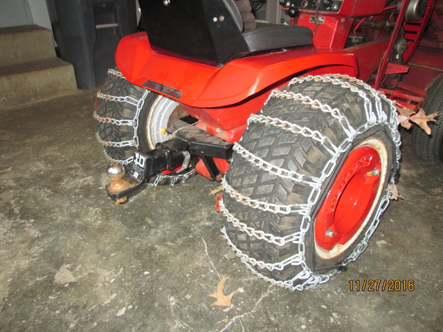

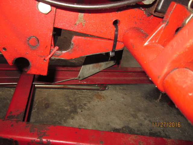

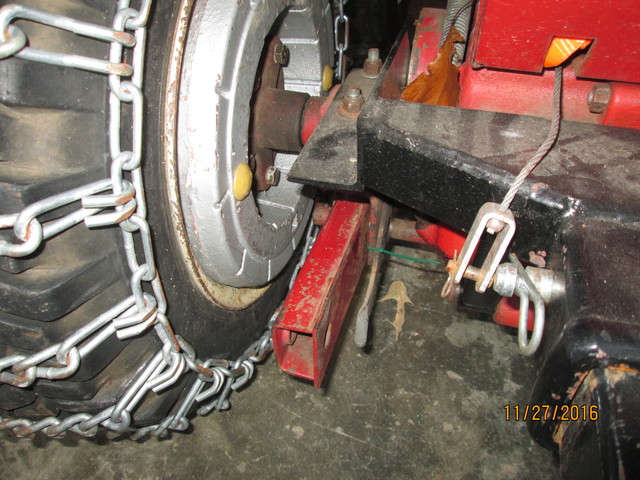

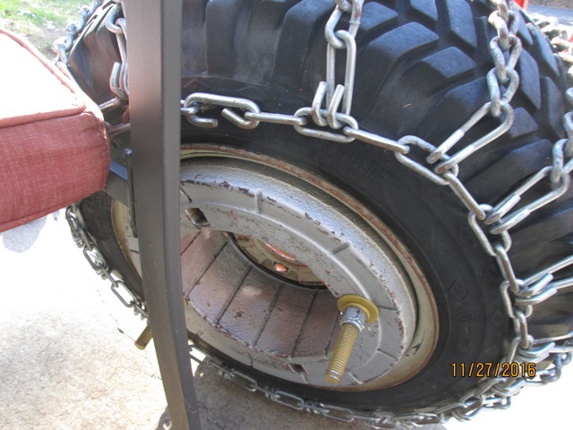

857 horse 2,588 #1 Posted November 27, 2016 (edited) Well..Ed Kennell and West Virginia Hillbilly......I wanna thank you both for the insightfull wheel weight class,,,,,, today i mounted my plow and did the dual weight thing......Wheel Horse weights on the inside,,and my Bolens weights out side....11 inch bolts hold both sets on.// I use zip ties to keep the rear attachment clamps shut....and the same with the front one....or my plow hits it and dont stay up......all greased and air is adjusted,,, .Locking nuts were used,,,,,i zipped of the 1 1/2 of the 12" bolts i used... Edited November 27, 2016 by 857 horse Remember MASH POLE TIME IS Approaching 12 Share this post Link to post Share on other sites
Sparky-(Admin) 23,932 #2 Posted November 27, 2016 I would never have thought the WH weights would fit the inside. Are those not actuall WH rims with the usual offset? Mike.... 3 Share this post Link to post Share on other sites
857 horse 2,588 #3 Posted November 27, 2016 (edited) Mike....they are 8 inch wide rims,,,,,,and thanks for reminding my foggy head.....there are 2 inch spacers hiding in behind the rims... Edited November 27, 2016 by 857 horse 6 Share this post Link to post Share on other sites
Ed Kennell 43,573 #4 Posted November 27, 2016 Looks like you're ready Howard. You might want to cut those bolts off before you scuff up your purdy shins. 4 Share this post Link to post Share on other sites
cschannuth 3,819 #5 Posted November 27, 2016 Where are your valve stems? If they are on the inside do the 2" spacers provide the clearance they need? 2 Share this post Link to post Share on other sites

857 horse 2,588 #7 Posted November 28, 2016 the first pic is the finished product,,,,,,AFTER i bolted everything together ,i realized i needed to turn the bolts around,,,then i cut off the extra... and the valve stems can be reached thru a cut out in the red weights....you can just make out the acess at the bottom of the weight!! 3 Share this post Link to post Share on other sites

857 horse 2,588 #12 Posted November 28, 2016 Just saw 2 questions.....here goes....... question 1 did I have help stacking all the weight.?? No....i used those 12" long bolts with the square end to lock in the weight...laid one weight on the ground...stacked on a wheel.....added the next weight....the bolts are so long everything just lays on the driveway until I tighten the nuts onto the bolts after that..i jjust cut off the ankle biters..and leaned them onto the hub adapters.. ..question 2 ....why the 2" spacers ?...the wheels are an inch wider than stock...and without the spacers the snow chains used to hit the snow blade frame..i think now.....1 inch spacers could have worked...even with the inner weights,,,,i fits pretty good.... On a side bar......i did get a text on my phone....from old Red Rider.....if i get a flat.....dont call him.....use triple AAA....lolololol I have a new cutting edge....going on Saturday.....and Im gonna give the #40 chain on the front tires a try...class's welcome,,,and your input is always obliged,,,,, 953 Nut says he has somthing new for the Mash Pole......as Many recall,,AMC Rulz used a Solar Powered Beacon last year..... ..... 5 Share this post Link to post Share on other sites
