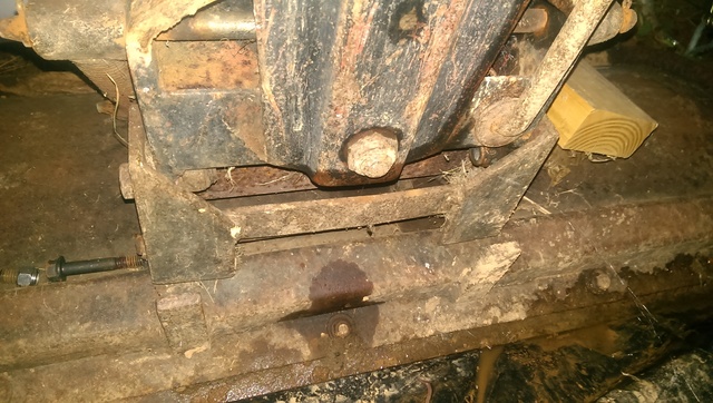

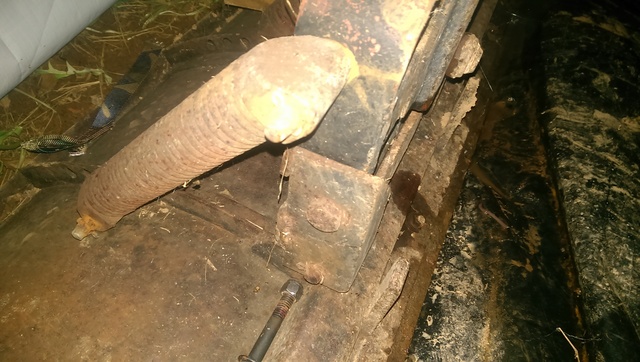

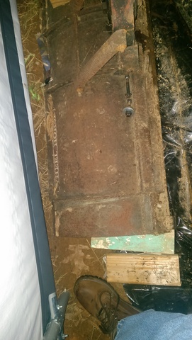

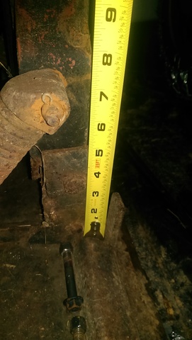

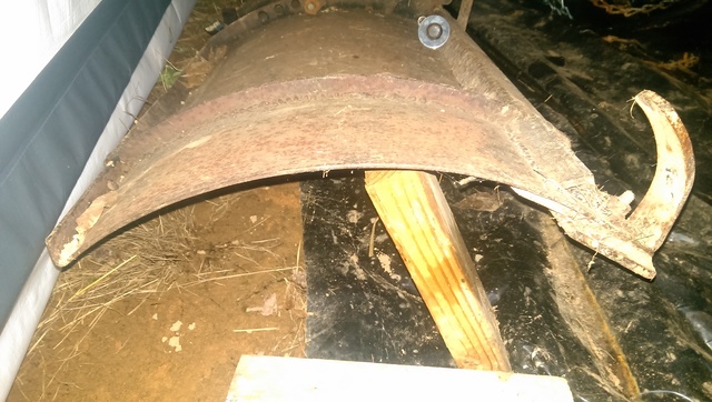

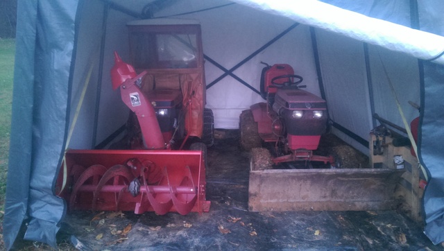

WVHillbilly520H 10,379 #8 Posted November 27, 2016 (edited) 15 minutes ago, 608KEB said: So a 42" plow won't work on a 520H with swept axle without the extension? Will the blade hit the front tires when angled? Yes when angled it hits the front tires unless you extend the blade frame with the kit or the cheap way I did it, by adding a 3-4" extension(I used angle iron) between the angle head and mold board where the retaining pin is, also when the 42" wide is angled the snow/dirt/ect will exit right into/under the tire it's angled to I had to add extensions to to the mold board as well it now measures 50" wide, Jeff. Edited November 27, 2016 by WVHillbilly520H 3 Share this post Link to post Share on other sites
