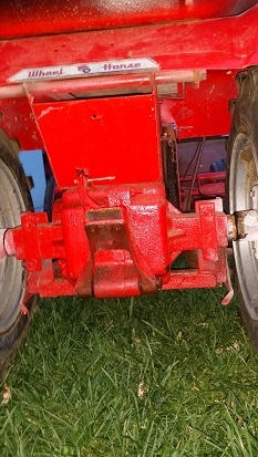

cafoose 3,882 #1 Posted November 27, 2016 I have a 1968 Commando 8 and I tried to put my 876 blade on it and the rear frame touches the inside sidewalls of the Commando rear tires. I found out later when I measured it the 876 rear wheels are 4 inches further apart than the Commando. What type of blade does the Commando use? Are they hard to find? The commando already had the rear blade mount on it when I got it. Share this post Link to post Share on other sites

953 nut 69,842 #3 Posted November 27, 2016 5 hours ago, cafoose said: 876 rear wheels are 4 inches further apart than the Commando Are the rims on the Commando inset rather than outset? You may be able to turn them around and get a bit more width out of them. 1 Share this post Link to post Share on other sites
cafoose 3,882 #4 Posted November 27, 2016 4 hours ago, 953 nut said: Are the rims on the Commando inset rather than outset? You may be able to turn them around and get a bit more width out of them. I don't know I have to go out and check never thought of that. 1 Share this post Link to post Share on other sites

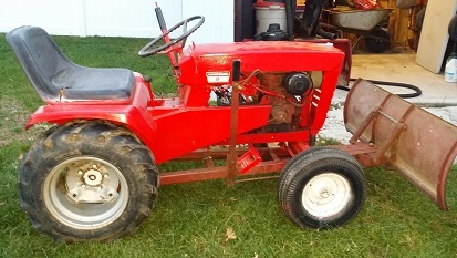

cafoose 3,882 #5 Posted November 27, 2016 I just measured both the 876 and the Commando. From one end of the case to the other end on the Commando it measures 20 1/2 and on the 876 it measures 22 1/2 so the trans-axle is 2 inches wider on the 876 . The Commando is a 3 speed and the 876 is a hydro. I have a set of ag tires on rims that have a 1 1/2 inset on the inside from the sidewall to the center of the rim. The tires on the Commando and the 876 have a 2 1/2 inset. I'm thinking if I put the ags on the Commando the blade will work. 1 Share this post Link to post Share on other sites
cafoose 3,882 #6 Posted December 3, 2016 I just put the ag tires on the Commando 8 and the 876 blade went right on and works great! for your help everyone that's what makes Red Square so great! 2 Share this post Link to post Share on other sites
