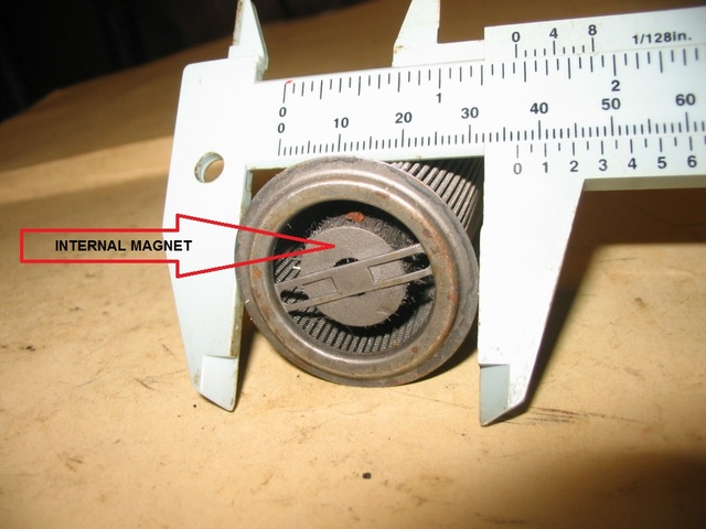

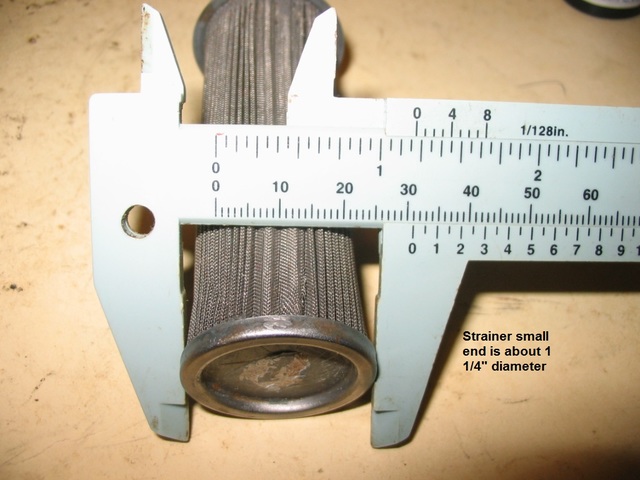

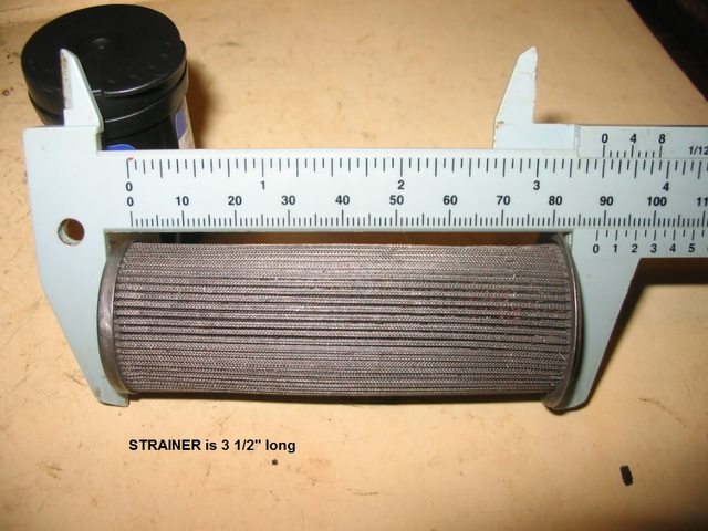

daveoman1966 3,873 #5 Posted November 26, 2016 For anyone in need, I have a SCREEN STRAINER as in these pics....Size it up to yours and send me an email if in the market for a good used one. my direct email is: daveoman@windstream.net 1 Share this post Link to post Share on other sites

R. L. Addison 299 #8 Posted November 26, 2016 These are epoxied originally and the heat and oil release the epoxy over the years and then they can come apart. 17 hours ago, daveoman1966 said: For anyone in need, I have a SCREEN STRAINER as in these pics....Size it up to yours and send me an email if in the market for a good used one. my direct email is: daveoman@windstream.net Share this post Link to post Share on other sites
R. L. Addison 299 #9 Posted November 26, 2016 That is the style I've seen in hydrogear units (pre 1974 piston pump>gear motor) and particles of steel can be pulled by the magnets, and I scrapped a couple of those that the steel splinters got into the motor part & ate up the gears & pockets. Share this post Link to post Share on other sites
daveoman1966 3,873 #10 Posted November 27, 2016 The screen shown has done exactly what it is there for....to trap micro fine metal (steel) filaments before being pumped thru the hydro system. I, too, have found internal piston slippers and brass plates torn up by metal shavings. (High-pressure air and some carb cleaner will blow away these micro-filaments.) These can usually be resurfaced with 400-600-1000 grit emery paper to restore hydro pressures / performance. I have done just that on several Sundstrand units that I've rebuilt over the years...both piston-to-piston (90-1136, 376, 40) and the older Hydrogear (90-2046, 2062) styles. Any owner has to be cautioned to avoid the PANIC STOP of pulling UP on the parking brake lever as this action causes the Parking Pawl to bang into a internal gear, eventually wearing away either of both parts....that's commonly the source of the steel micro-filaments. Another source of debris is being careless when topping off the reservoir fluid ...getting dirt into the system. In any case, this is the screen filter I have if anyone is interested. My direct email is: daveoman@windstream.net 1 1 Share this post Link to post Share on other sites
