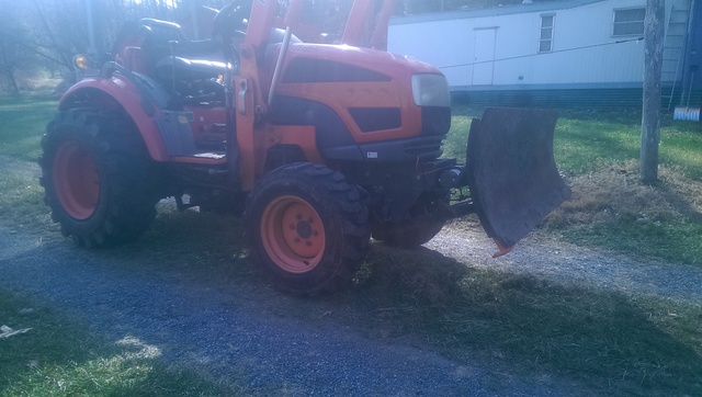

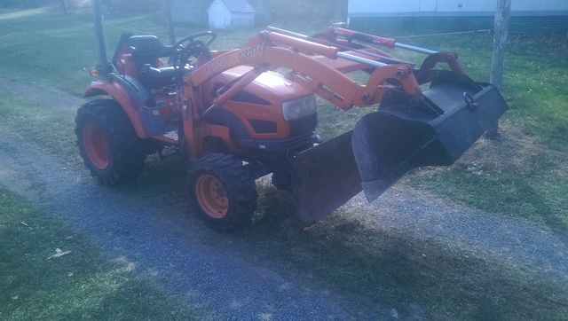

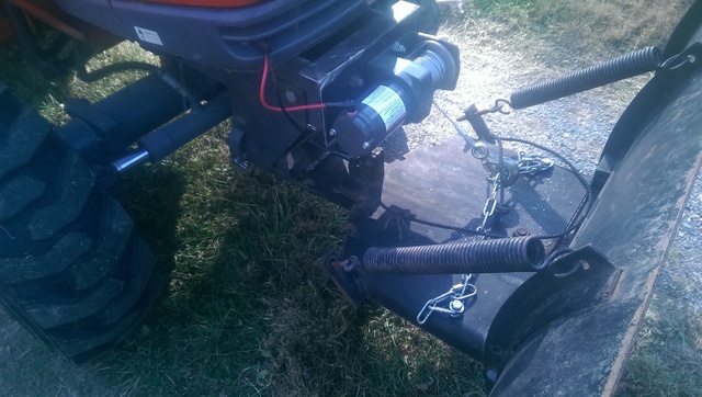

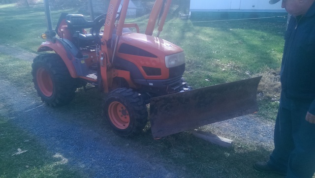

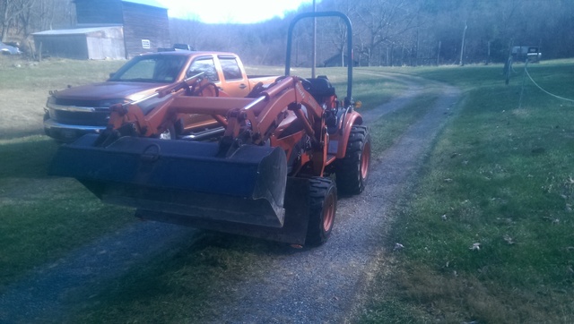

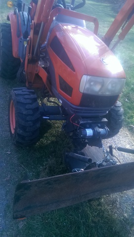

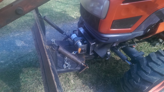

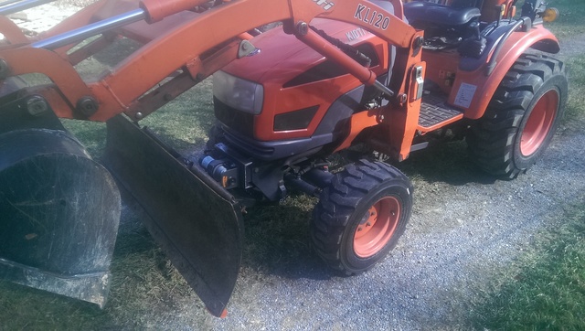

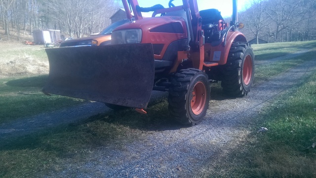

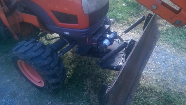

WVHillbilly520H 10,377 #1 Posted November 24, 2016 So I have a Kioti CK20 I leave in WV for my dad to plow the 1/4 mile long dirt/stone driveway ,he has been using a rear 3pt mounted blade but in January the 30" didn't push/pull well or scoop easily either so figured a front mounted plow may work better for him since he doesn't turn around very good to see what's going on behind him, I picked up a Power King Economy 54" front plow blade and modified it to fit/work on the Kioti without removing the loader then using a Harbor Freight ATV winch to raise and lower it while still maintaining the hydraulics for the loader and rear 3pt, Jeff. 20 Share this post Link to post Share on other sites

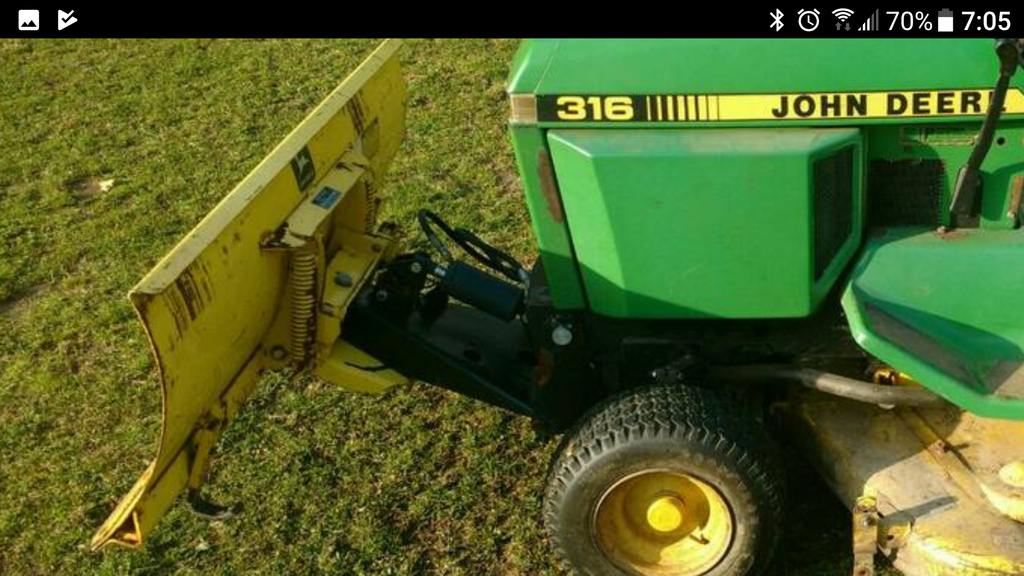

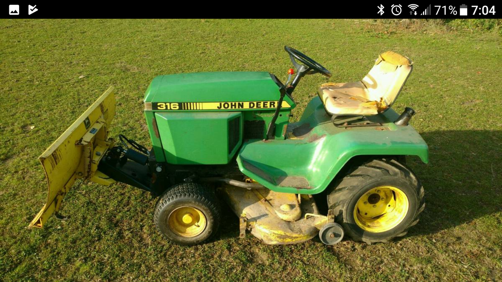

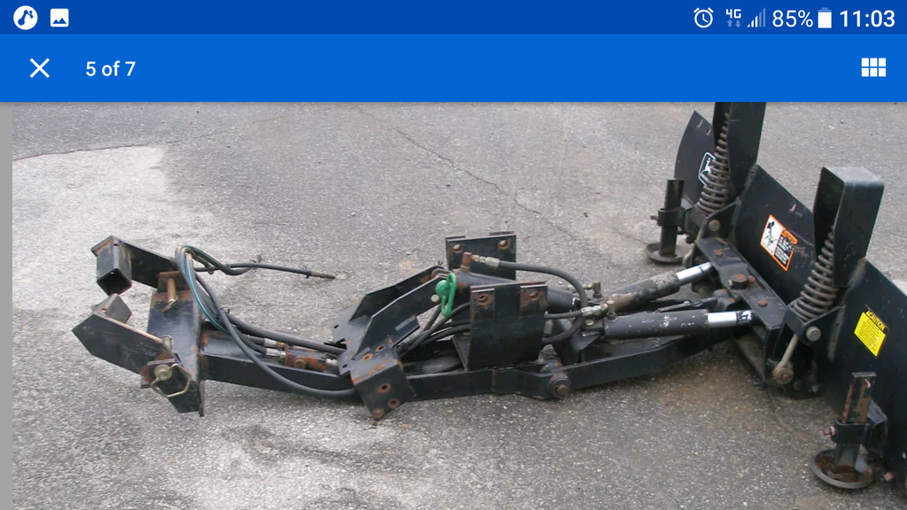

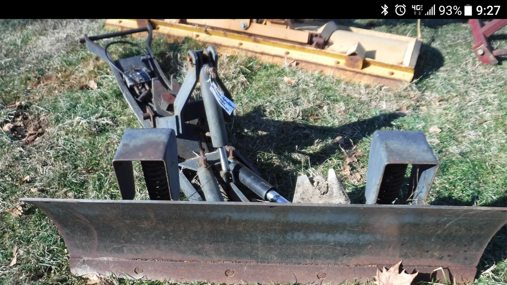

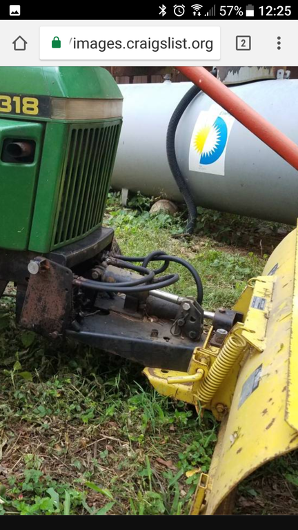

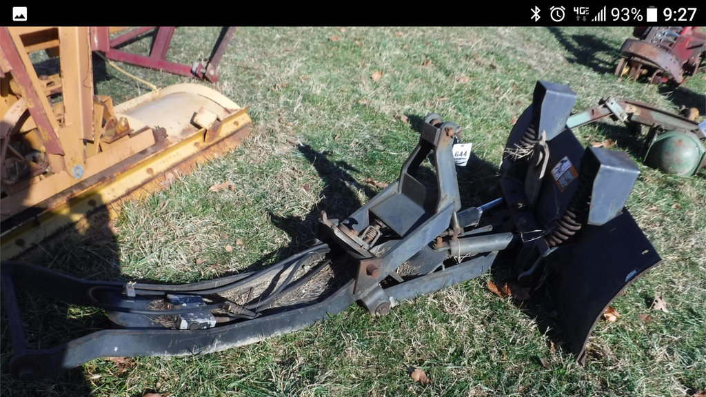

WVHillbilly520H 10,377 #5 Posted November 6, 2017 It's been almost a year since I posted this and dad nor I ever really used it to push any snow, just didn't get enough of the white stuff last year, so with that being said I really wanted to go all hydraulic for this machine and patience has prevailed I finally found what I really wanted locally and at real good price $400 for a John Deere model 390 going for over $1500 on right now(don't go all fussy it ain't green ) full hydraulic front dozer blade that I'm going make fit and function on this little orange beast, keep a watch for more pics as get this installed and functioning, Jeff. 4 1 Share this post Link to post Share on other sites
Pullstart 68,557 #6 Posted November 6, 2017 I imagine that long frame and the parallel A frame will be a great addition... not knowing how much of that you'll keep I guess. Share this post Link to post Share on other sites

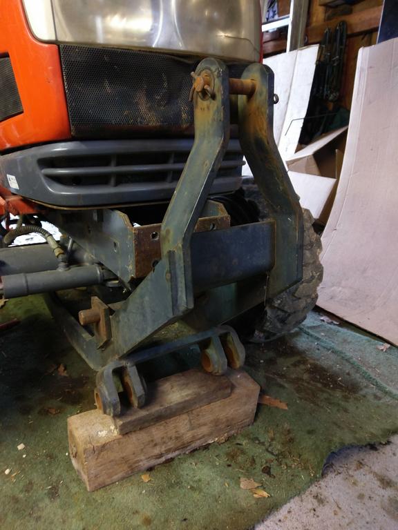

WVHillbilly520H 10,377 #7 Posted November 6, 2017 1 hour ago, pullstart said: I imagine that long frame and the parallel A frame will be a great addition... not knowing how much of that you'll keep I guess. Going to try and adapt the whole system as pictured, they were originally designed for the 770,870 ect series JD compact tractors so it "should" be a straight forward swap with some fabracation for the mounting brackets. 1 Share this post Link to post Share on other sites

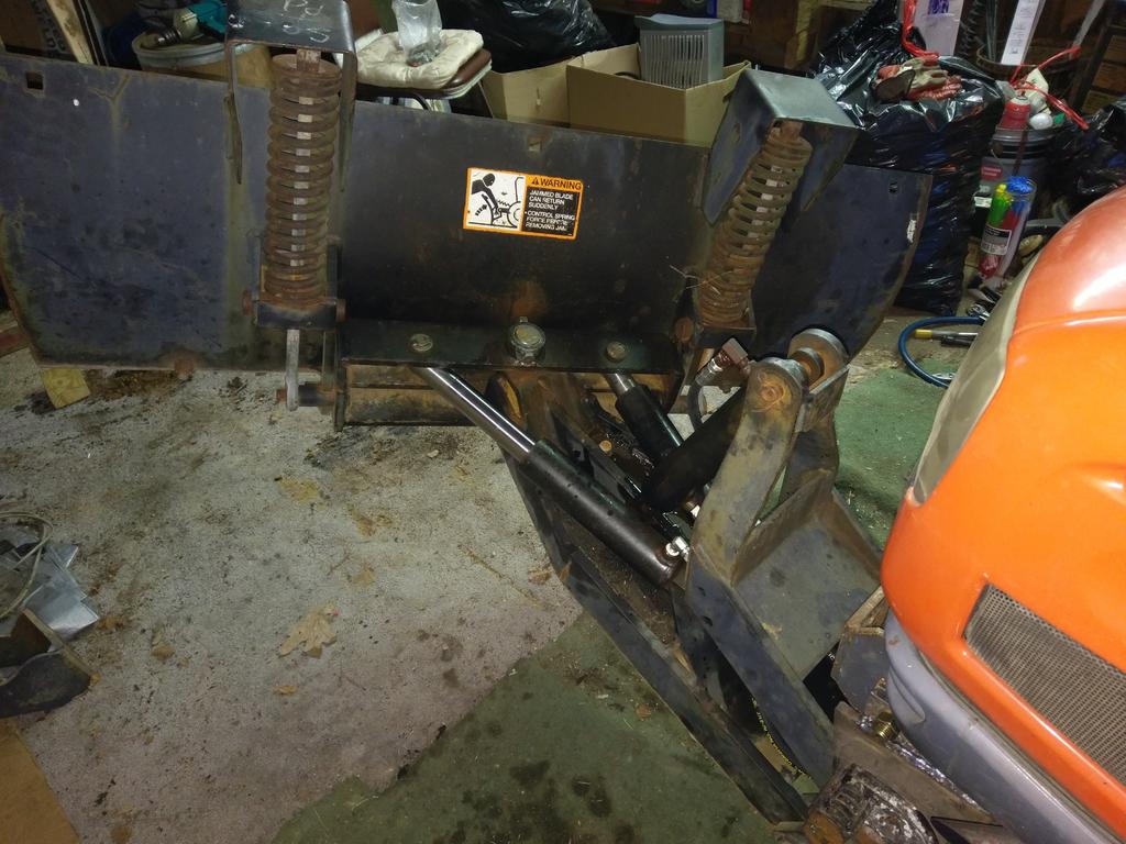

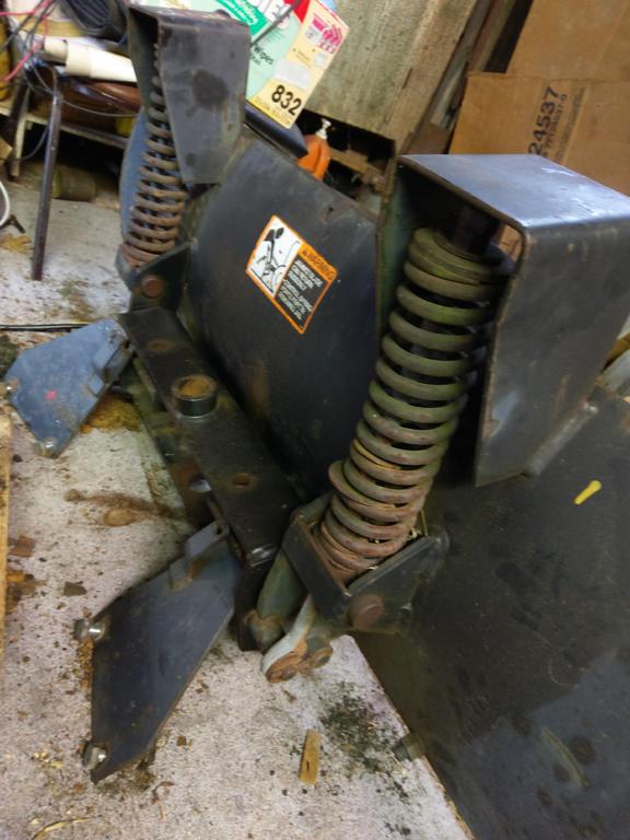

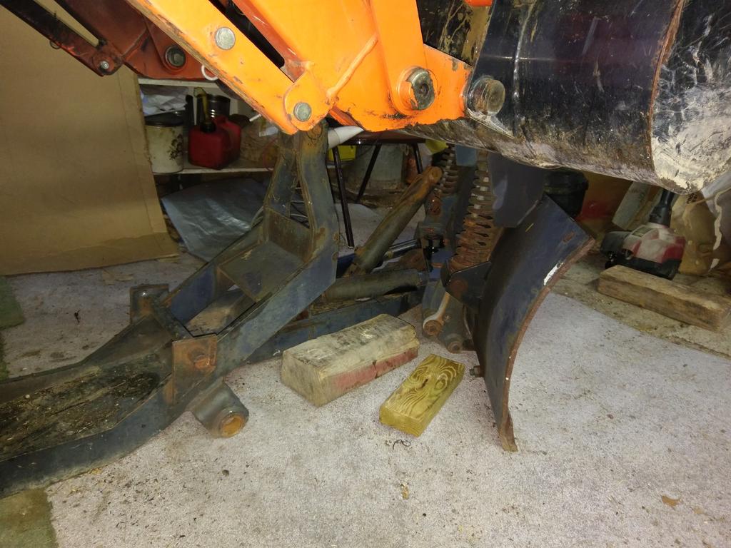

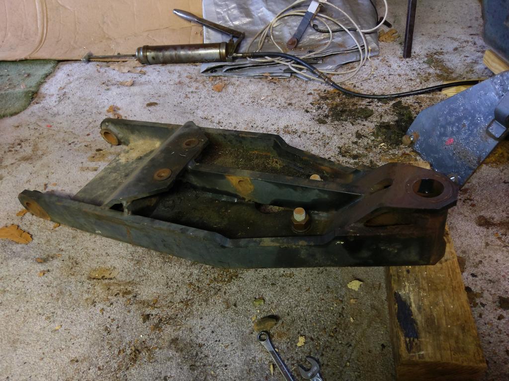

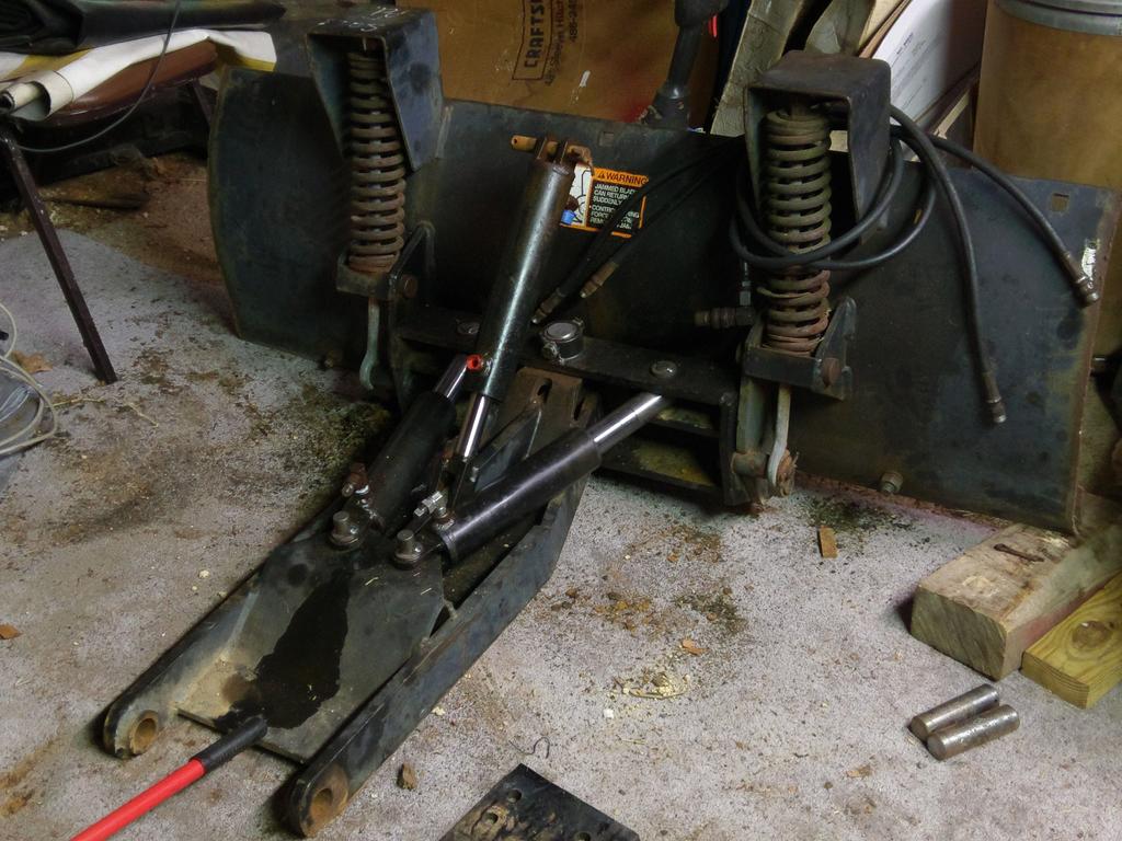

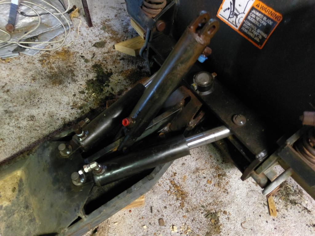

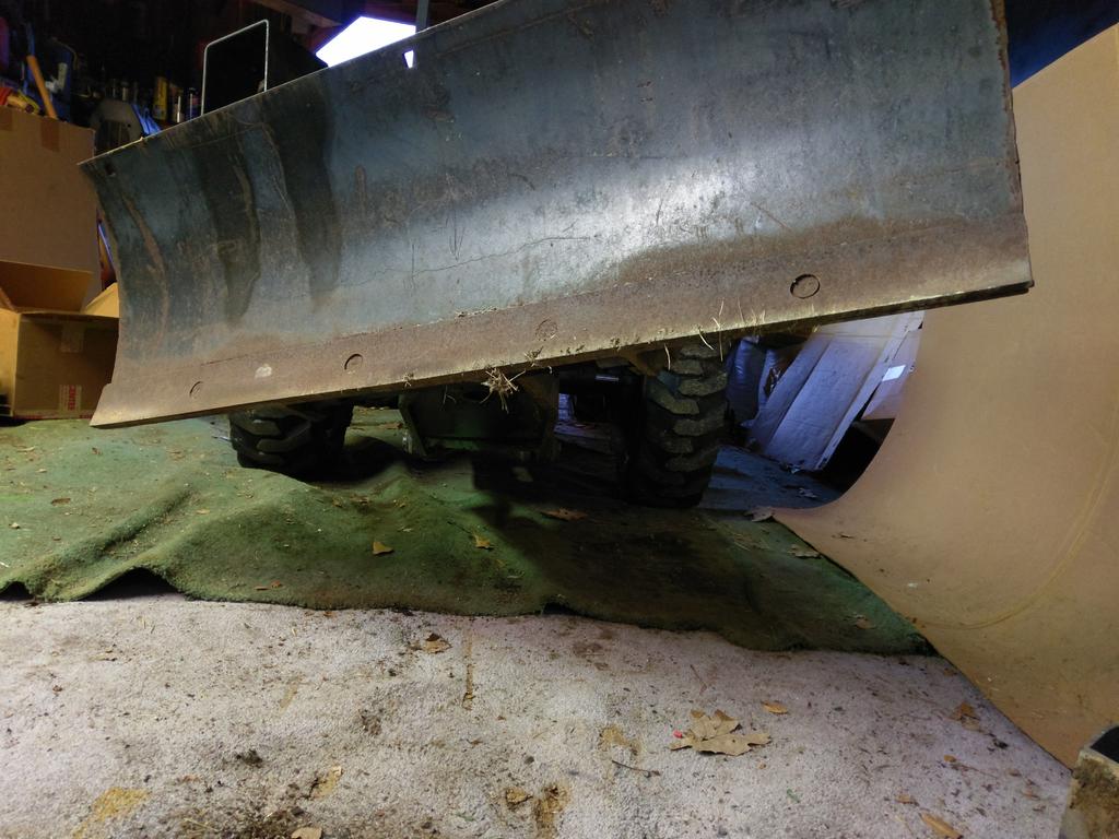

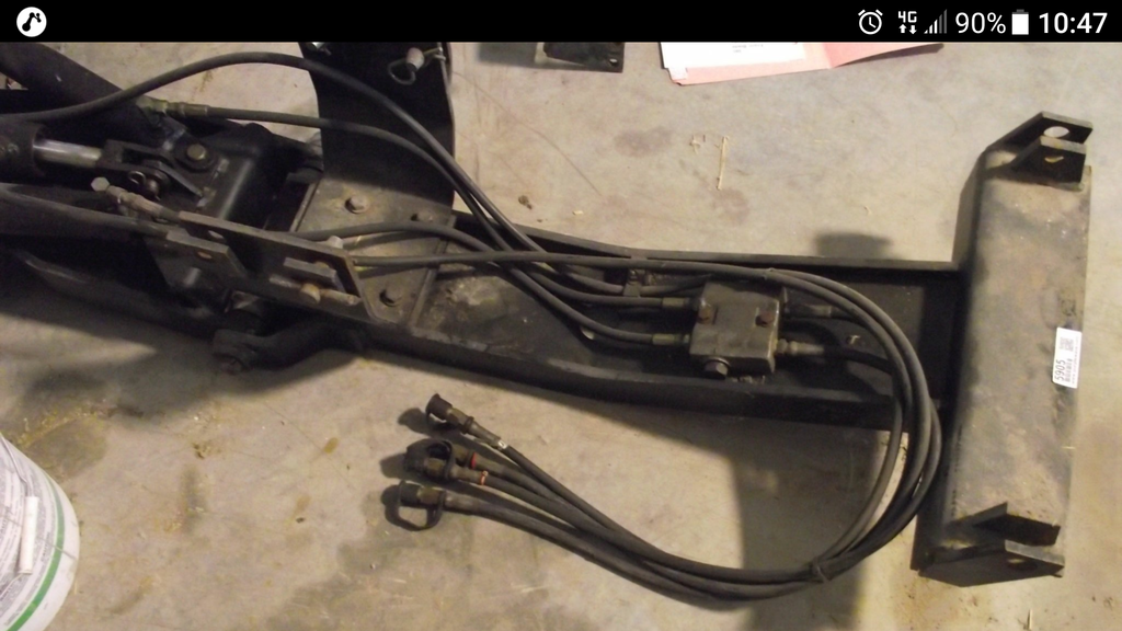

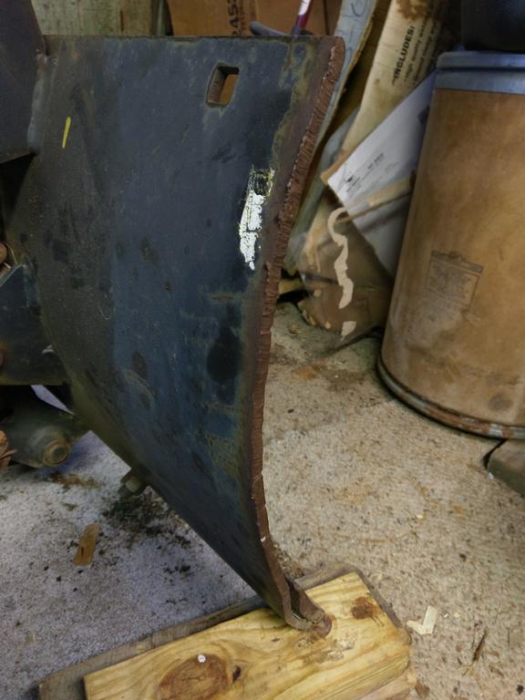

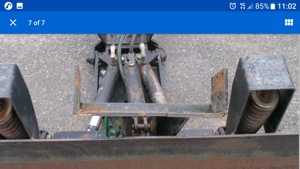

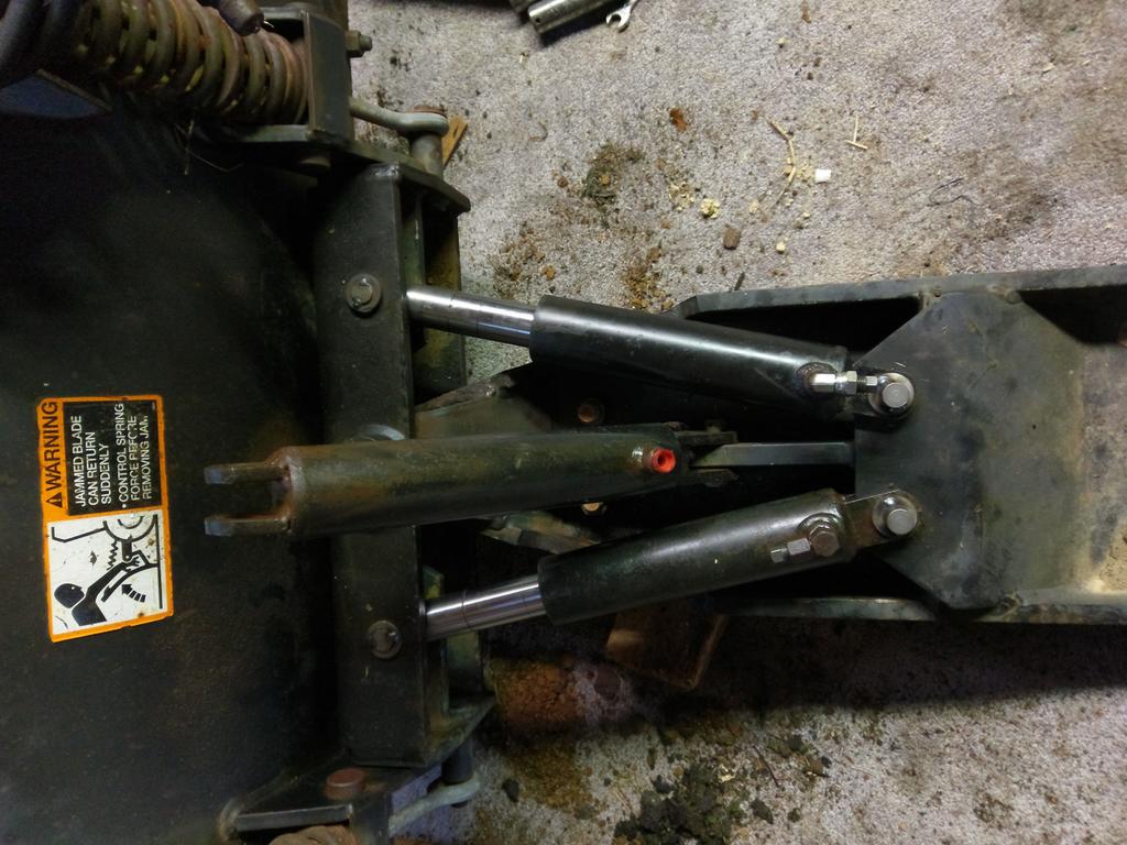

WVHillbilly520H 10,377 #8 Posted November 18, 2017 Made a little progress on my new snow plow adaptation/mounting shouldn't be to bad to fab up some sub-frame mounting brackets that will work/function like it was made for it, this thing is built like a take sub-frame is all 1/2" thick with 1.125" pins (manual says 725lbs for the whole assembly), definitely needs new hoses and quick couplers to fit the Kioti, any help from the hydraulic gurus would be greatly appreciated, there's an aluminum block bolted to the blade sub-frame that the hose go through to the dual angle cylinders what's its purpose? (I'll get a pic of it up later if it helps or same as 1st screenshot) ...(refer to pics above and last 2 screenshots)also the angle cylinders only have one fitting/hose is this what they call single acting? and also one is extended the other retracted and after pulling the old hoses I still can't get them to move/budge is this OK or a problem? The lift cylinder has two fittings/hoses double acting? but with hoses removed it moves freely with minimal effort again OK or a problem, thanks Jeff. 1 Share this post Link to post Share on other sites

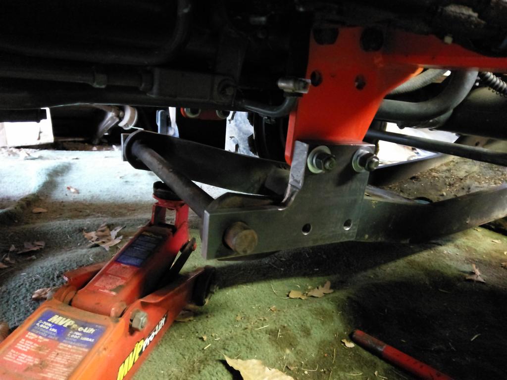

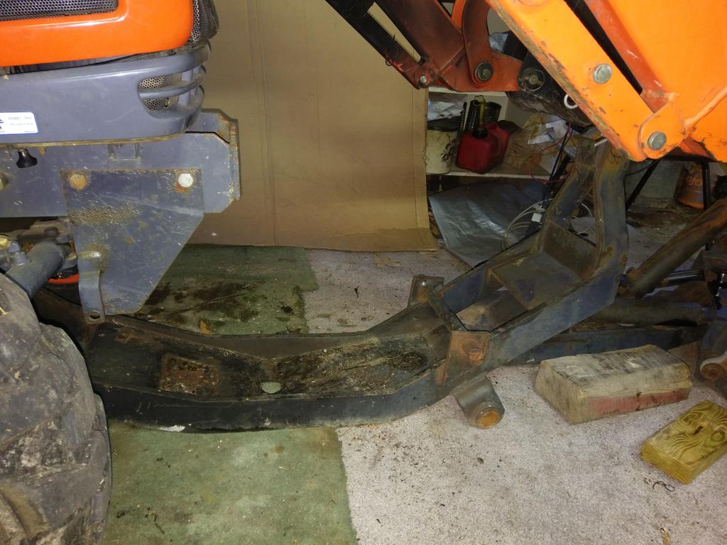

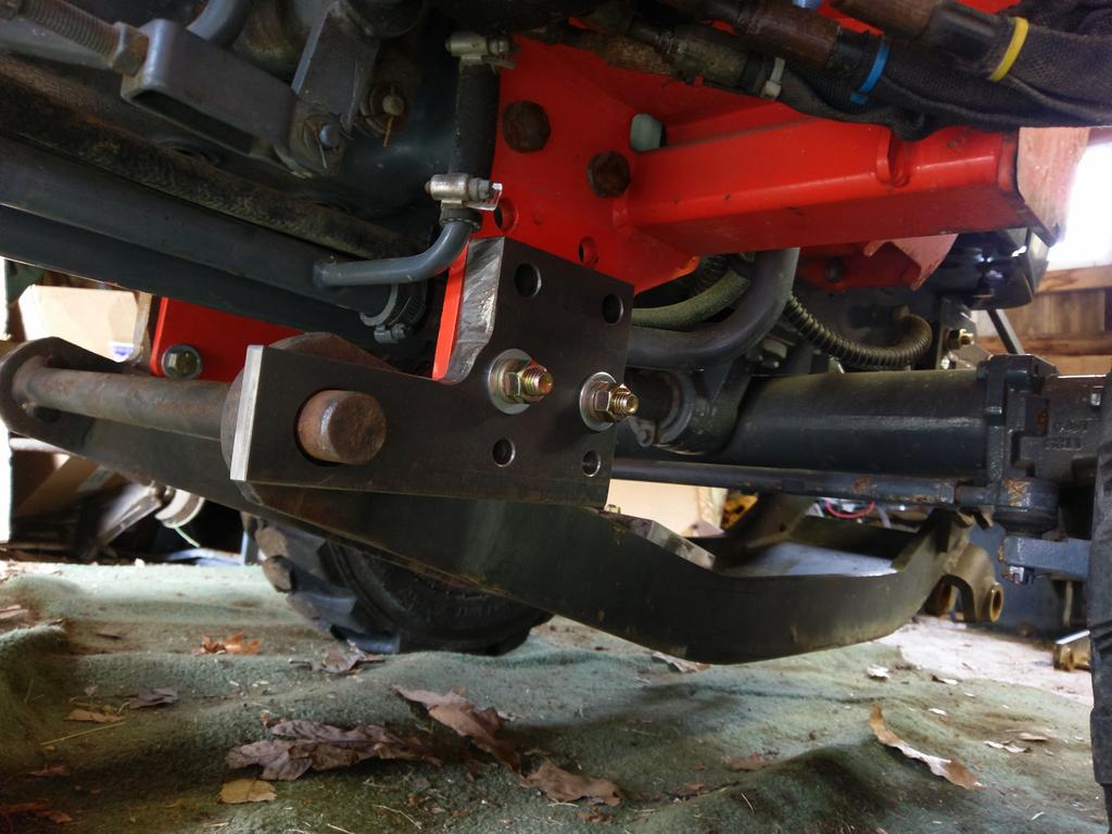

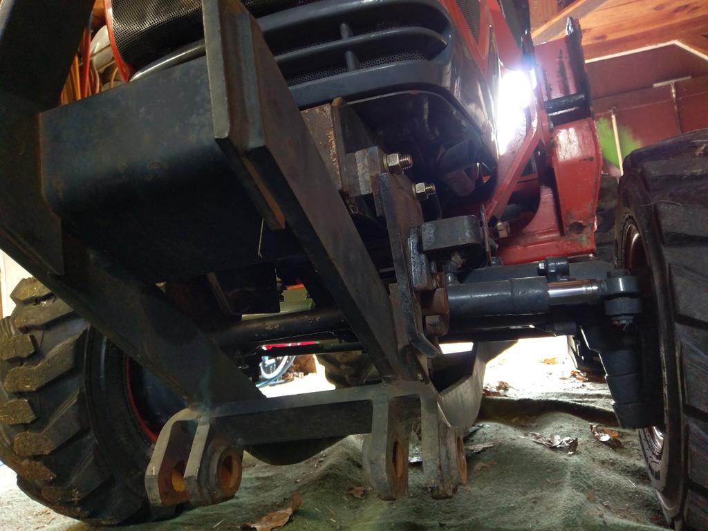

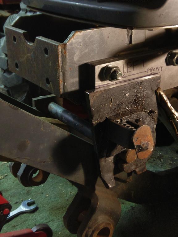

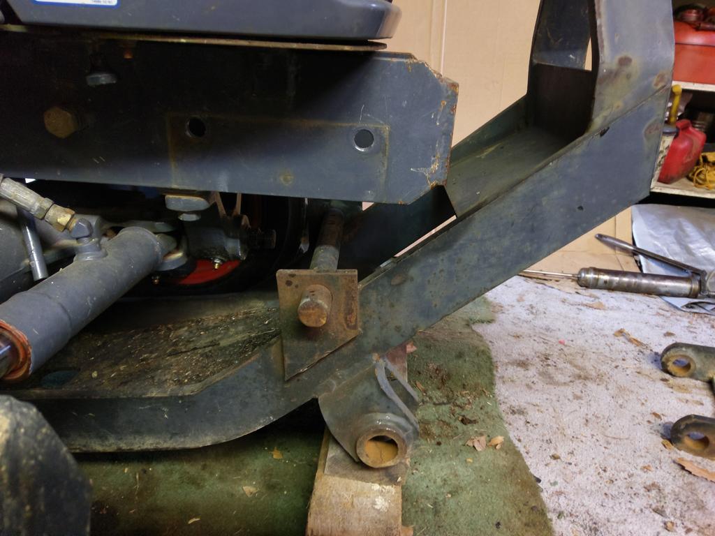

WVHillbilly520H 10,377 #9 Posted December 18, 2017 Just got back from WV getting a little closer to having this blade mounted and working, JD did use heavy materials for this frame and blade, made the rear brackets first so I could mock in place and figure out what to do for the front, had all 3 cylinders rebuilt, cleaned all the pivot and cylinder pins of rust, measured for hoses to order from surplus center and a few adapters JD did some weird sizing 1/4" hoses with 1/4" on the cylinder ends but 3/8" on the cushion valve and quick disconnects here's a few pics so far, Jeff. 2 Share this post Link to post Share on other sites

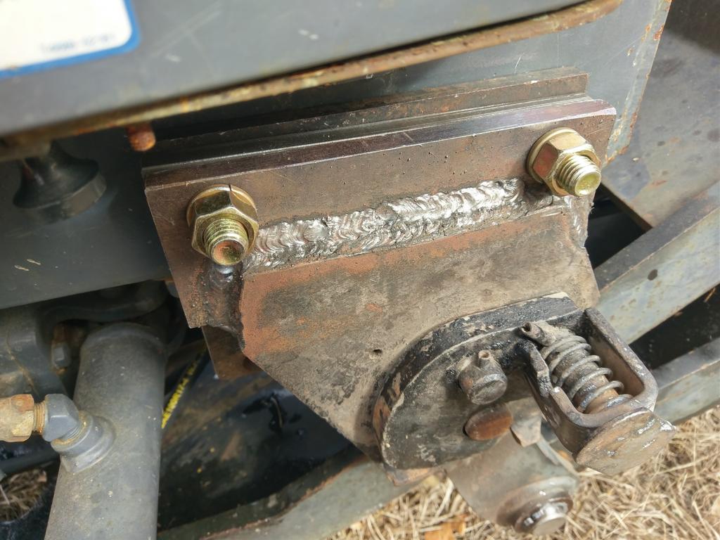

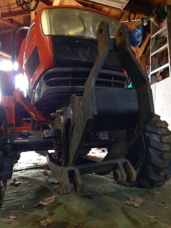

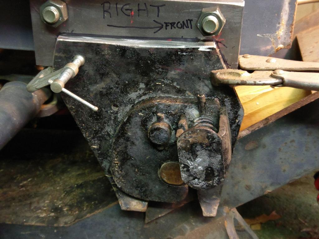

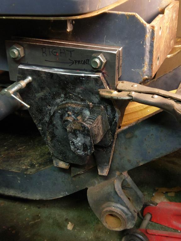

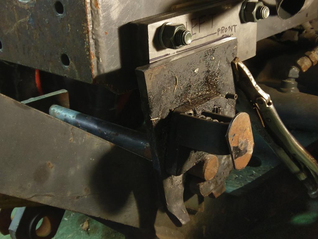

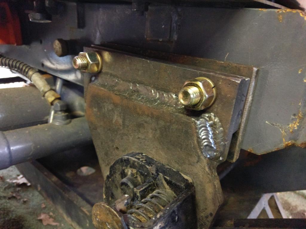

WVHillbilly520H 10,377 #10 Posted December 22, 2017 Making more progress with the rear mounts figured out I got the fronts fabbed out, the biggest slow down is the fact the tractor is in WV without many of needed cut off, drilling and welding tools needed and having to bring it all back to VA to do the necessary big drilling/cutting/welding, the frame is 5/8" thick with 1/2" reinforcing and the moldboard is 3/8" thick, anyways once I get the front mounts welded up and bolted on its getting the hoses and fittings and hopefully I'll get some pictures/videos of it in action, Jeff. 4 Share this post Link to post Share on other sites
WVHillbilly520H 10,377 #11 Posted December 25, 2017 I got the front brackets welded together yesterday ,the hoses and extra fittings ordered, once they show up I'll get it mounted up and hopefully working with pics and videos to follow, Jeff. 2 Share this post Link to post Share on other sites

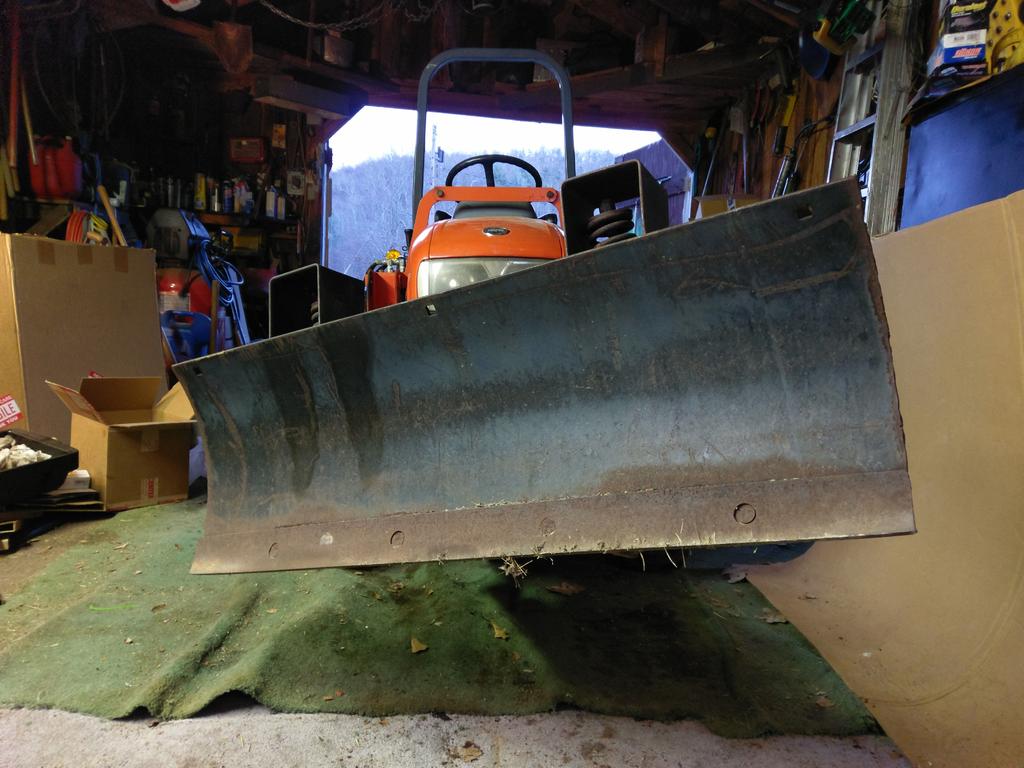

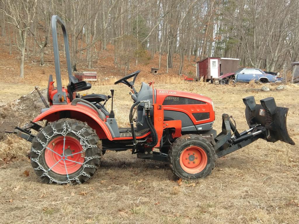

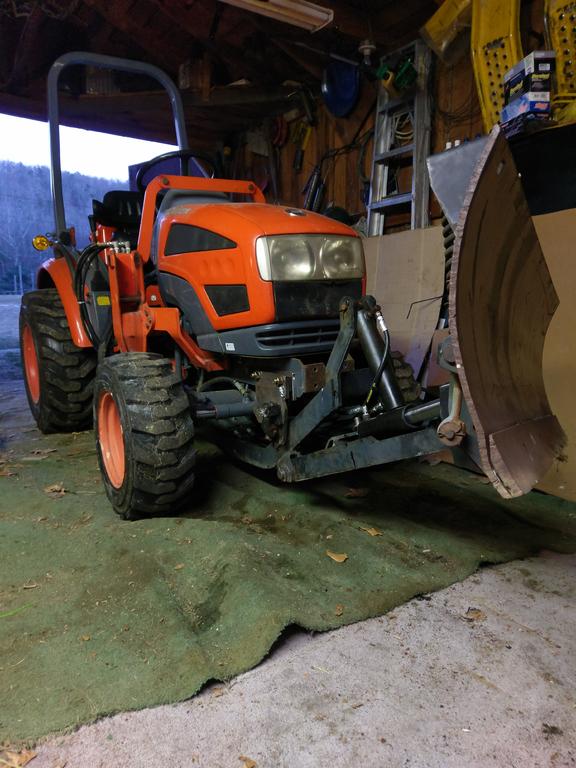

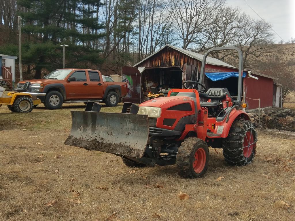

WVHillbilly520H 10,377 #12 Posted January 14, 2018 After nearly 70° yesterday, today in WV was hovering between 15-20° as I removed the FEL and actually got the 4 way hydraulic blade installed,plumbed and mostly working (up/down works great as well as angle left but angle right is slow to not at all, might be the cushion block/valve between the single acting cylinders, as ALL cylinders were rebuilt by a reputable shop), so here's the finished product till I get that last little snag taken care of, pics and a couple videos, Jeff. VIDEO0061.mp4 VIDEO0062.mp4 4 3 Share this post Link to post Share on other sites
Sparky-(Admin) 24,095 #13 Posted January 15, 2018 Very impressive! Picks the front end right up! I really like how high the blade lifts. I sometimes wish my WH blade would lift a bit higher but of course I'm limited by the front axle. 1 Share this post Link to post Share on other sites
WVHillbilly520H 10,377 #14 Posted January 15, 2018 1 hour ago, Sparky said: Very impressive! Picks the front end right up! I really like how high the blade lifts. I sometimes wish my WH blade would lift a bit higher but of course I'm limited by the front axle. Thank you sir, I was raised on cub Cadet and the way they mounted the blade is similar to this where they pivoted under the grill shell and would lift 8"+ compared to our design which attaches rather quickly/easy and actually gives a traction boost by applying the load to the rear axle, now that I have conquered this I'm thinking of a way to do one similar on a WH, sub frame mounted to mid and front attach-a-matics they plumb into the hydro with separate control valves think old JD 3/400 series ect, Jeff. Share this post Link to post Share on other sites

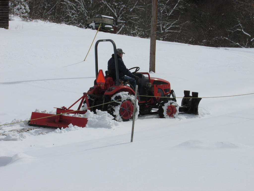

WVHillbilly520H 10,377 #15 Posted January 28, 2018 More updates and pictures, made it to WV today to figure out why the blade wouldn't angle one direction my first thought was maybe one of the rebuilt was cylinders hanging up second thought the "cushion valve" was bad so first thing today I pulled the hoses and cushion valve and replaced with hard piping and tried it out, this time it worked flawlessly so yep the cushion block/valve wasn't letting fluid to the left cylinder, going to try to get the hydraulic shop to test and hopefully repair as JD wants nearly $600 for a replacement no rebuild parts, or go with a different unit from Surplus Center , @pullstart here's the latest all mounted up used the full frame and fabbed a couple brackets, Jeff. VIDEO0063.mp4 1 3 Share this post Link to post Share on other sites

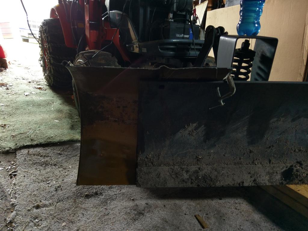

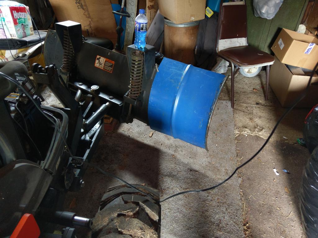

WVHillbilly520H 10,377 #16 Posted February 24, 2018 I took the aluminum cushion valve to another another hydraulic shop to see what was wrong with it and if it could be repaired and it was a simple fix thank goodness, so as soon as I get some more swivels it will be going back on, the blade is wider than the tractor straight but at full angle I believe snow will fall back into/under the tires so I'm making some "cheap" extension wings just for snow duty, I cut down a 55 gallon steel drum today and trial fit till I get some flat bar or angle iron for bracing, once I get everything done and it warm up for good I'll pull it all off and paint it all dark gray matching the tractor frame color, Jeff. 2 1 Share this post Link to post Share on other sites

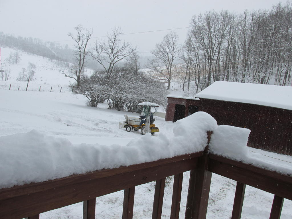

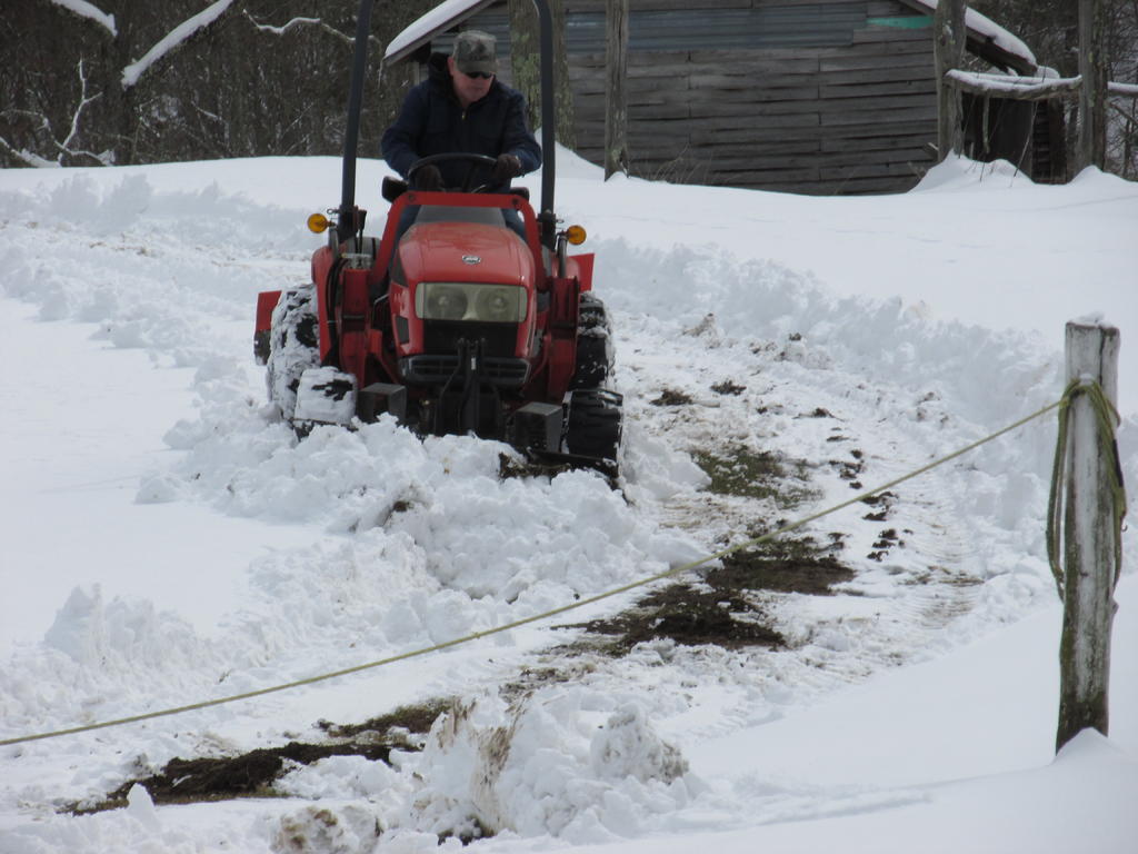

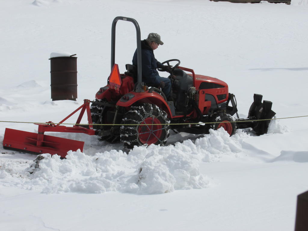

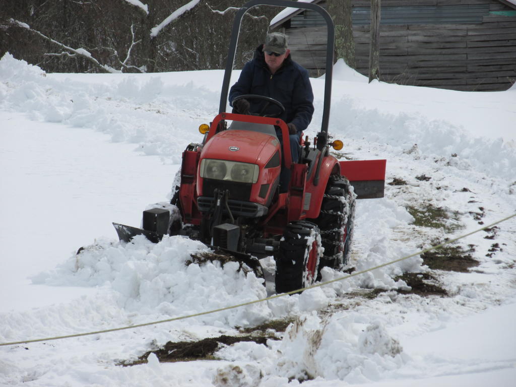

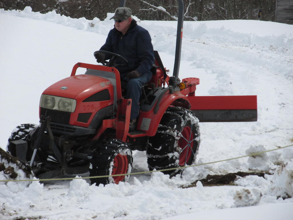

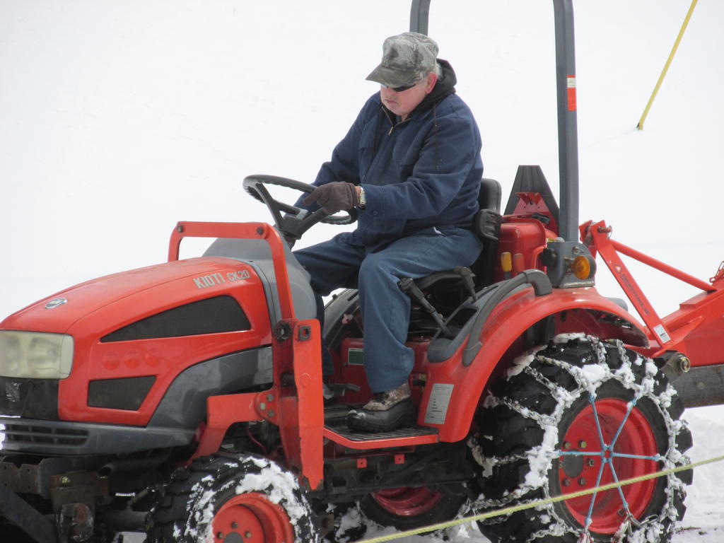

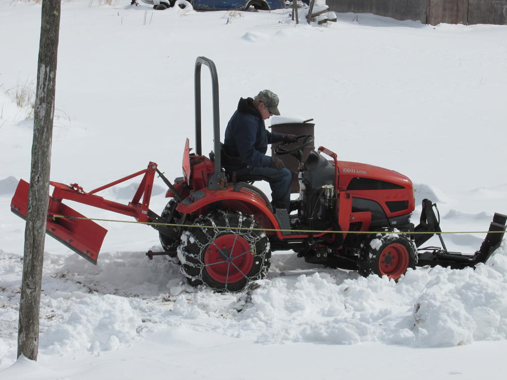

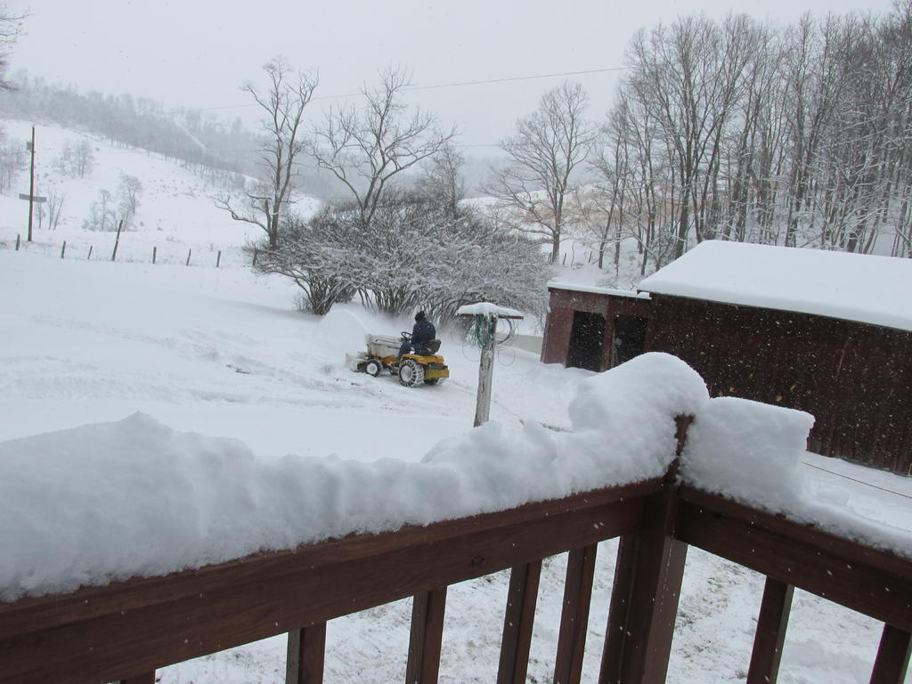

WVHillbilly520H 10,377 #17 Posted March 30, 2018 i have an update on the front blade, of course the snow storm last Wednesday mom said about a foot of wet heavy snow there so while i was on the phone with her i asked if she would take a few pics/vids of dad moving snow on Thursday with the Kioti, so today i had to take him for an eye appointment and i got them downloaded to the laptop, he also had the 1450 Cub Cadet out with the single stage Wednesday of the snowfall, not to bad for an 80 year old man huh?... enjoy Jeff. MVI_0512.MOV 1 1 1 Share this post Link to post Share on other sites
