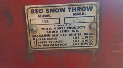

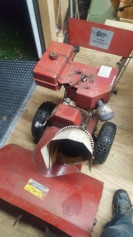

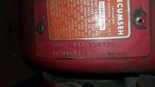

nate77 1 #1 Posted November 22, 2016 I picked this up the other day this is the id tag on the blower tag on engine Trying to figure out year?, when I search the model number of the engine ,I get results for a bunch of H60s but not that specific one, I did find a manual for 626st and 626ste online ,which helped get the linkages adjusted correctly, just need to find some belts and a scrapper blade ,it does have the opening for the electric start if I happen upon one.Going to check local lawn and garden for a blade see if there is something i can make work nate 1 Share this post Link to post Share on other sites

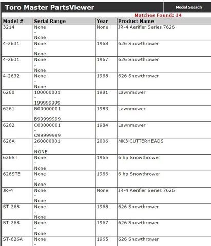

CasualObserver 3,417 #2 Posted November 22, 2016 65-68.... specific serial numbers were not recorded. Here's the snip from Toro MPV Share this post Link to post Share on other sites
953 nut 69,842 #4 Posted November 22, 2016 Here is a manual for one like it. Share this post Link to post Share on other sites
