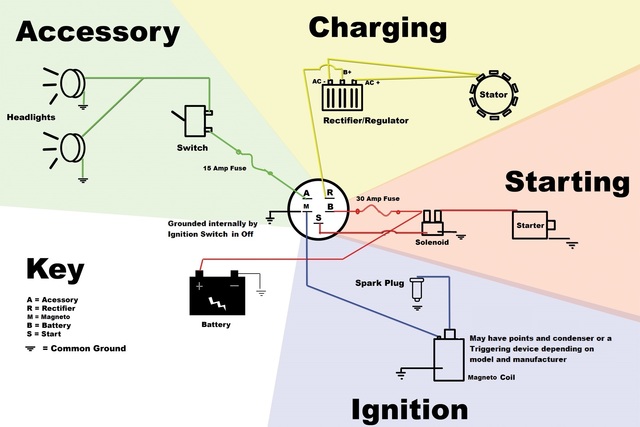

953 nut 67,249 #5 Posted November 22, 2016 These two diagrams will show the differences, first is Magneto, second is battery ignition. (not for any specific tractor) 2 Share this post Link to post Share on other sites
